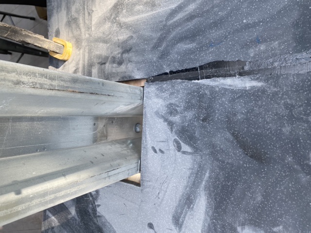

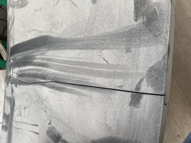

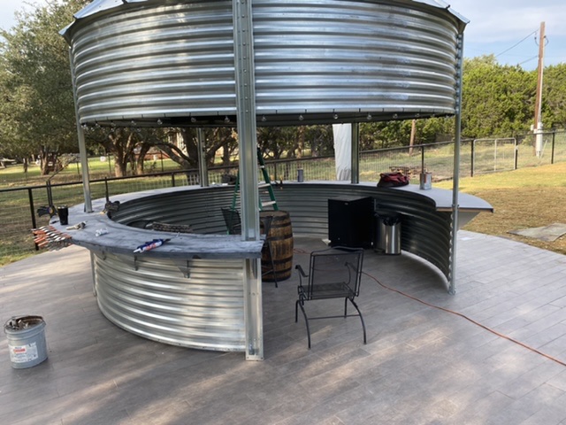

Hello everyone, this is an outdoor, direct sunlight Corian application. The circle is 18’ in diameter. I have two seams that separated, and one crack where there wasn’t a seam. Most of this was bonded in place when it was near 100 degrees outside. One separated when we were working and it went from sun to shade. This top is glued down with silicone, which we thought would be a flexible enough glue to allow movement. Any advice or knowledge of successful outdoor applications would be much appreciated.

WOW. The mere weight of that monolithic top even if it were just sitting there with no silicone I would imagine would have split just as bad. I'd imagine that arc of dark SS would move a mile and FAST from blistering sun to shade or god forbid a passing shower on a blistering hot day.
I would guess a save-it solution would be to either incorporate some same color, or contrasting color/material accents, maybe like a keystone, in the top in several places to break the top into 3-4 sections that can float. Perhaps a slight overlay setup where the keystones look like intention serving stations or something. Could be out of the same material, could be contrasting color, could be redwood, IPE, anything that allows the dark to float a bit under the keystone.
I cant imagine that top as one single piece ever surviving in that application.

Is the top restricted by the posts anwhere?

Thank you for the response. I like the floating and independent slab idea. So it seams like only group one colors (white, or very light) are really used outside. There was plenty of clearance around the posts.

first question: Are you a certified corian fabricator? If so you know that can not make seams at the corner of a cutout. Also are there radius corners in the cutout and what size are they? Radius corners distribute the stress the cutout receives when the slab expands and contracts. Also is there a solid sub top under this slab? We know that solid subtops are not recommended for top installation. I hope your customer does have any issues with this top because if he does, that 10 year warranty is not going to be honored by Dupont. Please go back to your fabrication manually (the one you got when you were certified by Corian) and reread it, it looks like you forgot a lot about solid surfacing. A lot of people have worked fabricating solid surface, but have never gone through actual certification process. IF your name is not on that list then you are not a "certified fabricator" and only jobs that are fabricated and installed by a certified fabricator are eligible to receive the manufacturer's warranty. I would suggest that you check your fabrication manual, adhere strickly to it, and e-mail corain with any questions that you have so you will have a paper trail to back you with any problems.
I personally see nothing but issues with this top in the future and would have let that be know from the start. I do believe that that tops needs two or three expansion / contraction joints in order to allow for movement in that top.

Expansion joints would be simply a 1/8" gap then caulked with black silicon to allow for expansion of the tops without applying stress to the top next to it. i would put an expansion joint at every upright which would actually make 4 independent tops with an 1/8 " gap between each one. It would also get rid of the stress at the cut out as well. I would have explained the need for this to the customer and let him decide how he wanted to proceded. We have done some long buffet tops with the same issues with hot and cold food trays and have used expansion joints in them.

Hey Doug, thank you for the response. I have read the fabrication manual, but that was quite a while ago. I don’t remember reading about expansion joints, or anything about outdoor installation, but I’ll look again. I am not a certified installer, but work with Corian full time fabricating sinks, counter tops, and window sills. We do comercial restaurant work where there is no guarantee other than our general one year guarantee. We don’t really have training other than on the job training. I don’t think a radius in the cut outs would have helped as none of the breaks were at the corners. Two breaks were at the seam and one was in the center of a panal. What a waste of 5 sheets. I offered the expansion joint solution, but the GC has decided to rip out and put tile. Thank you all for the advice.

Just took the Corian Certification class a few weeks ago. Far from an expert, but think if you call their tech support, they'll advise you need way more than 1/8" of expansion seam between the tops. They suggested even window sills be cut 1/4" short, then split the difference and silicon. Seems like this top would have more temperature differences than that, and it's larger.

Semantics at this point as its been posted the top is being torn out but I cant honestly see any reasonable expansion joints working in a top that shape/size/color and location. The shape of that thing will lend itself to some kooky expansion with that open section, sun hitting it from different angles throughout the day. Square inside corners at the posts aside, it'd be a doozy.

All the joints should be backed up by a seaming plate underneath due to the cantilever and the application of a heavy client dropping their body weight on that thing, stressing the weakest spot and finding the weak spot to crack it
The edges should have been double stacked inside and out.
Build it like a tank Commercial applications can be brutal on acrylic
