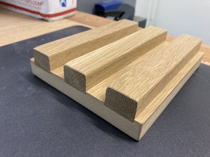

I'm being asked to reproduce this panel material to a different spec than this sample. The sample is 1" x 3/4" solid white oak spaced 5/8 and glued in 1/8" grooves in a 3/4 MDF panel with white oak veneers.
The customer wants 1" x 7/8" solid, spaced 1/4", same 1/8" groove. They are also concerned about the MDF substrate because it will be installed in a bathroom, and want a different material. Makes sense to me. Will have a clear poly finish.
My question: what type of panel core would be a good choice if not MDF? I'm concerned that with so much material removed from the top of the panel, the replaced with solid, it will become unstable and start to bow/warp/taco?
In the bathroom, most of the panels are 2' - 3' wide. There is also a master bedroom that would use full 4x8 panels, but less of a moisture issue.
I've read here in other Woodweb forums about an "MDX" type panel that uses more waterproof binders, but haven't seen it for sale from any of my my local supplies.

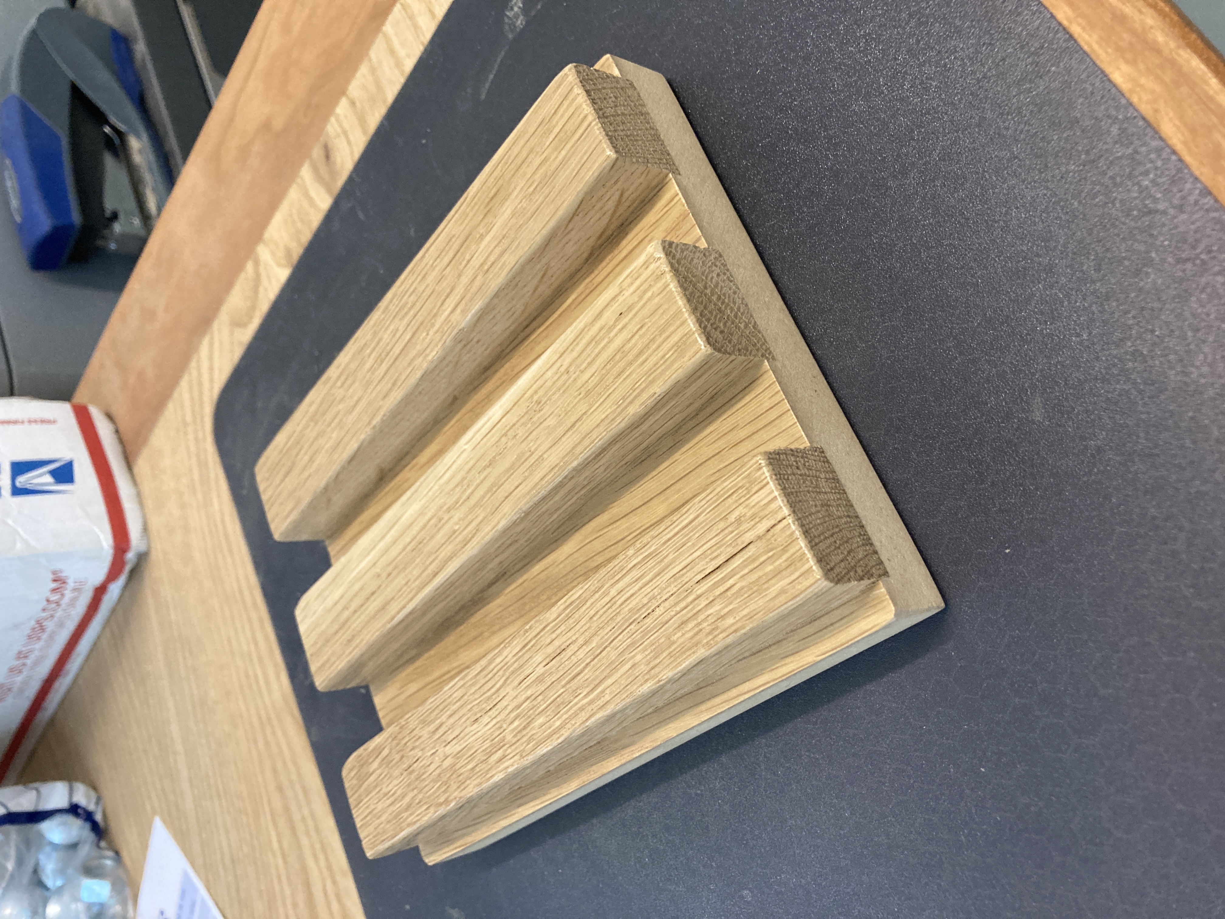

I can see the advantage in screwing, but that's a lot of assembly for 350 sq ft when I could just put them in my press. Just noticed my photo above appears squished and distorted... here's another I think it will show the actual dimensions. Will there really be that much expansion in a 1" wide piece?
View higher quality, full size image (720 X 540)

I was also basing my statement off the skewed photo and not the 1" 7/8" description. Glueing them up in the groove should be no problem.
