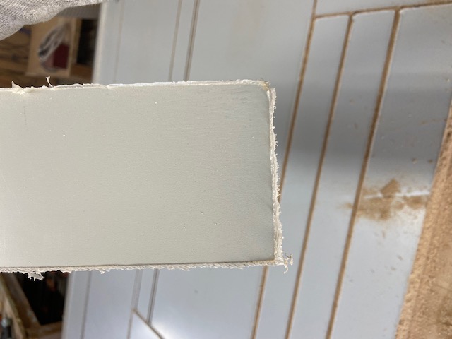

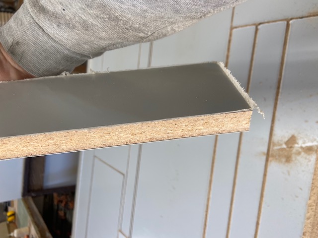

I am using this product for a Hangar galley. The surface is some sort of non finger printing technology, and comes with a clear protective layer. I have never worked with this product and I am worried about removing the protective film too early. My question Is would it be ok to run the parts through my edge bander while leaving this film on? See attached pics

I just recently completed a job using that velvet texture from wilsonart. We peeled the protective film away from the edges far enough that none of the operations in the edgebander would contact the film. When we left the film on one of two things happened, either the film got caught in the scrapers, and buffin wheels, or the film was just enough to cause our edgebanding to have a small lip, requiring us to file down all the edges.

Im with tyler. We ran this on a few jobs. Its so expensive it makes you scared but its pretty bulletproof. Unless your running miles of it and its worth adjusting your machine to trim deeper to leave the film off id just strip the film.
