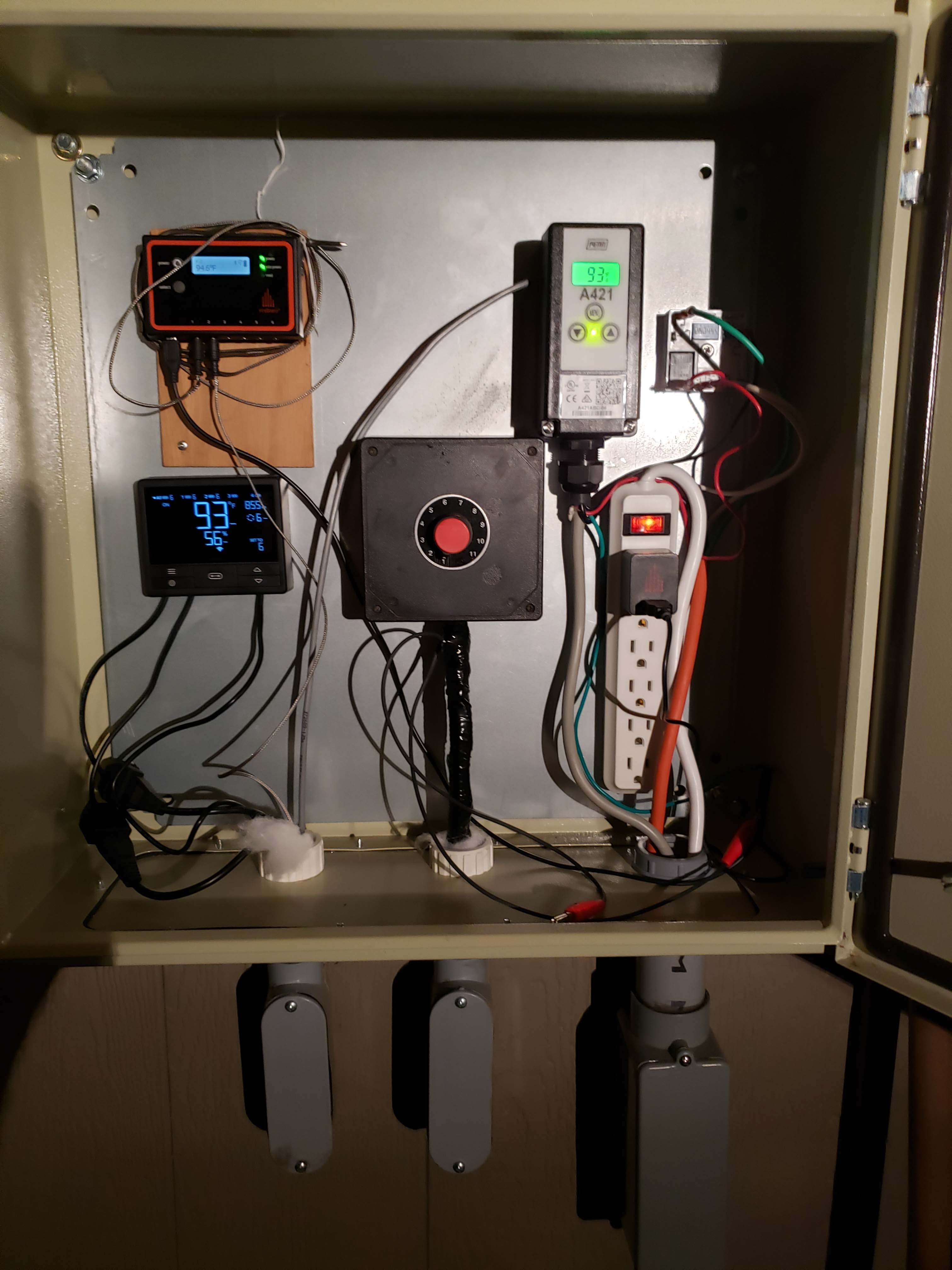

George Member
Johnson controls makes temp controllers. I got mine for $65. For temp monitoring and recording/graphing i use Fireboard bbq thermometer with 6 temp probes. Gen 1 is not listed, but is $83 or so. I use AC circulate fans that can be controlled by either temp or humidity. One fan is for power vent. Challenge is getting a dehumidifier thst can withstand the acidic environment of oak.
4/25/22       #5: Looking for small kiln controller ...
George Member
That would be "AC Infinity" controller 67 or 69. Newest will have wifi. Put all controllers in external westher proof kiln control cabinrt (or KCC as my wife calls it).
I use Lignomat moisture meter with a self made 10 probe selector panel. Again. All in KCC, but bannana plug probe panel in kiln. One of the probe sets goes to the EMC sensor.
Real slick system.

Tim Heming  Member
George could you send some pictures of your system? I am in the process of building a small kiln also.

George Member
Hey Tim,
I have been real busy with a big job. Also redesigned the kiln setup. Do you still want pictures? if so, what do you want the pics of?

George Member
In case someone is interested in controllers. AC Infinity controller is WiFi, so can monitor and control from phone (Fans, Humidity (dehumidifier or steam generator), and power vent fan. Can set buffers to have a cut on setting and cutout setting.
The PTC heater is on the Johnson controller, so physically have to visit the KCC to adjust that. The heater could be on the AC Infinity controller too, but I like the reliability of the industrial Johnson control for that critical part.

Austin Member
I’ll be honest George that looks super freakin cool. Is your setup mounted to a reefer, shipping container, or commercial style kiln? I just purchased a business that deals with a lot of wood and would like to get into drying it myself instead of outsourcing 10% of my profit to a bigger competitor. Plus I could probably make enough coin to pay for the increase in electricity by renting out space to others that need stuff dried.
