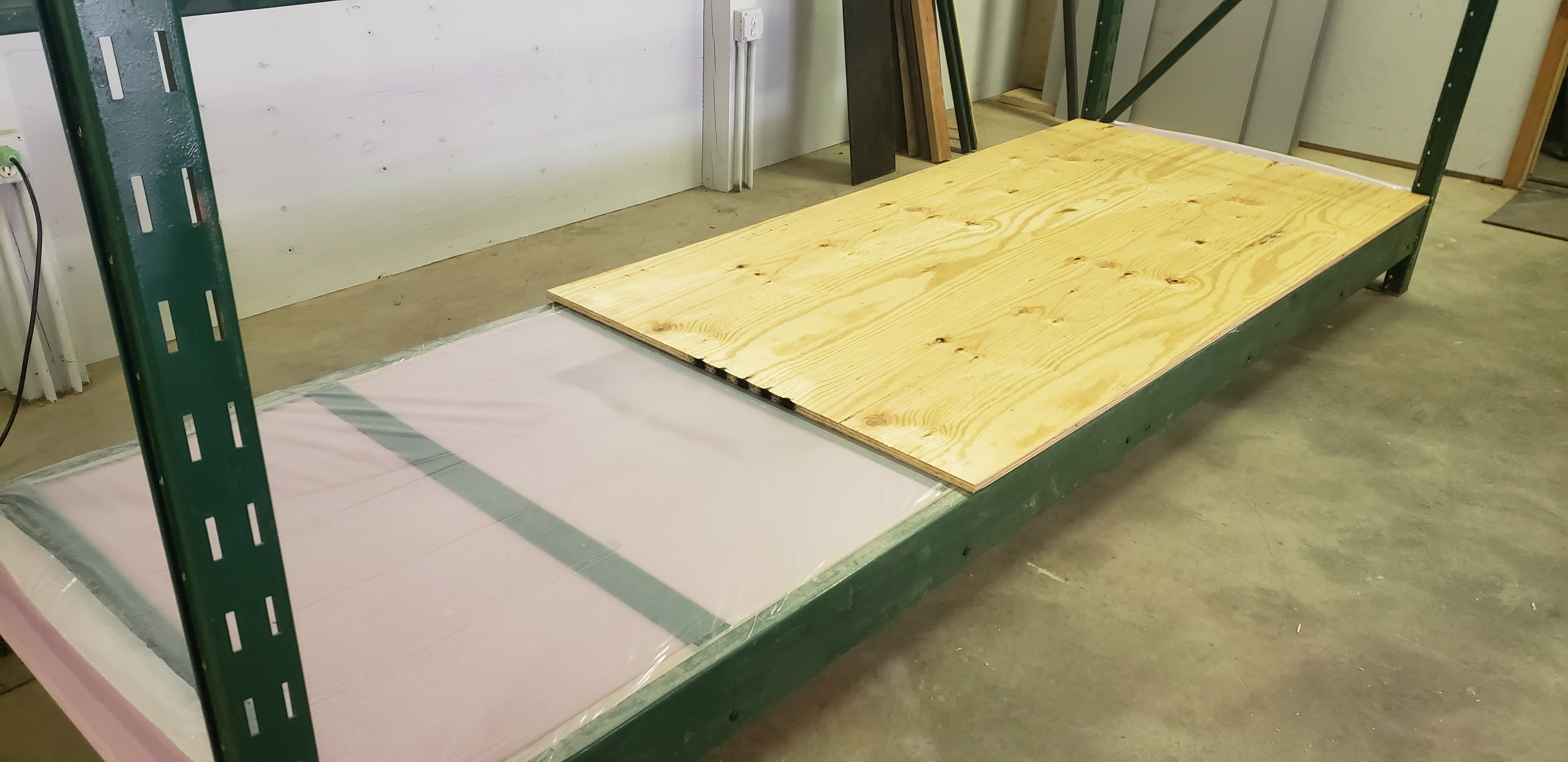

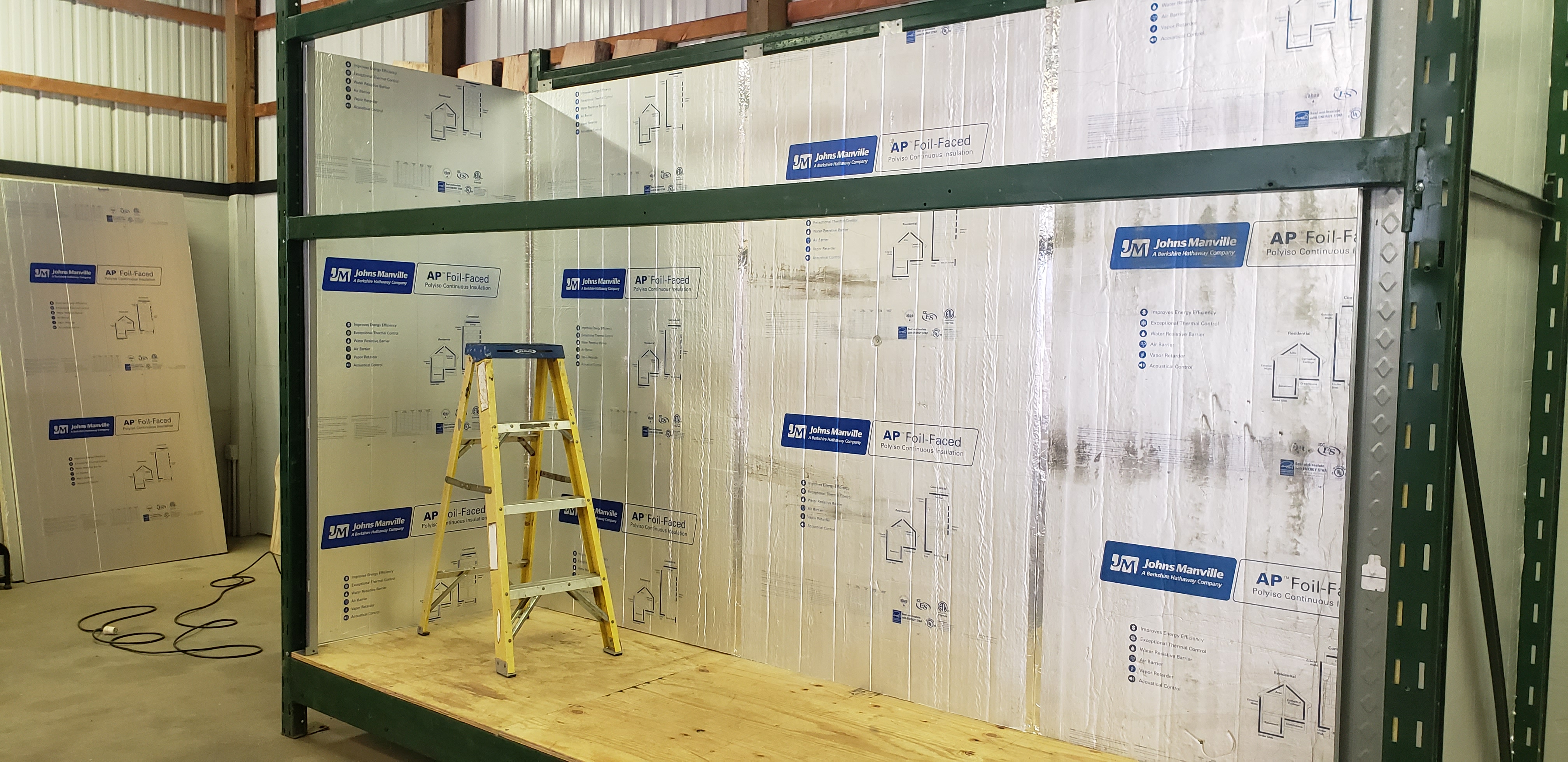

This question is for either Professor Wengardt or others that have expert advice regarding building a kiln enclosure to finalize moisture content to 8 percent MC and to sterilize the wood for insects. I started building this kiln using an old steel pallet rack because it is rated to handle weight and will be easy to move if needed. I have read information from the Drying Eastern Hardwood Lumber, the U.S. Forestry dry kiln build and also studied the Nyle's plans on dry kiln enclosure. I have a few questions concerning insulation, type of fans and CFM required, and what type of heat source and dehumidifier would be needed to bring down the moisture content.

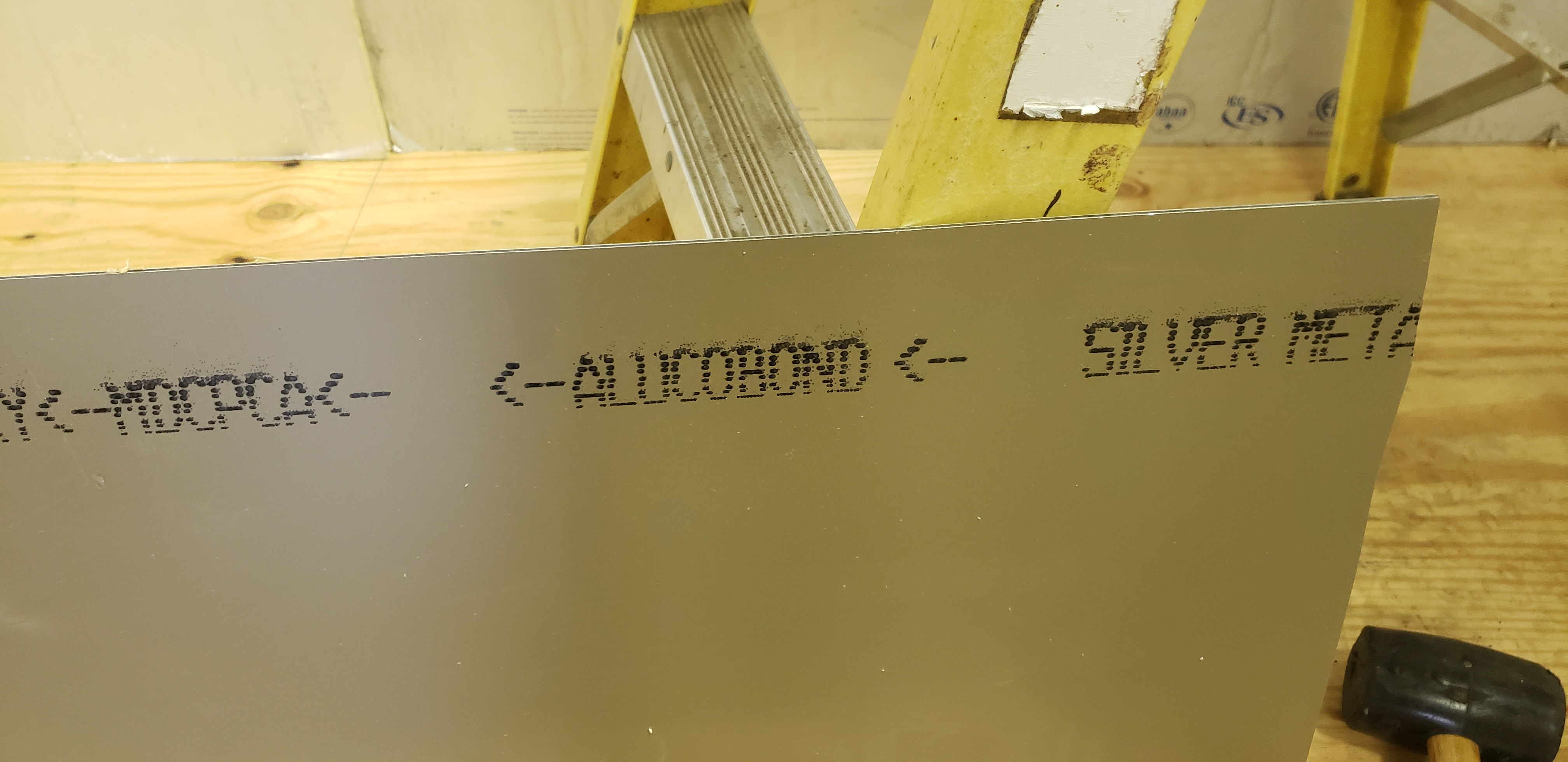

First on insulation, the inside floor has 2 layers of 2" Dow XPS foamboard at R-20, 6 mil vapor barrier, 3/4 plywood. Walls are Johns Manville brand 1 1/2" Polyiso foil faced foam board which is rated at R-9.3 and the ceiling will consist of the 2 layers of the same foam board as walls but 2" and rated at R-26. Should I cover this foamboard with 6 mil visqueen before I apply the 4 mm Alucabond brand aluminum clad sheeting? Also I wanted to add more insulation to the walls on the back side to increase the R value by using either R-13 fiberglass batt which is cheap, or continue to use a thinner foam board to get the R value up past R-13? I know Professor Wengardt has mentioned about moisture getting past the surface and possibly getting into the insulation, so should I stay away from using fiberglass batt or open cell styrofoam even if I use a vapor barrier on the inside?

I finally decided to purchase the Nyle L53 kiln unit and will be taking delivery on this in a few days. I have basically followed the design plans of the Nyle kiln chambers construction plans.
