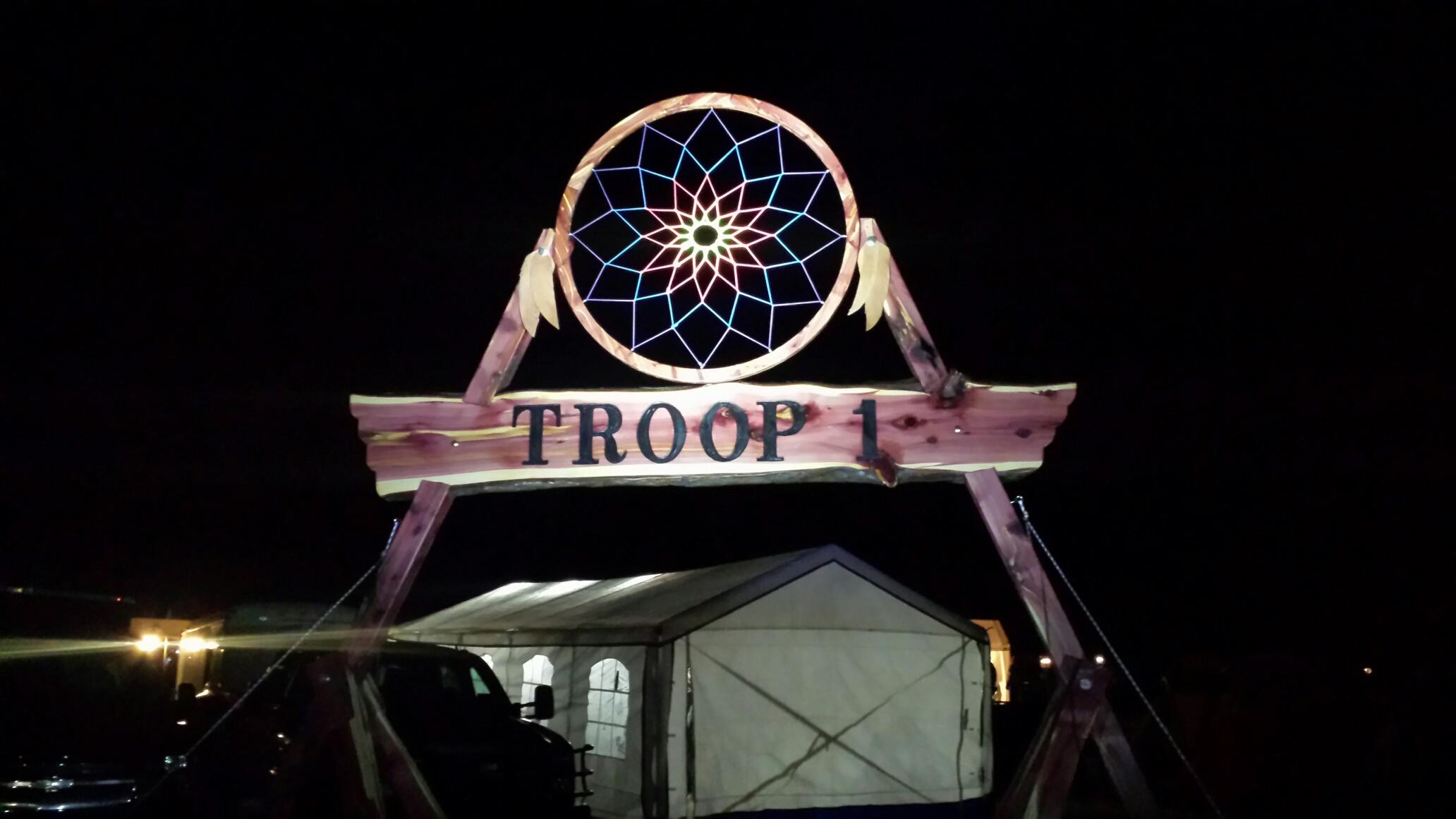

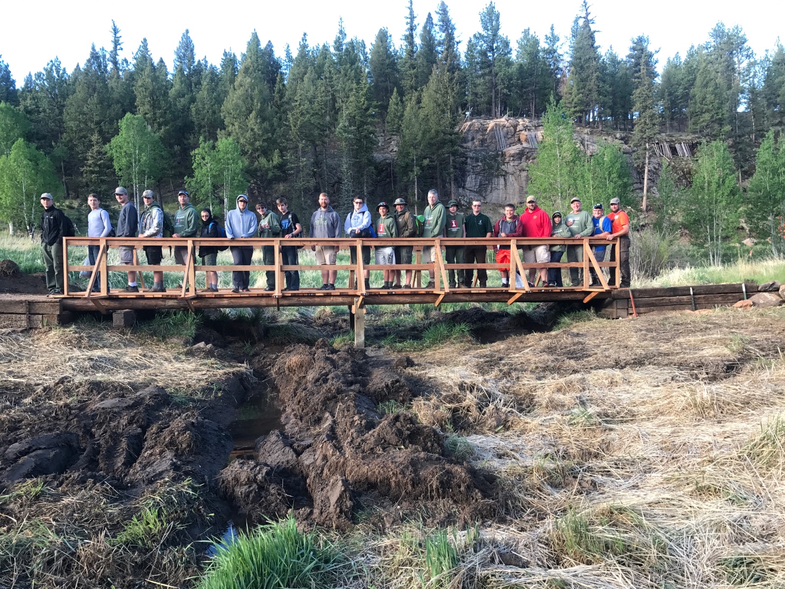

Tim, I had some time to review your website. I like your style.The view from your cabin is great. Here are some of our boy scout service projects. 36 foot bridge to rifle and archery at Camp Alexander, Co. A 14 foot tall dream catcher gateway for our troop. just celebrated 100 years and over 660 eagle scouts.
