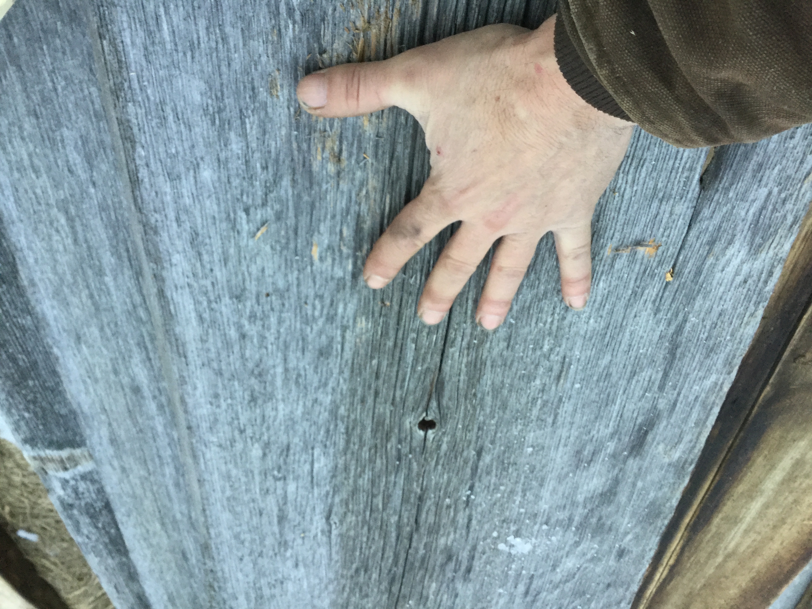

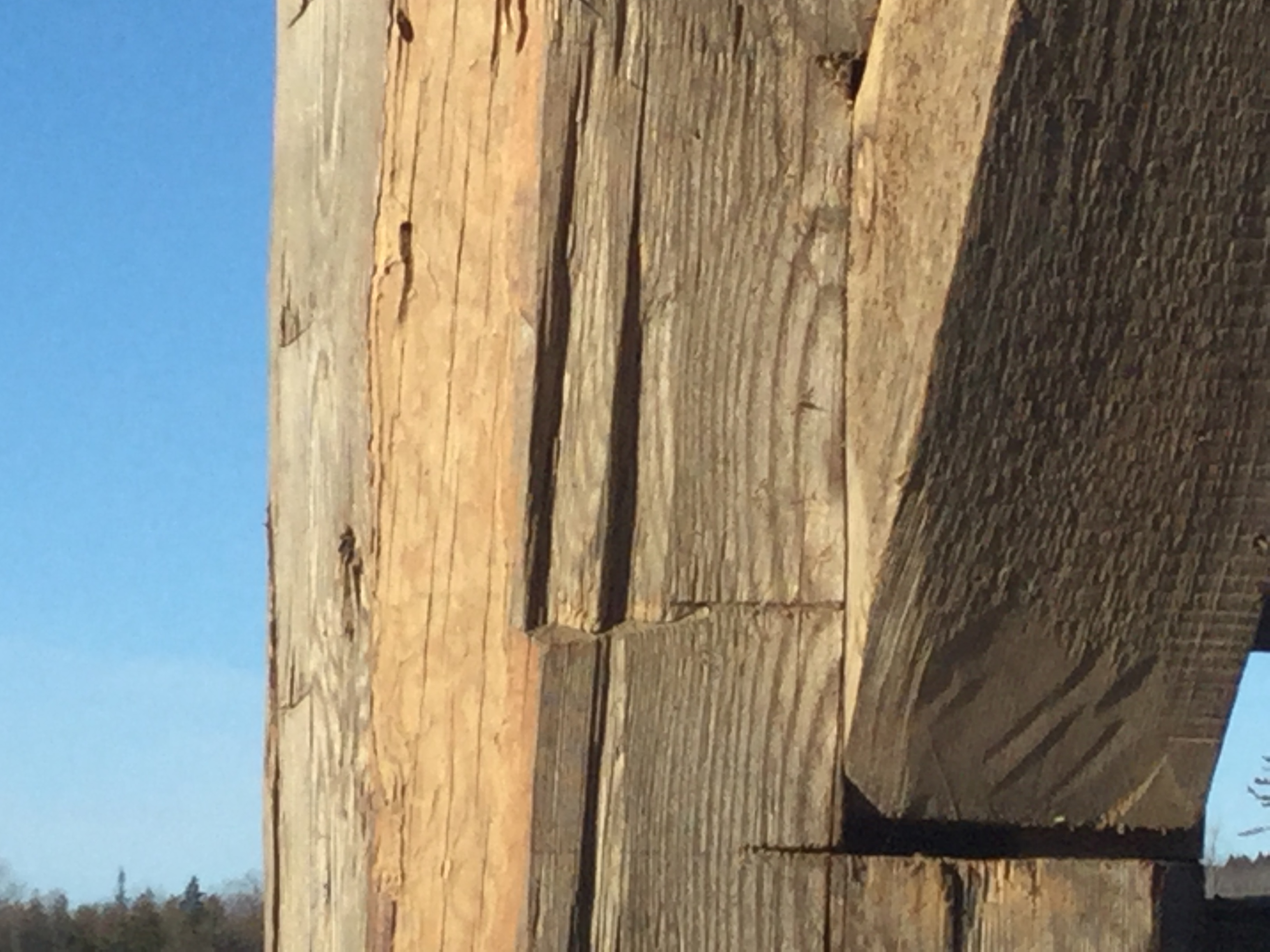

trying to i.d.wood from 1860 barn northern maine.hemlock or chestnut,to heavy for pine spruce,to light for oak.

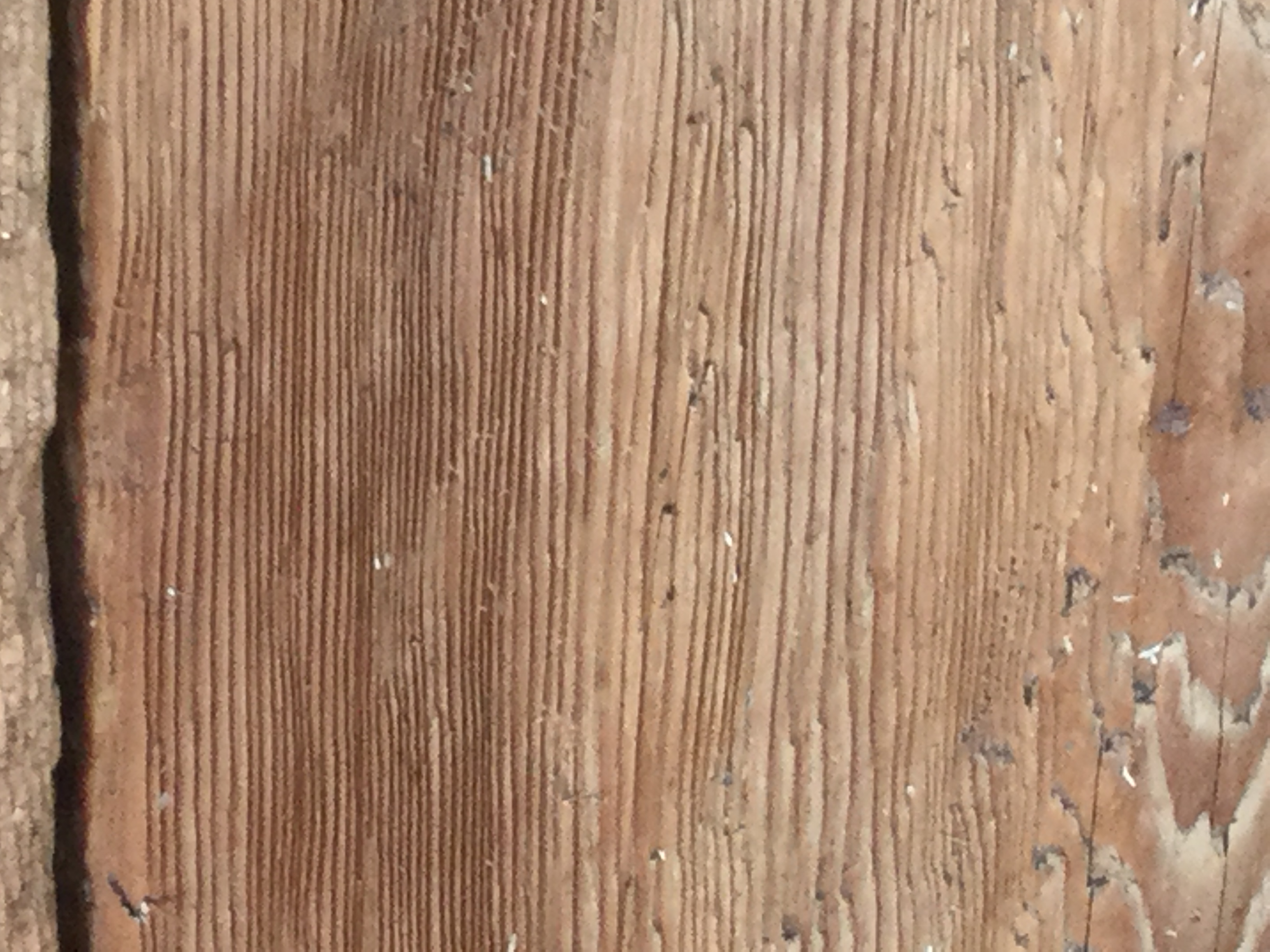

george Member
another pic

Keith Newton
Well, none of the images you posted would be Chestnut, which is ring porous.
Since it is a hard soft ring, it would be one of the softwoods. I would think your nose might help you separate those, and I would think Pine is heavier than Spruce.

GeneWengert-WoodDoc
Because you say "heavy" I suspect you have tamarack, also called American larch and norther larch. The color, transition from spring to summer is gradual, and it is durable.

GeneWengert-WoodDoc
Barn wood is almost always a locally available wood. Eastern white pine was wide, lighter in weight and widely available in the East. Where are you?
