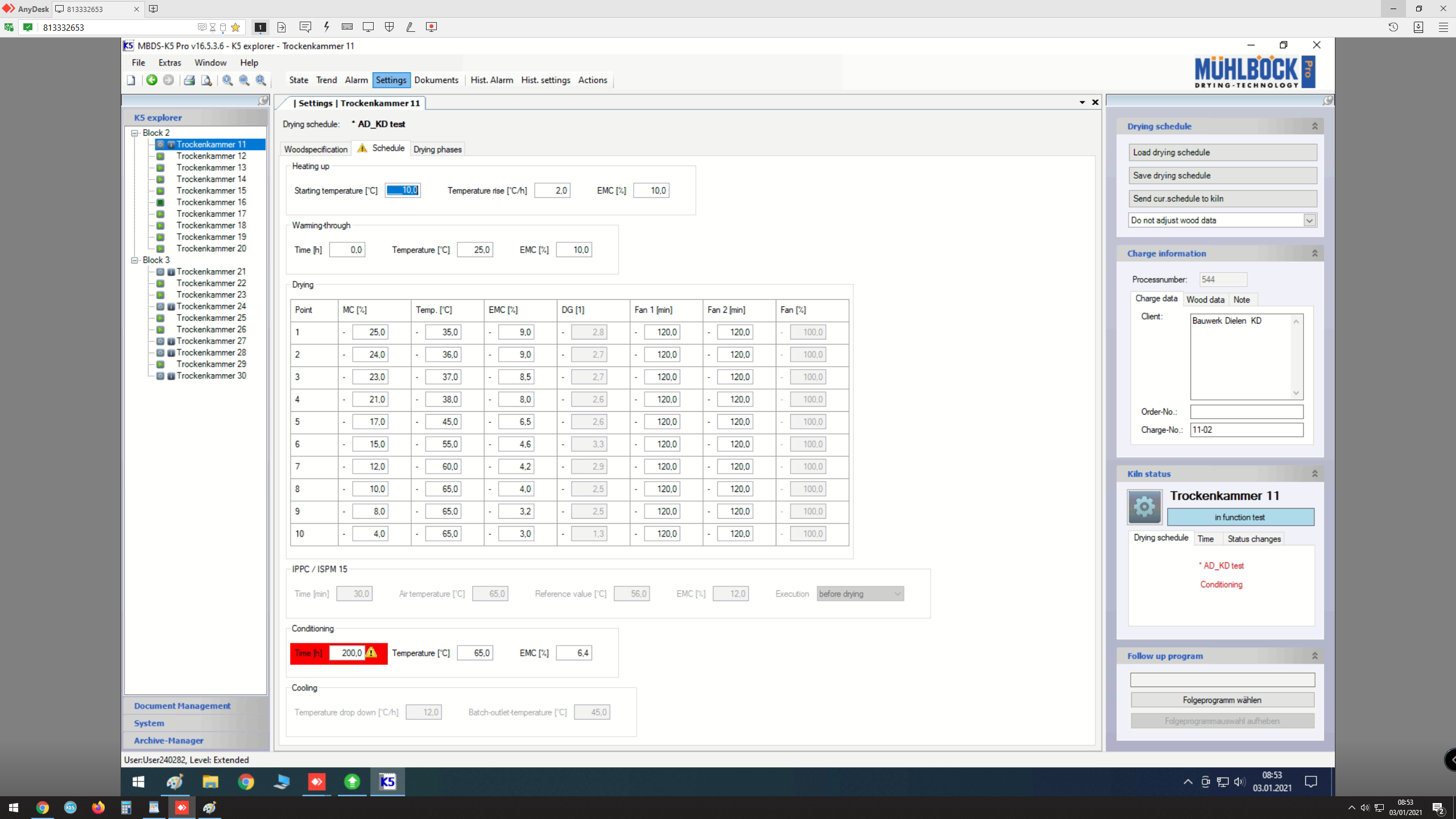

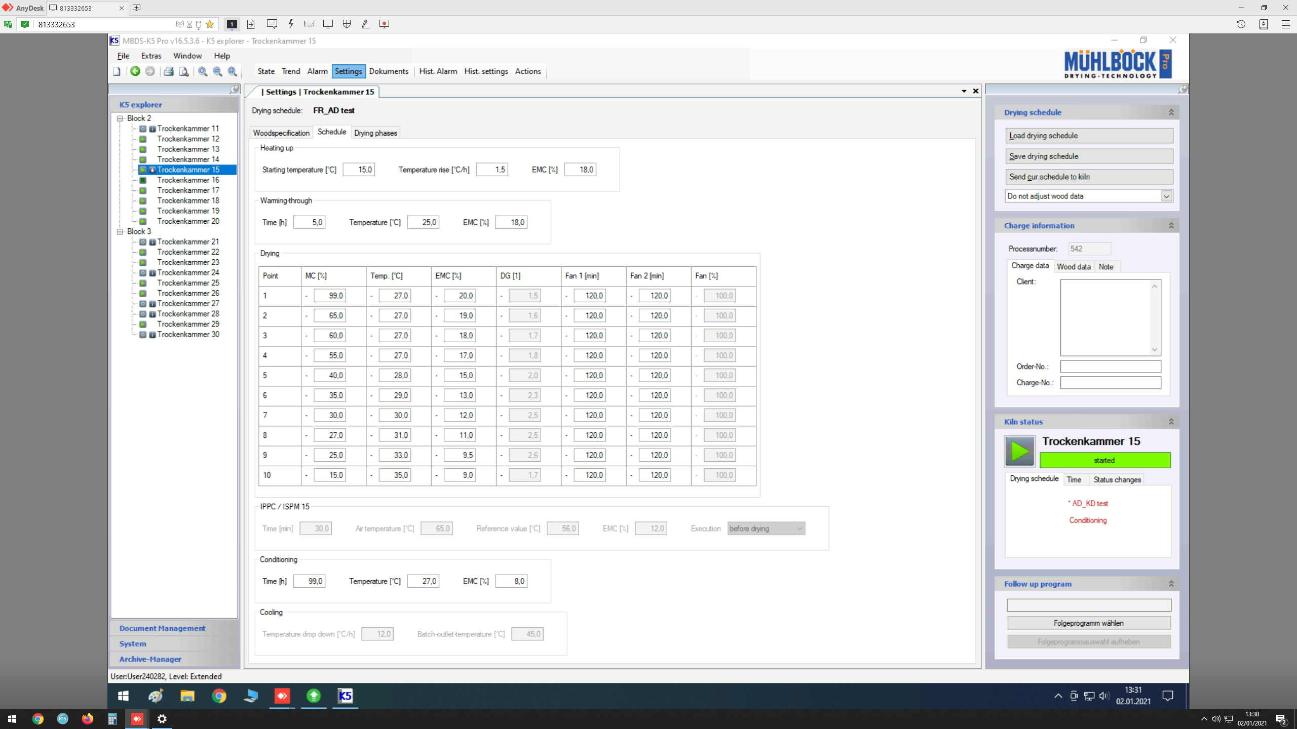

Mario Čižmešija Member
Here are current drying schedules i work with.

In last post i accidentally uploaded 2 same pictures and gave only FR_AD schedule. Here is the AD_KD now. Note that this is just formal schedule & it is changed according to conditions in kiln / material / etc.

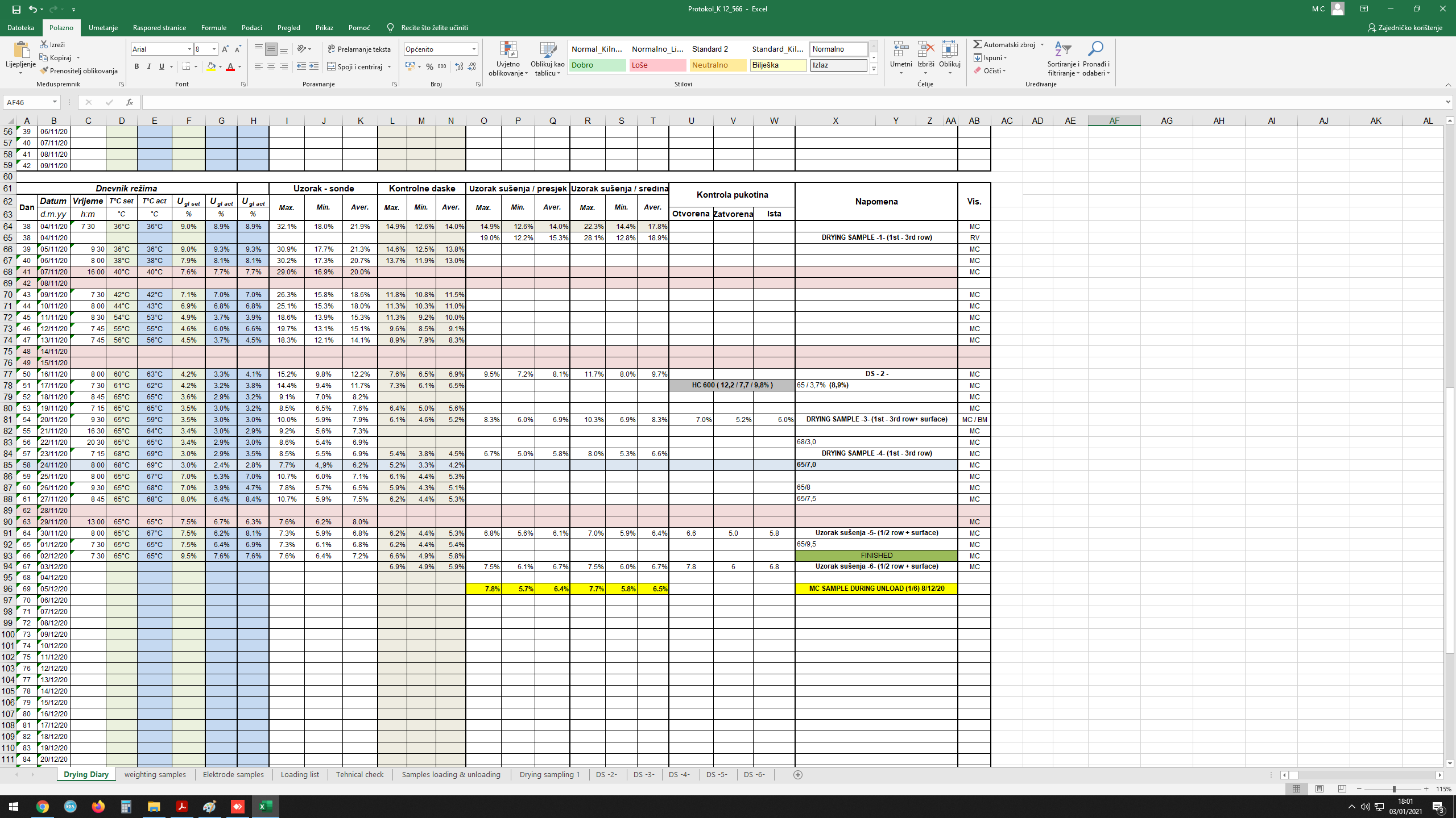

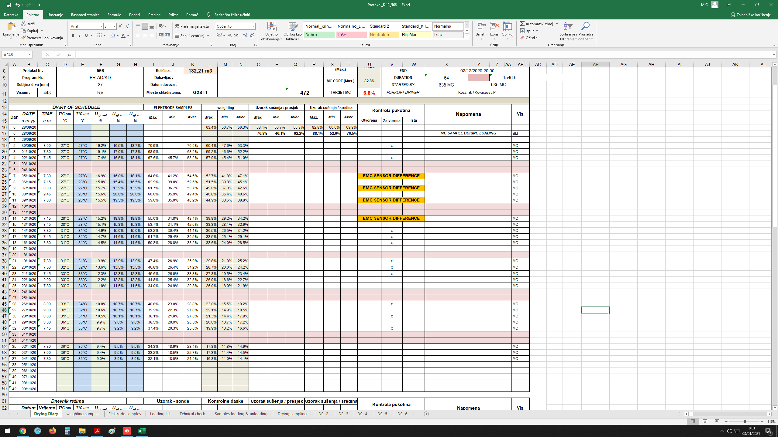

- MEASURING MC DURING DRY.PROCESS - maybe just to create "whole picture" .
We are using 5 samples for constant daily measuring (weighting) and 10 samples connected to cables. During drying process we unload material near the center of stack and make additional MC checks with oven drying method. I forgot to mention that kilns do not have "back door entrance" so only way to check the center of stack is by unloading and randomly picked samples (flat:quarter sawn = 40:60). These samples are marked and checked multiple times during drying. They are taken from "center" of package. Forklift lifts part of the material and board is cut from the end (40 cm at least). Then the inner part of the board is cut for core sample and cross cut sample. They are dried for 24h at 103°C in oven. All standard process. I'm attaching one of my drying protocols. It is mostly in Croatian but i don't think You will have problem understanding measurements. Vital information is translated to English so if You have time & and are willing , maybe take a look...
