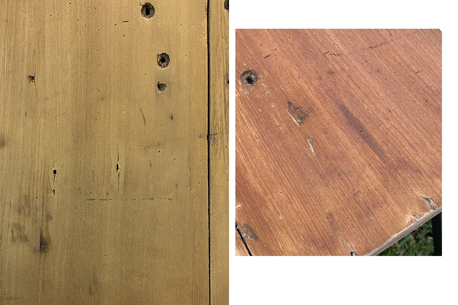

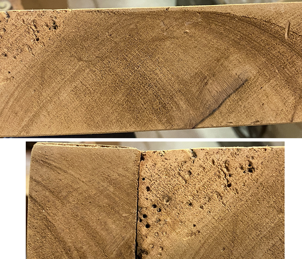

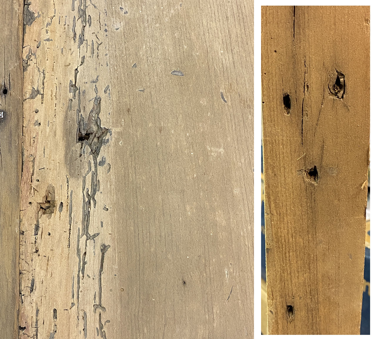

have been trying to ID this wood with no success. I wanted to guess chestnut but am not sure. Is from an old mantle that is supposedly over 150 years old according to the family I am restoring it for. Had some old square nails used in it's assembly but no characteristic staining of the wood around the metal if chestnut. Sands easily, is lightweight for it's size. Pale yellowish/tan color unless finished then it goes really dark. also has a lot of insect damage on one side that extends to mantle edge. Endgrain shot is included but may not be helpful. Any help is appreciated greatly, thank you.

Basswood or poplar.

Chestnut looks just like oak, except no medullary rays. I don't see that. BUT WHATEVER YOU DO, FUMIGATE OR BAKE THAT THING! It's full of powder post beetle holes and could infest your shop and also infest the home it's going back into.

thanks for the responses. All the insect holes are dark, which seems to indicate that no longer any activity. ? Could I surface treat with some chemical to be sure beetles (if active) would be killed? Family will probably not want to pay for a professional to treat the mantle, not sure it is worth that to them.

You can never assume the powder post beetle infestation is over. The holes are exit holes. There can always be larvae and eggs still in the wood. Surface treatment is only good as a preventive. Complete fumigation or heat treatment where the center of the wood reaches 133 Deg F is the only way to kill the larvae and eggs.

David, it does sort of look like chestnut. Where is it located? if NE, then probably, but chestnut is pretty resilient to bugs.
you can spray or dip in a borate solution. Should kill anything within the surface but I am not an exterminator.
