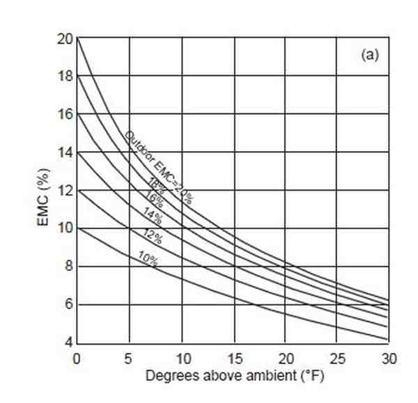

Is there a typical target for the temperature
differential between inside kiln temp and
outside ambient temp? I seem to recall you
mentioning a differential of 20 degrees ...
maybe as the minimal differential that will
keep the drying process going at an appropriate
rate?
If I'm interpreting your response correctly,
the idea is to adjust the vent openings so
the air temp in the kiln doesn't drop too low.
I suppose in an ideal setup, outside air would
be introduced to the kiln, the vents closed,
and the air circulated until the RH goes way up,
and then the vent opened to exhaust the high RH
air, and pull in new/drier air, vents closed,
and so on.
View higher quality, full size image (600 X 579)
5/29/18       #4: Solar kiln - questions regarding fi ...
Gene Wengert-WoodDoc
Your idea about vent operation is how many non-solar kilns operate. Adjusting the vents to a small fixed opening is how to avoid sophisticated controls.
The kiln fans can be turned on when the kiln has roughly heated up 20 F above the morning low temperature, not current temperature. This will occur at about the same time every day for a month span or so. This means we can use a timer to turn on fans
