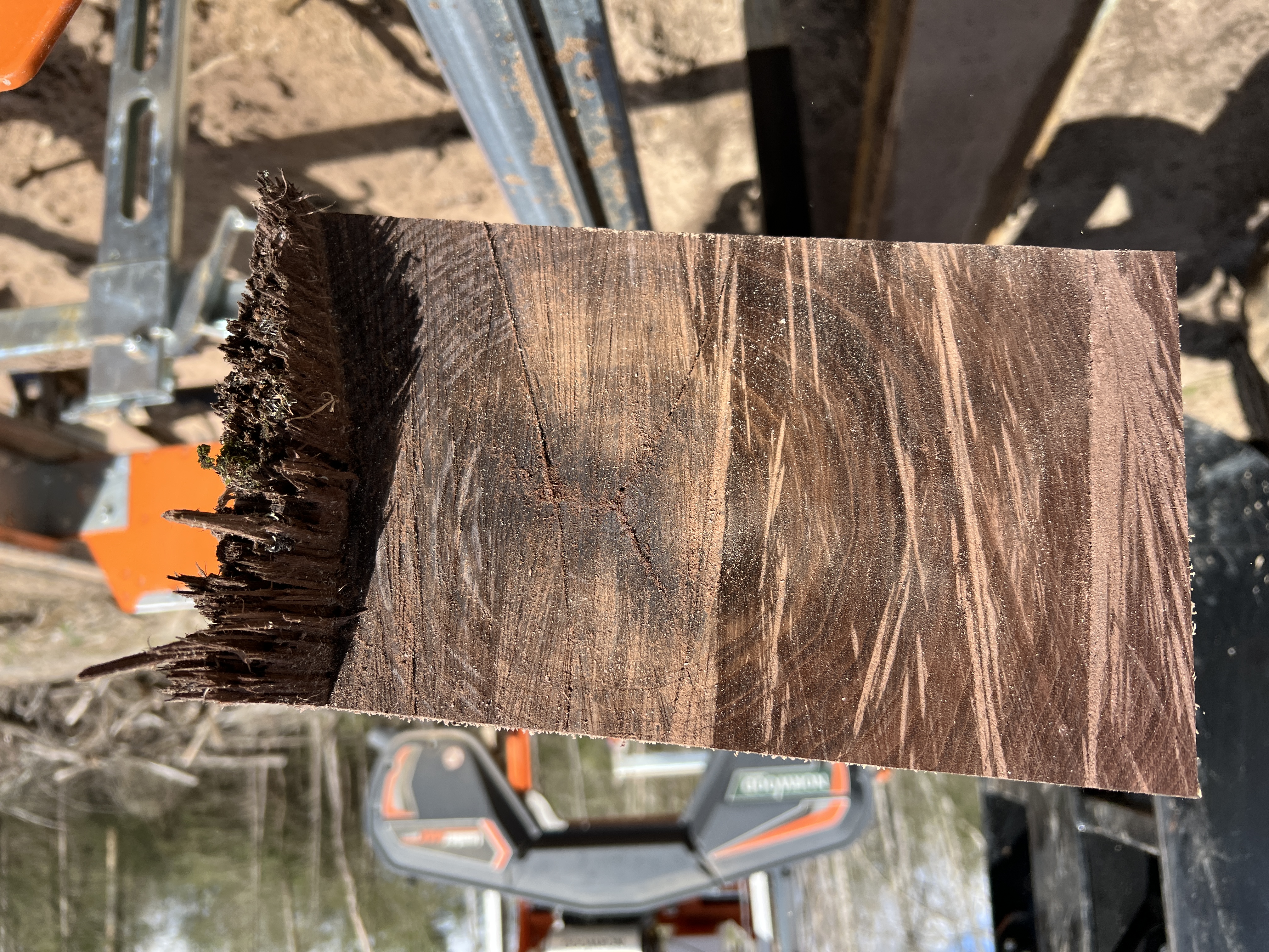

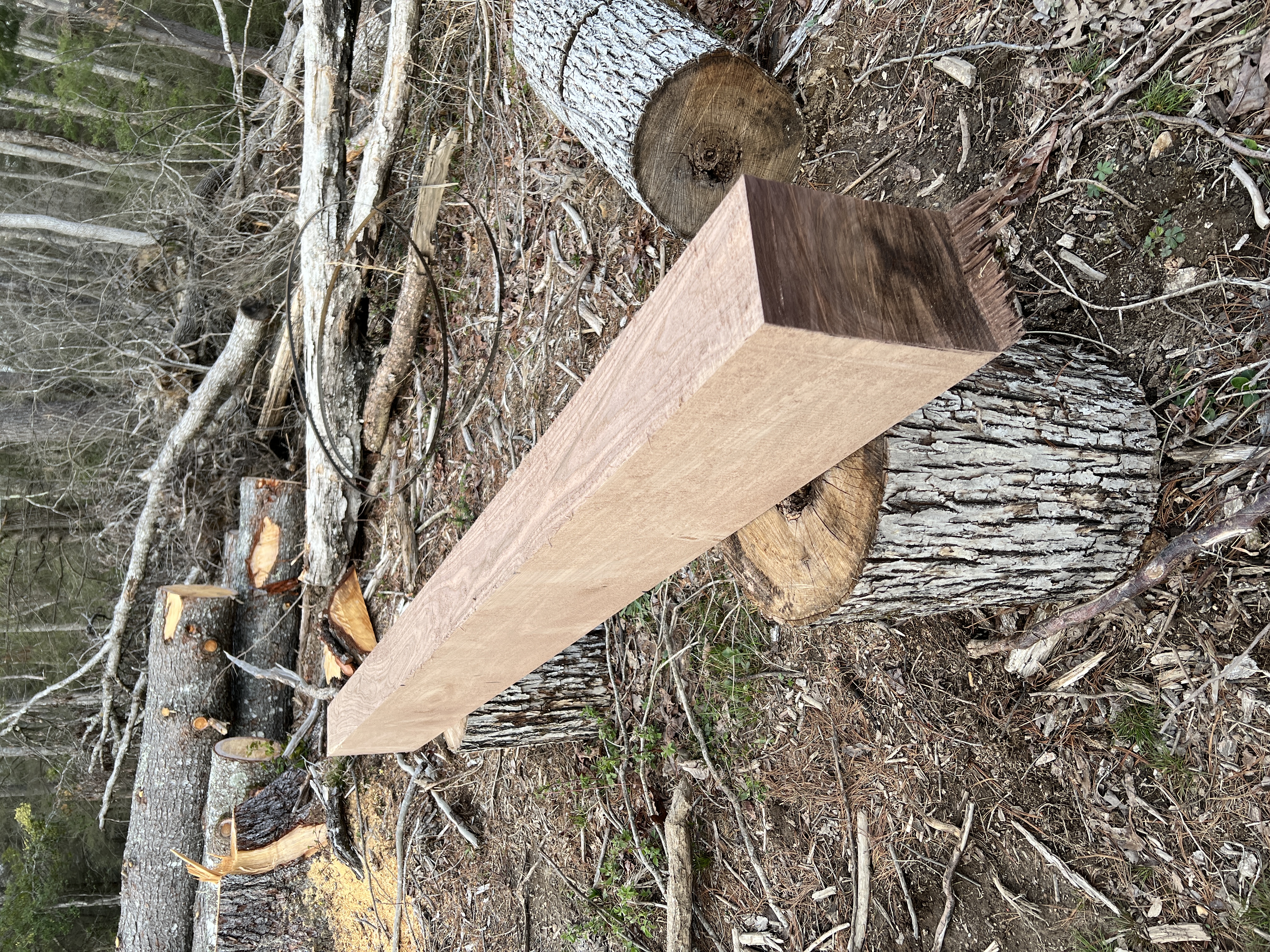

lumberjacktim Member
more pics….

MarkB
Nice cant.
I owned a portable band mill and had a small kiln for approximately 20 years. 115 acres of property and sawing for others. Everything from felling to skidding in with 4wd tractor/loader, sawing, stickering, drying, and building custom cabinetry, moulding packages, etc.. Prior to that experience around large circle mills both single and twin blade sawing a lot of large/wide pine and so on.
What Rich is saying is relatively true. Your guy may be talking air drying for a short time to lose some surface moisture then into the kiln til the outer shell measures 6-8% but to take a 6" thick cant to 6-8% through the entire cant is a pretty lengthy process with an conventional kiln. The vacuum kilns are another story and I have no experience with them other than what Ive read and seen on YouTube but the speed and degrade is greatly reduced and thicker material is more manageable.
As you likely already know, that check in the end will likely wind up being a big check along with others. No biggie if the customer is fine with it. Its a mantle after all. Your only issue if its not completely dry is future movement and some would say bugs but Walnut is a lesser bug prone wood anyway.
Heck, timberframes are fab'd and put up basically green for ages. Lots of shrinkage, homeowners live in a house that sounds like cannon fire as they dry out, but it works.
Good luck, looks good from here, keep us posted.

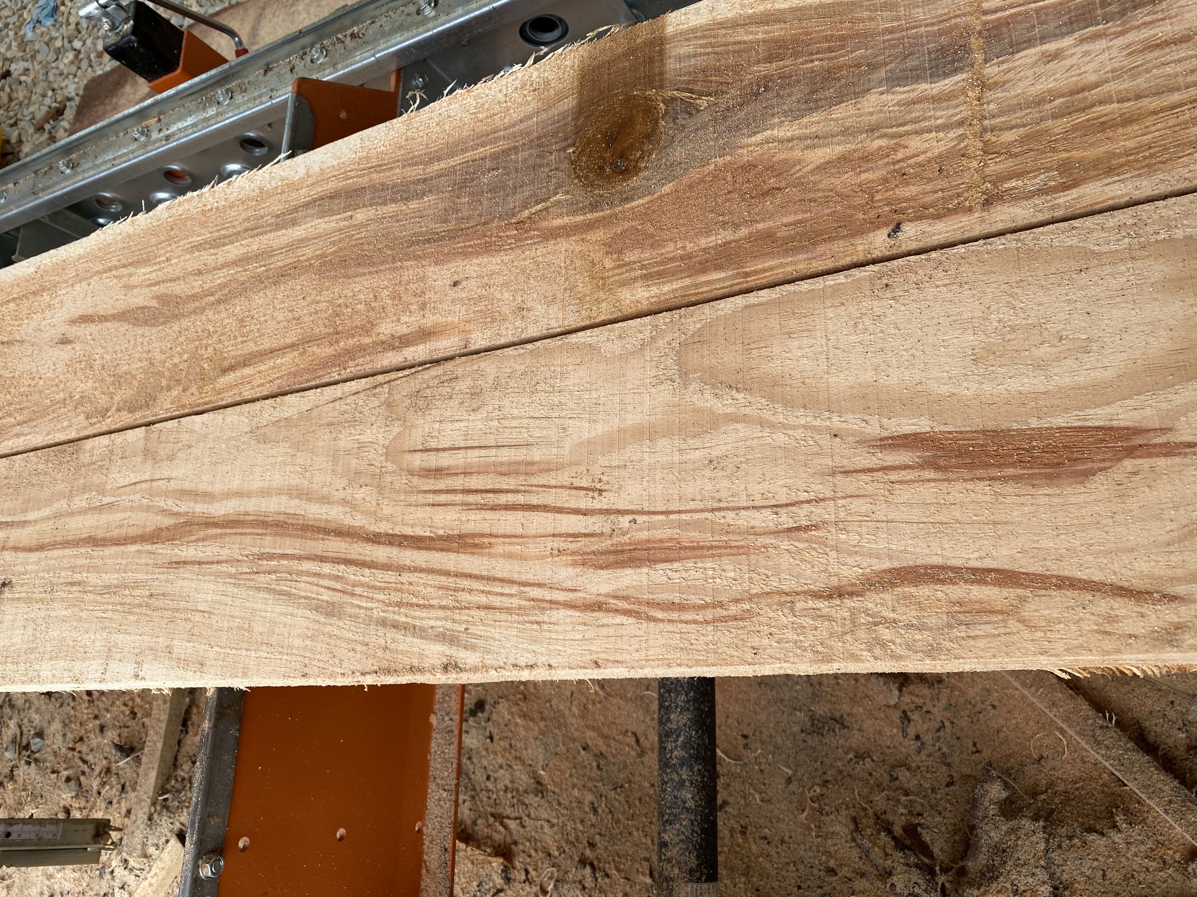

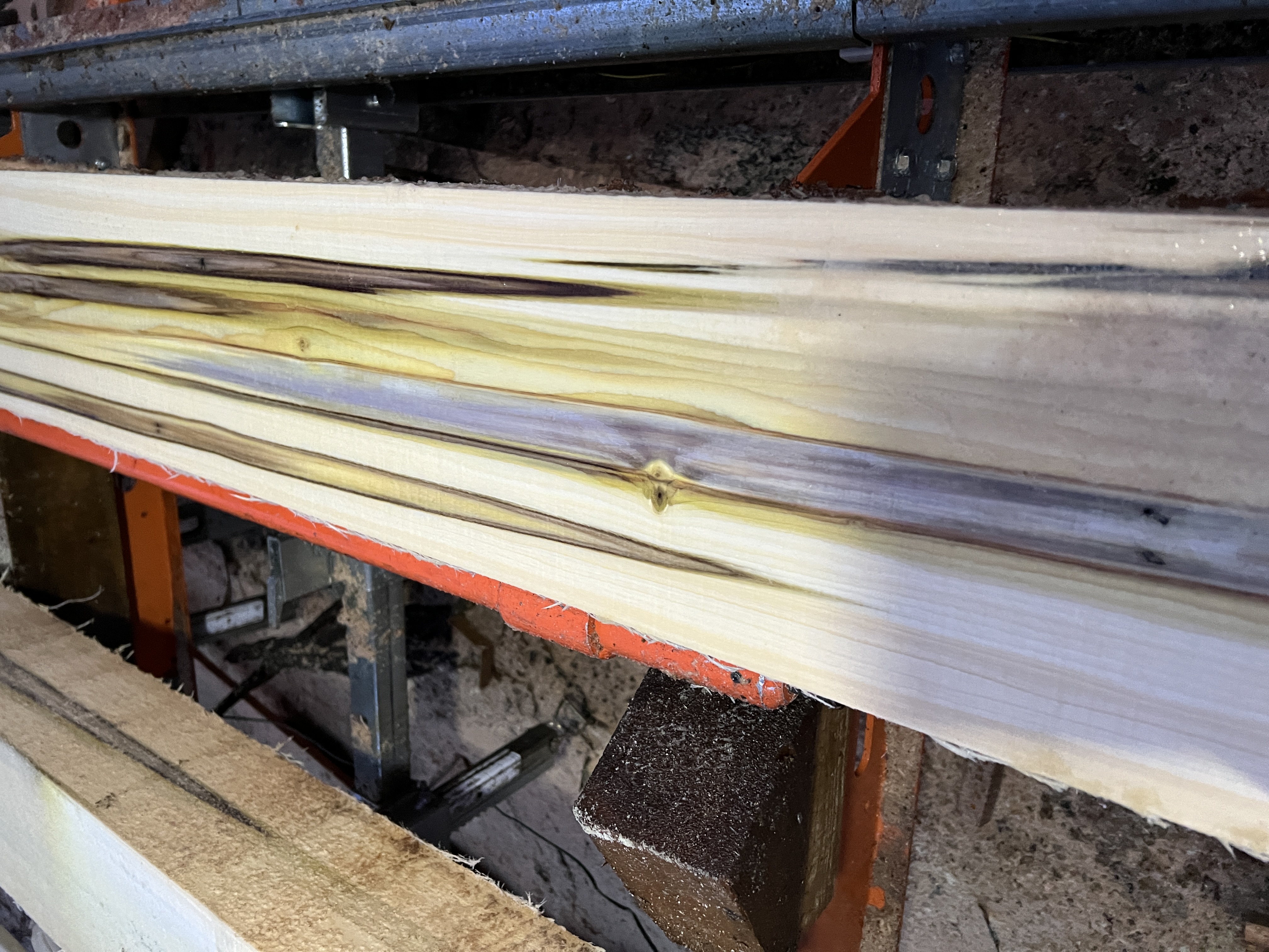

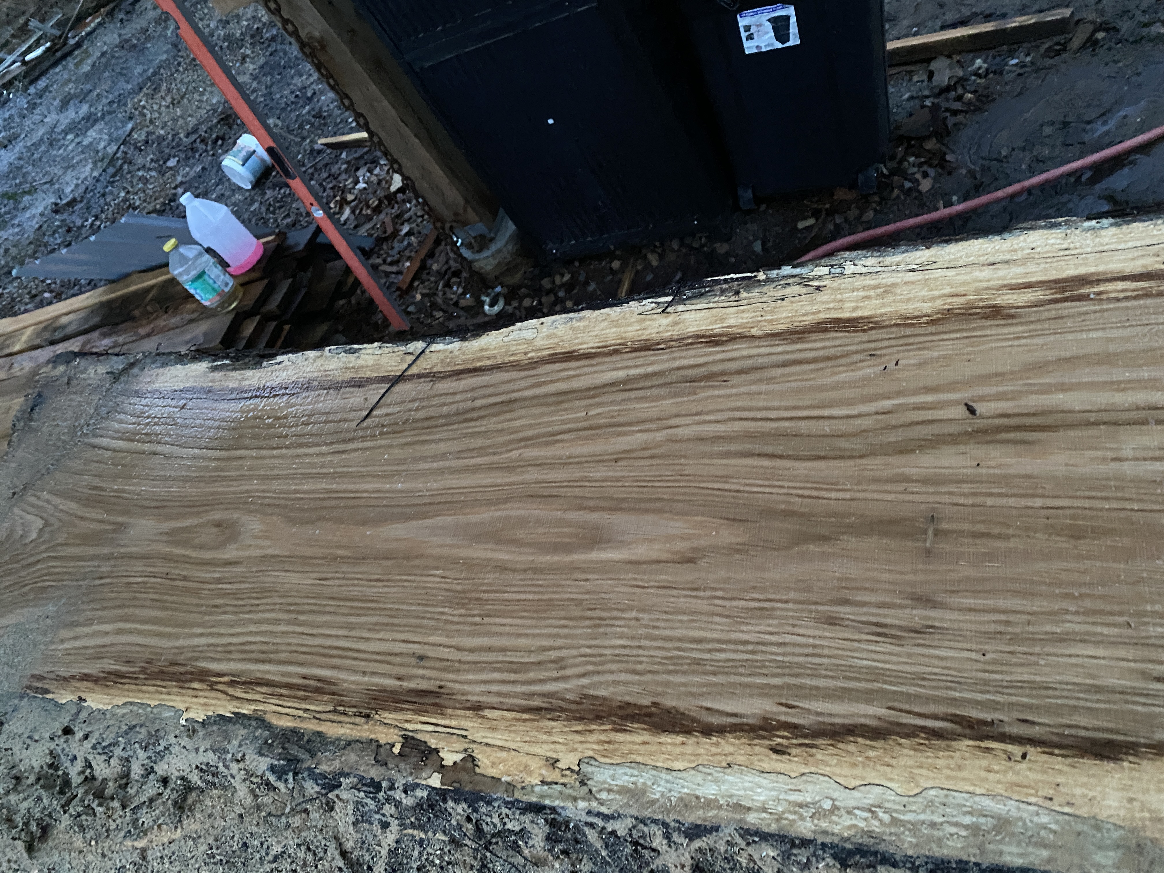

strange how this site keeps reposting my posts…..anyway, some cool wood discovered recently…..first pic is actually white oak(after standing dead for 10 years), 2nd is poplar(the infamous rainbow poplar), and the third white pine.
4/14/22       #20: sawing a solid black walnut mantle ...
MarkB
Its fun to watch the wild colors as poplar oxidizes as it hits the air.
