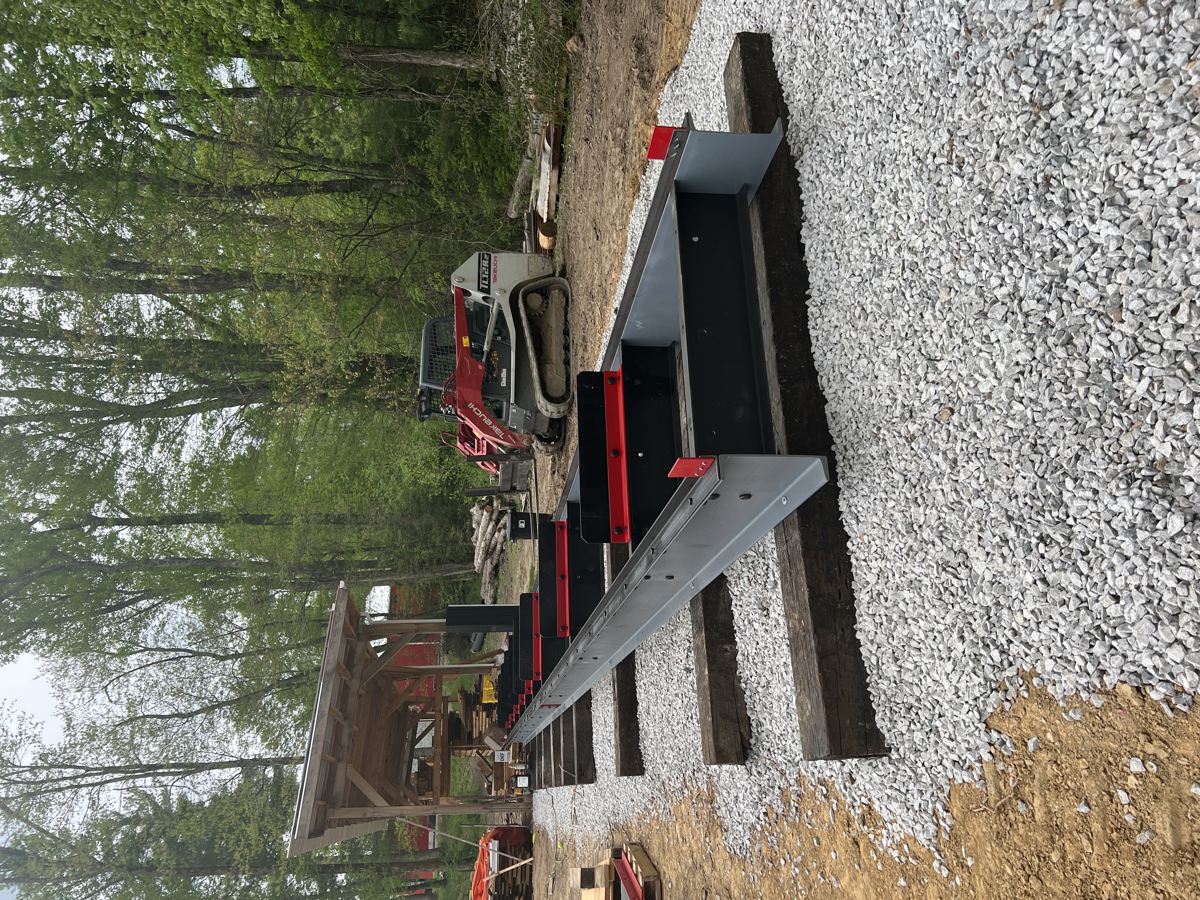

Oh yes I did! 45’ long!

Long capacity may be handy but I'd bet that setup is/would be nice for someone setting up another log behind the one your sawing or cutting boules where you could slice one down and move on to the next while som3one is off loading the other station.

yes, I built it for 40’ beams but realized afterwards that it’s got a lot of other benefits….
it lets me start shorter logs further from the sawhead so as to not have to be super careful to not hit the sawhead. And the other end is great stacking area for boards and then like you pointed out, I could actually saw two logs at once or load two and do two in succession. I’m new to logging so the fancy words like “boules” I am still learning! Unfortunately I work alone so there is no one else “offloading”, that guy/girl is in my dreams at night.

My thought was, as long as you have accurate dogs along the entire length, laying 3 12' logs on the bed to where you could open the first, saw it down (offbearing from the front or rear), then on to the next, and so on, while someone re-populates station 1, 2, etc... . A bit less advantageous with no help but.. Sawing boules is when you just flat saw an entire log down without rolling it and keeping the entire log sequenced. Typically someone buys the entire "boule" (log) because they want material all from the same log. So you would typically just set a log on the mill and flat saw whatever thickness slab's off the log then pluck the entire log back off the mill and sticker it in sequence keeping the entire log together.
Your long bed would allow you to break an entire log, move to the next while someone else is offloading station 1.
Hopefully your dreams land you on a dreamy logger chick that likes to run a forklift and pull gnarly splinters out of her hands. They are out there. Good luck.
