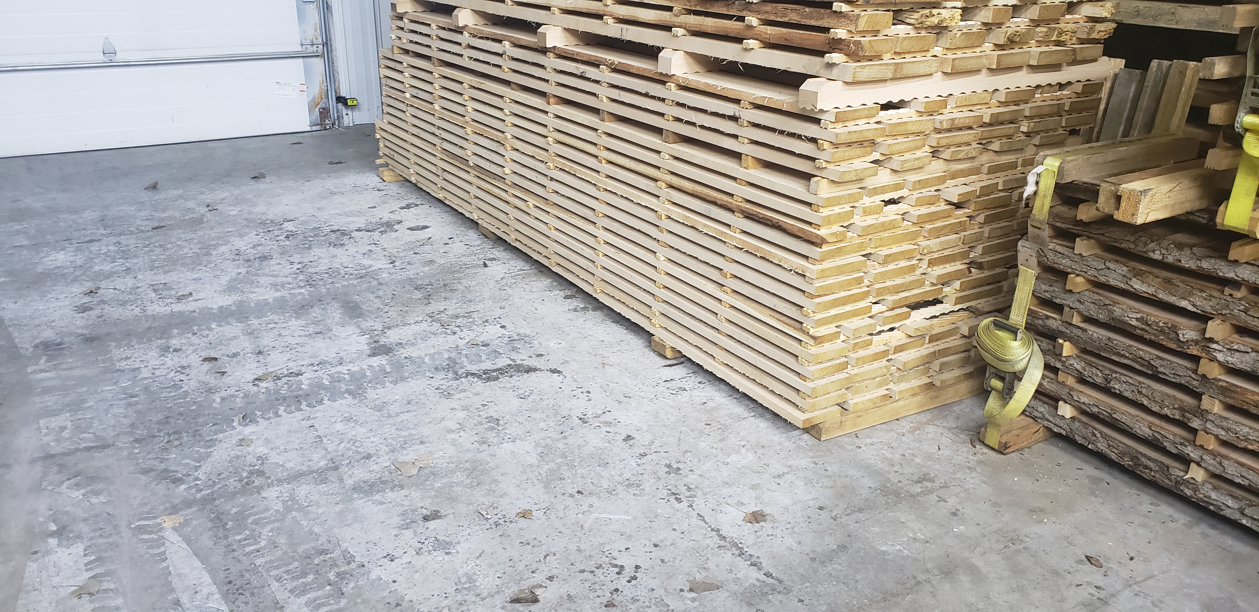

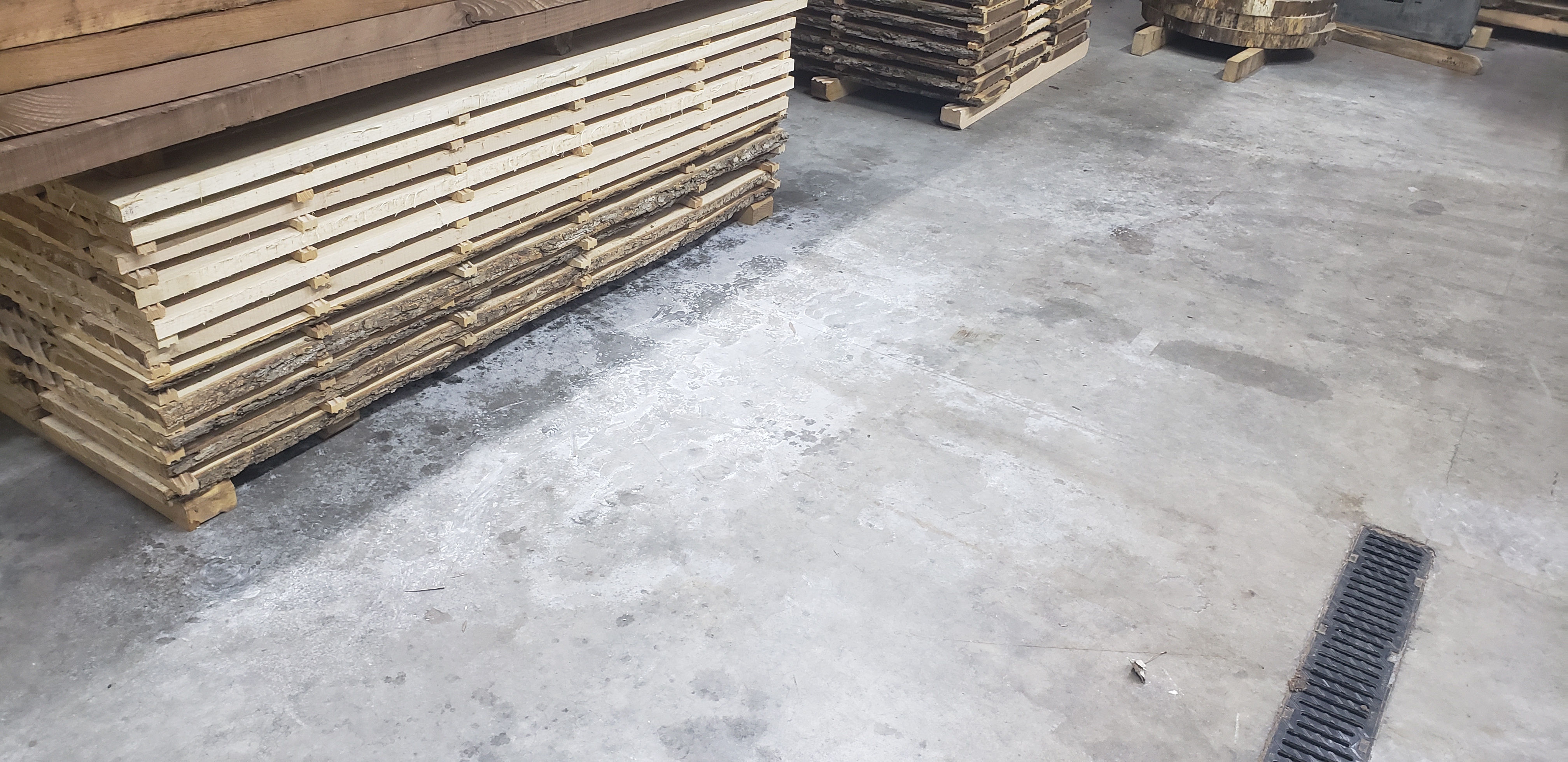

I moved two piles of fresh milled white oak inside for a few days as it was windy and dry outside. Inside is at 60% Humidly at about 55 deg.
There is this area by both piles of a white chalky power on the floor.
I use grooved stickers and I checked the lumber and no staining.
What causes this white powder? Is there outgassing that flows down by convection and hits the cooler floor and condenses? I had the floor heat shut off.

Not a chemist but my guess is this is efflorescence of the concrete. Probably due to the relatively high moisture of the air pocket under the wood and its lower pH from the oak.
4/23/24       #3: White powder by drying white oak lu ...
There is no gas in wood.

The white chalky powder you're seeing near the piles of fresh milled white oak must be caused by a process called "efflorescence." It occurs when soluble salts in the wood migrate to the surface and react with moisture, forming a powdery residue. This is common in environments with fluctuating humidity levels. Turning on the floor heat might help reduce condensation and minimize this issue.
