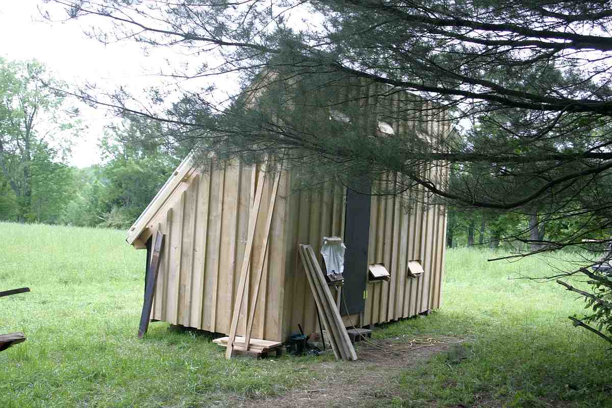

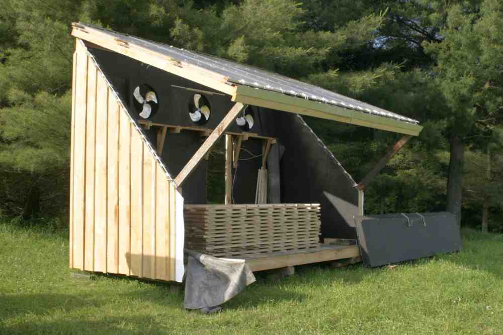

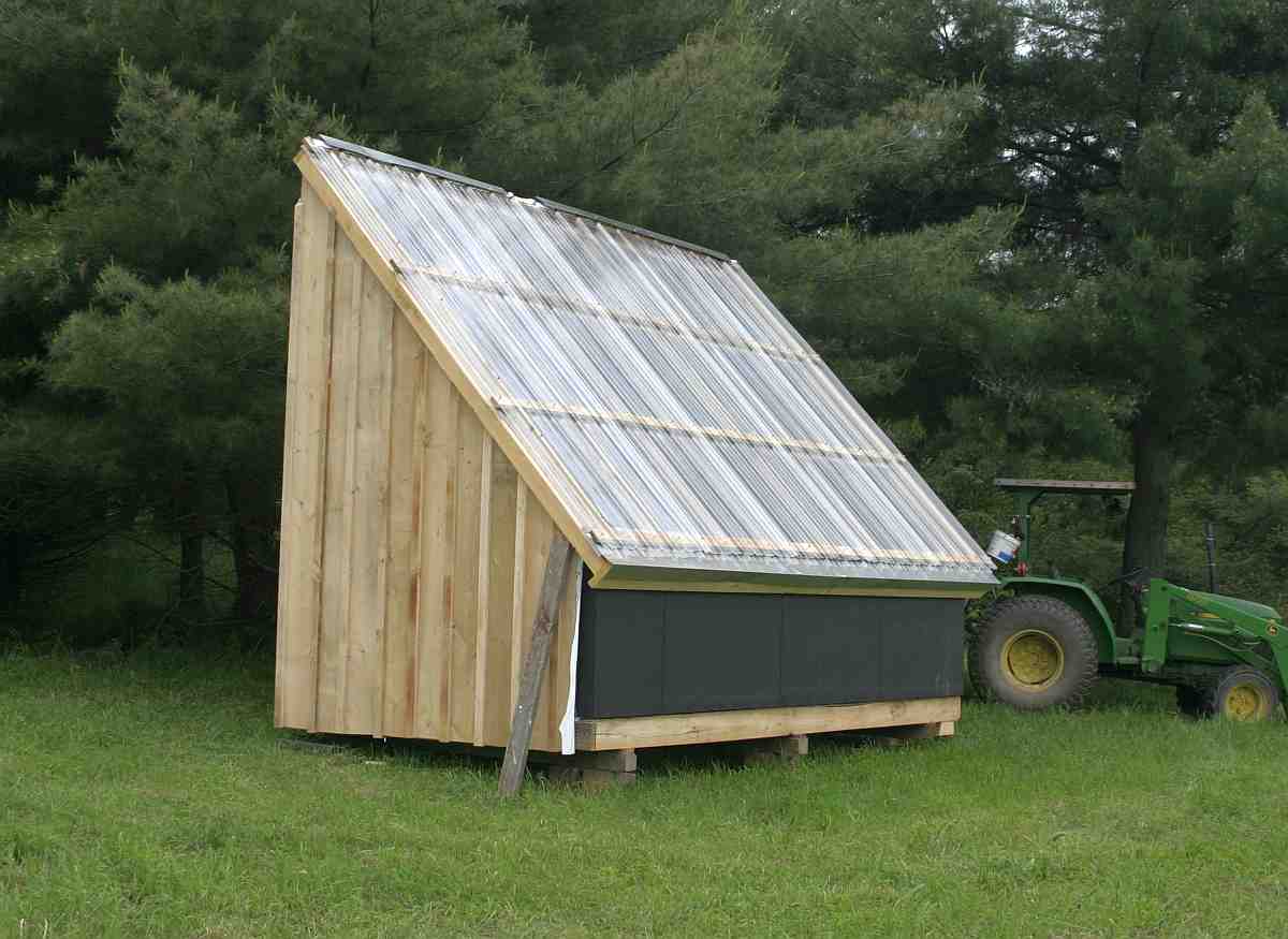

Carl
Some pics of the kiln - the plan is to
stain it black when the board and batten
siding is dry.
View higher quality, full size image (1200 X 875)
View higher quality, full size image (1200 X 800)

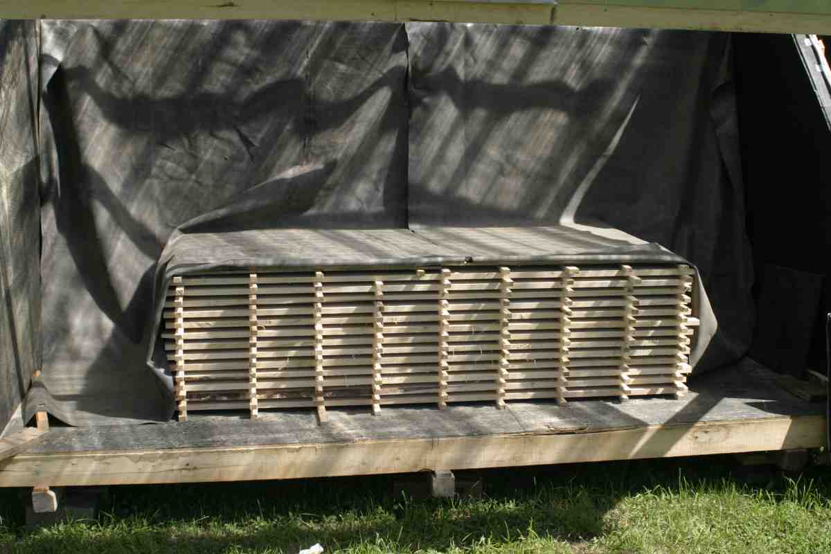

I had a large piece of commercial rubber
roofing laying around, and use it as a
tarp to direct air flow through the pack,
and block air flow from wandering around
in other areas - it appears to be very
effective at getting good velocity through
the pack
View higher quality, full size image (1000 X 667)

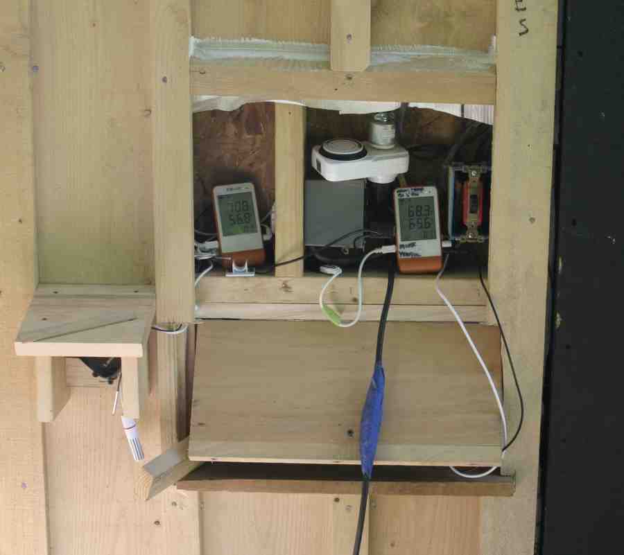

7/15/18       #4: First solar kiln load - drying time ...
Carl
I found an inexpensive ($40) temperature/humidity
measuring device, and place the measurement
probes near the center of the pack.
The device has built in software that produces
timeline reports, and I've included the
report in PDF form. I marked it up to show
the MC of the sample pieces and the percentage MC loss for each day - the
report really gives insight to the daily
behavior of the kiln.
I bought a second one to monitor outside
conditions so I'd get some historical data
on performance at different times of year.
The recording device is:
Elitech GSP-6 Temperature and Humidity Data Logger Recorder
And can be purchased at Amazon:
https://www.amazon.com/gp/product/B01H3669T4/
View higher quality, full size image (900 X 801)
20180703_kiln_run_report.pdf

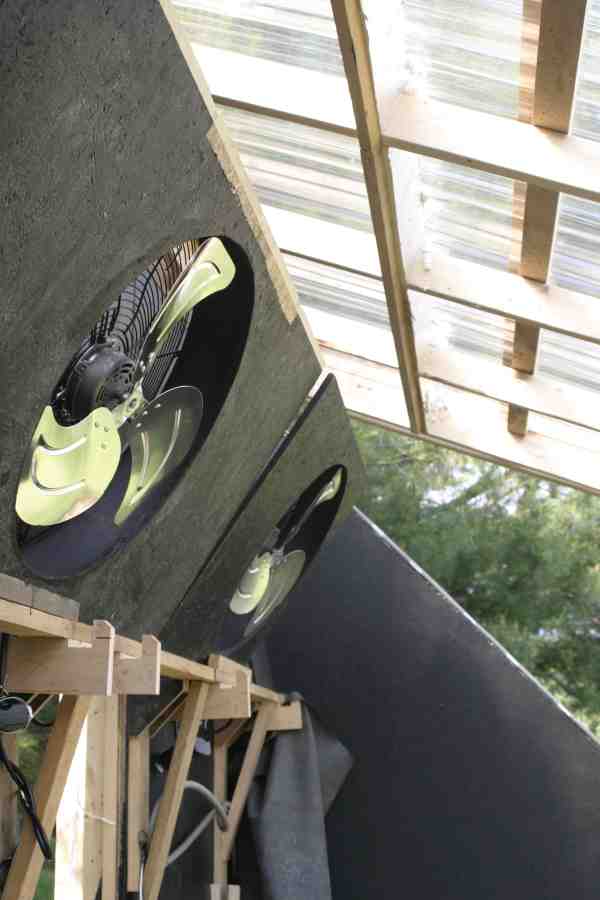

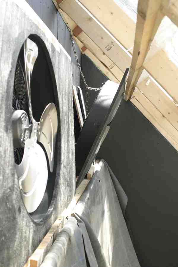

7/15/18       #5: First solar kiln fans detail ...
Carl

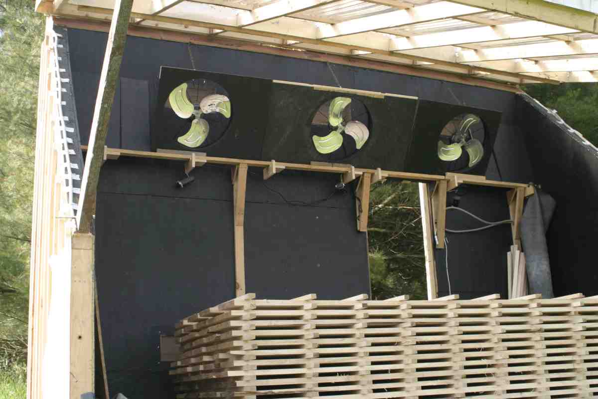

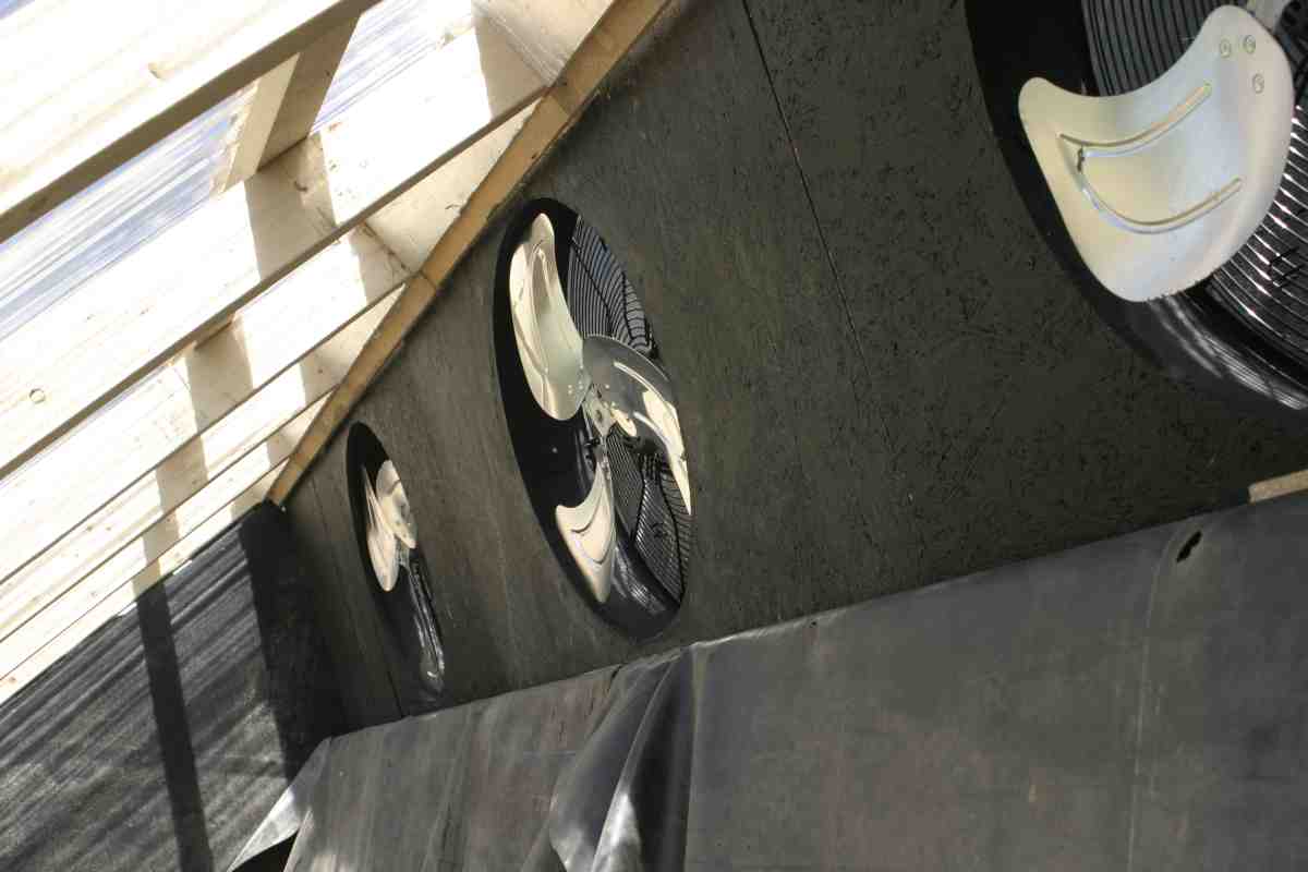

I used three Lasko 20 inch fans, and made individual
fan mounts. With the roof lifted up to load,
the fan mounts tilt back against the back wall.
After the roof is lowered/closed, the fan mounts
are tilted against a stop strip on the bottom
of the rafters - I felt this tilted arrangement
might better direct the air move along the
collector rather then having them pointed
horizontally at the collector
View higher quality, full size image (600 X 900)
