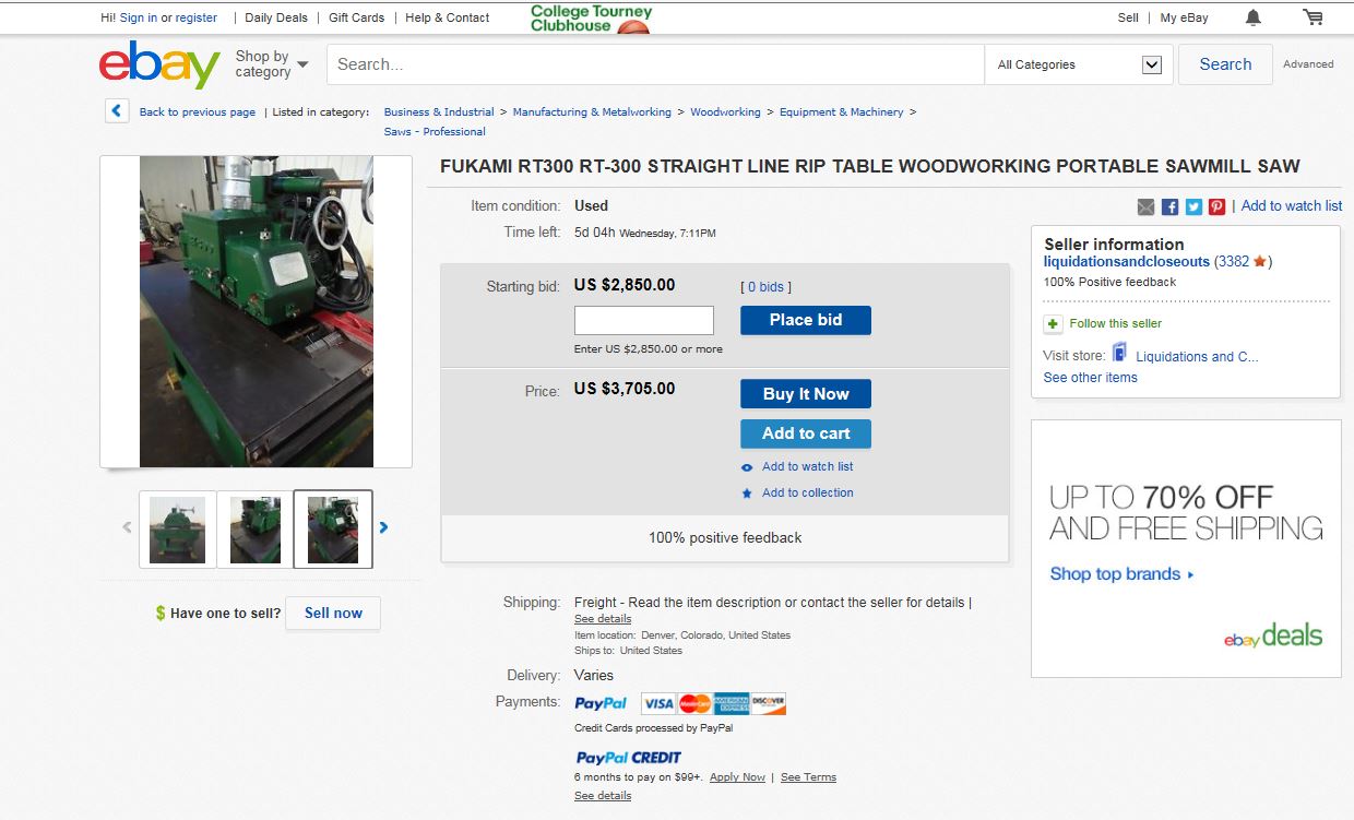

Bruce H
If I were looking for a SLR this looks like it might just do the trick. My experience with Fukami is that the were well enough made. I had a Lobo SLR which was a better saw than my new Powermatic, dealer convinced me I needed to upgrade. Most of these small saws didn't get much use.
View higher quality, full size image (1240 X 751)
