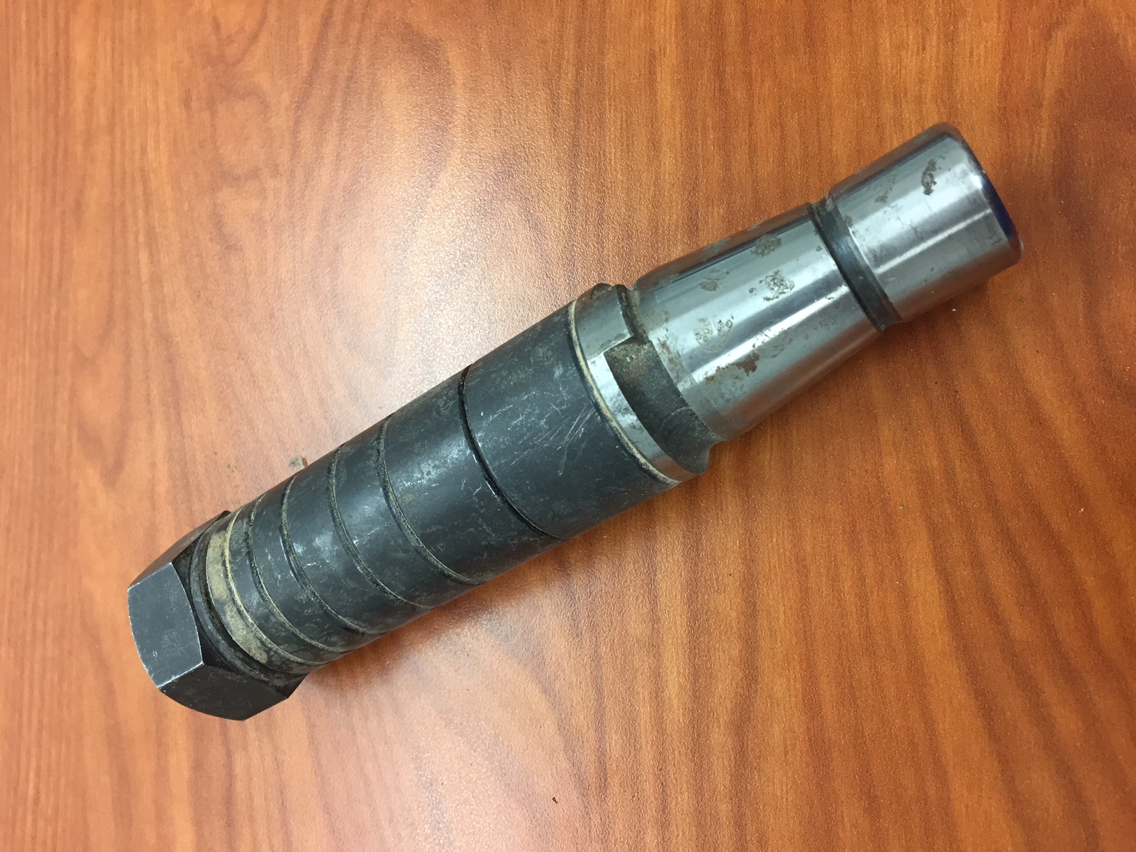

Ken Member
Hey Jared, if you have a sec would you post a picture of that spindle? I'm interested in the taper.
3/23/18       #8: Sunhill shaper ...
Jared Emery
This is a 1" spindle. I didn't clean it up. Bottom diameter at the tip of the taper is a smidge less than 1"
