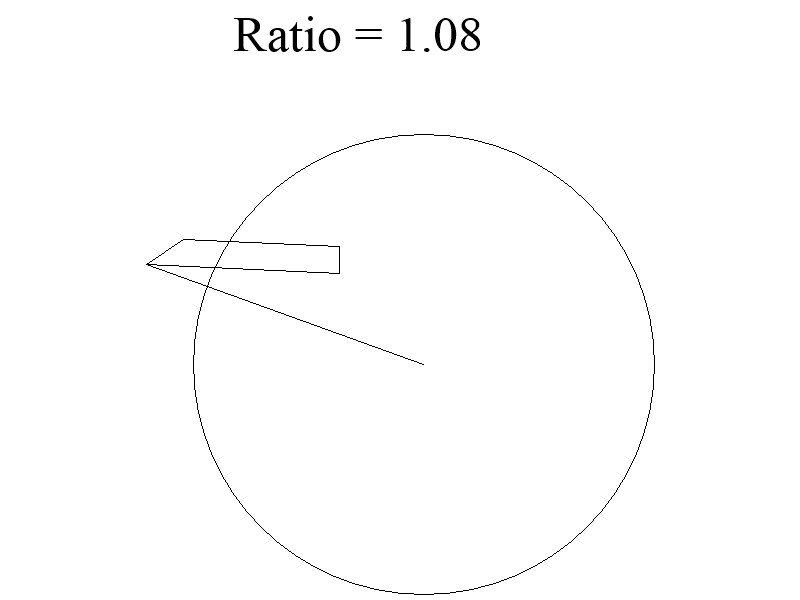

If you have a piece of molding to match. You can cut the end off at 20 degrees (if 20 degree hook) and trace the template directly with the bevel held flat.
Another method, a bit more scientific is illustrated in the drawing. You layout the cutterhead then calculate the elongation by dividing the short projection at 0 degree hook into the longer projection of the 20 degree hook. Trace the profile on standard graph paper (.25 X .25 Grid) then using a custom grid paper with the horizontal dimension elongated by the factor calculated, layout the elongated version by matching the intersects. You can also use cad software to stretch the profile by this factor in the horizontal direction.
The amount of elongation is a function of the hook angle as well as the radius of the cutting circle.
When I first started grinding shaper knives on a bench grinder I would simply grind the profile directly on the knife knowing it would come up short, then run a piece and compare it to the desired profile, then adjust the grind accordingly thus sneaking up on the profile.
