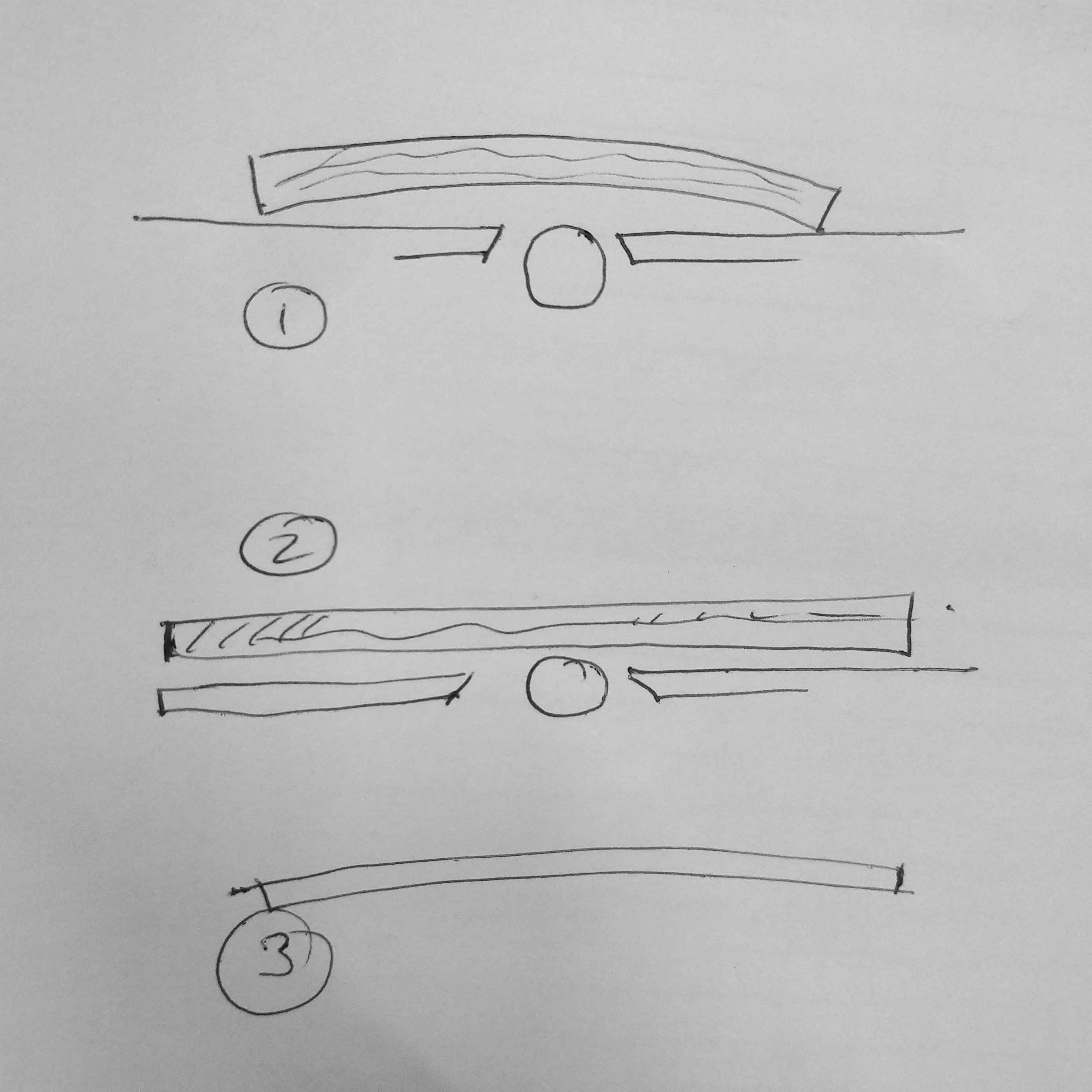

So we have our molding machine running very well now good knives good feed rate all that stuff. The problem I'm having now is trying to straighten material on the molder. Typically for what we need the maximum length that I'm running is about 6 ft and 3 in wide. We Mill rough four quarter Lumber down to 3/4 of an inch and typically we will run this material through two times. The first time we will take 2 mm off the bottom and 1 mm off the top to straighten the piece of wood. We have a low pressure on the first hole down roller so that it doesn't bend the wood down. The second pass we will take one and a half millimeters off the bottom and one and a half millimeters off the top to give us a final dimension of 20 mm. After the first pass the stock comes out quite straight. After the second pass the stock generally is not straight on the wide face and we have a curve to the wood. I included a picture just to show one is the first past two is the second pass and three is the resulting material. I don't know if I'm doing something wrong but maybe somebody can guide me.

I should clarify the drawing is looking from the side and the cutter drawn is the bottom head.

Ok, I see what's going on. Try this, take a wide board and split it, run one of those face up per se, the other face down. Do your normal process and then see if the cup is the same or opposite therefore eliminating a material issue. Are you putting first roller pressure at all during both cuts? What are you changing between runs? That might lead you to why the difference.
