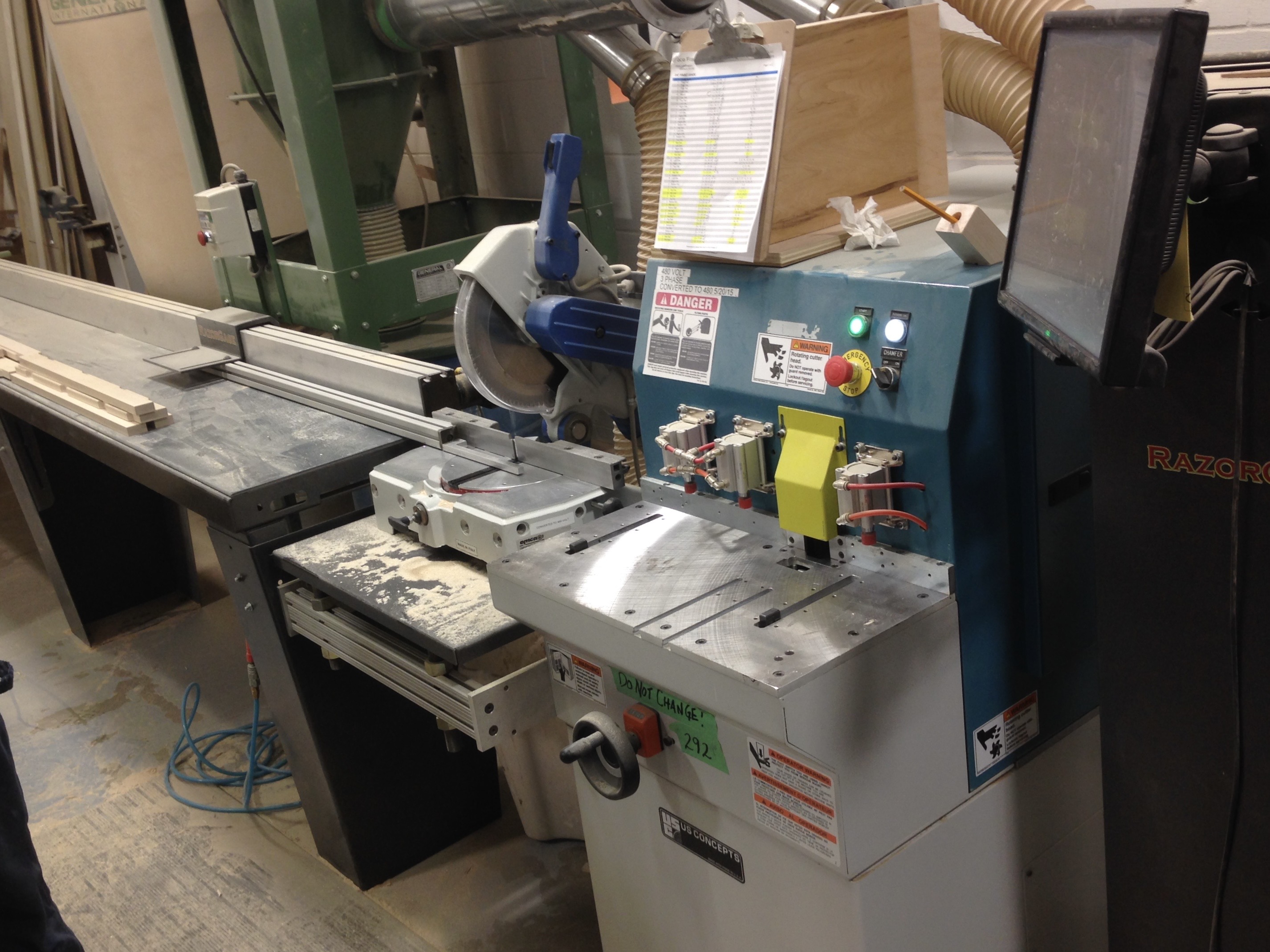

Joe Calhoon
I don’t do much cabinetry any more but was in an East coast shop a few years ago that had what I thought was a very slick setup for beaded frames. They had a US Concepts hauncher, Omga chop saw and a Razor gauge stop system. This was all connected to their software. Sorry no idea what type software. Anyway they were cutting beaded frame material out of the molder and cutting to length and notching all in one operation.
I think the bead milled into the frame is better than applied.

I agree milled to frame bead is better and is what I do on stain grade cabinets and furniture but on paint grade I'll often apply the bead , using a tablesaw sled for cutting mitres and a mitre knife for trimming them up as necessary.
The set up Joe shows is really nice, absolutely the way to go if you do enough volume.
