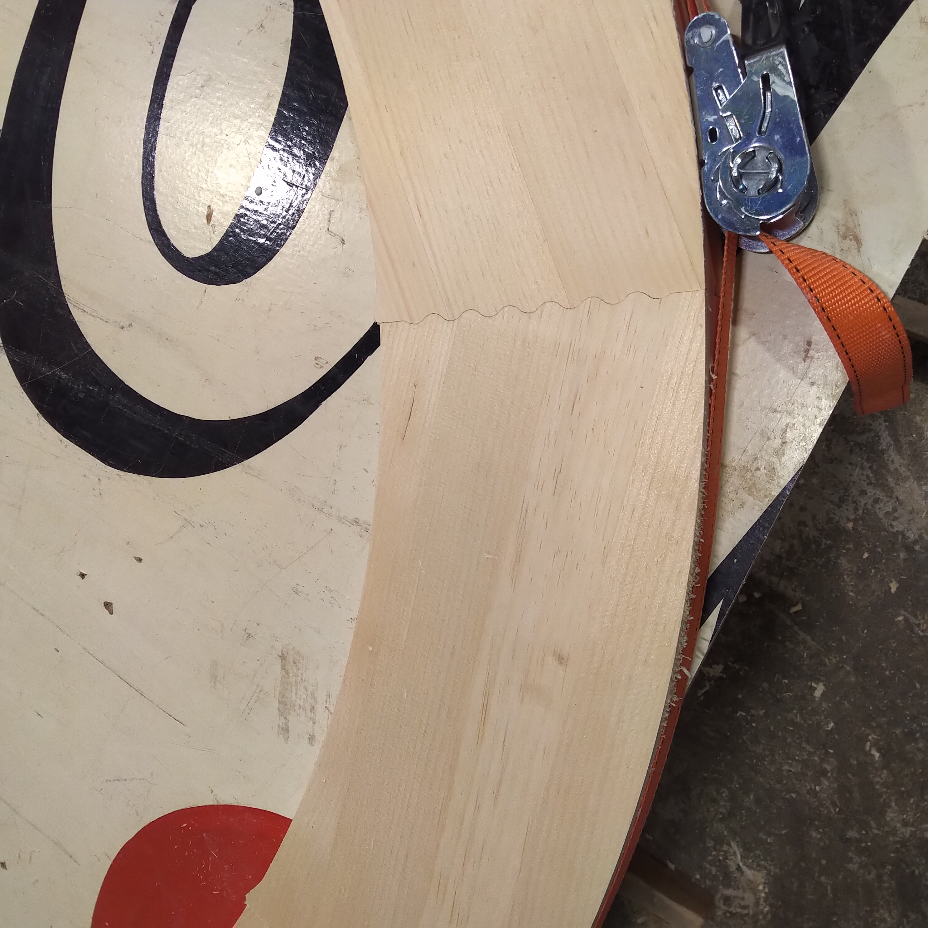

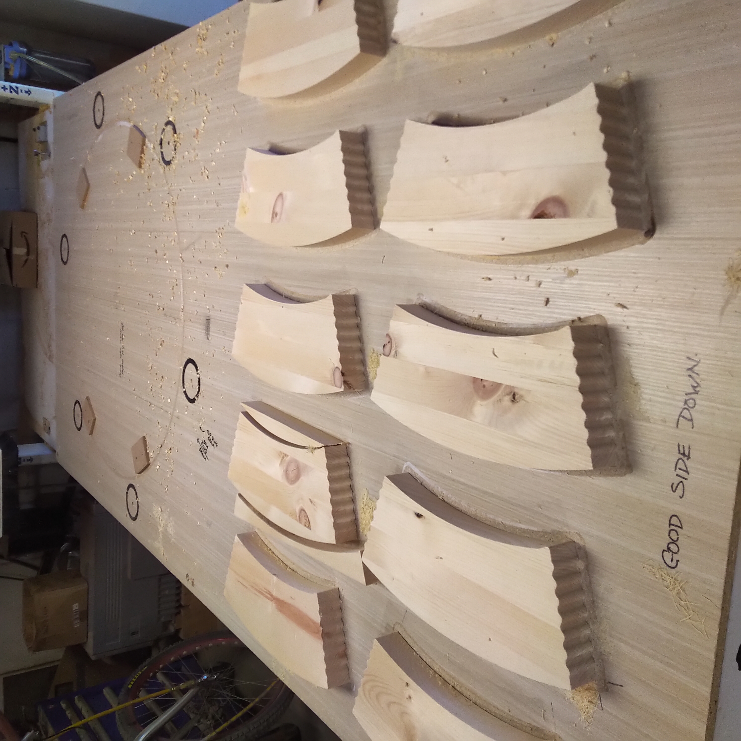

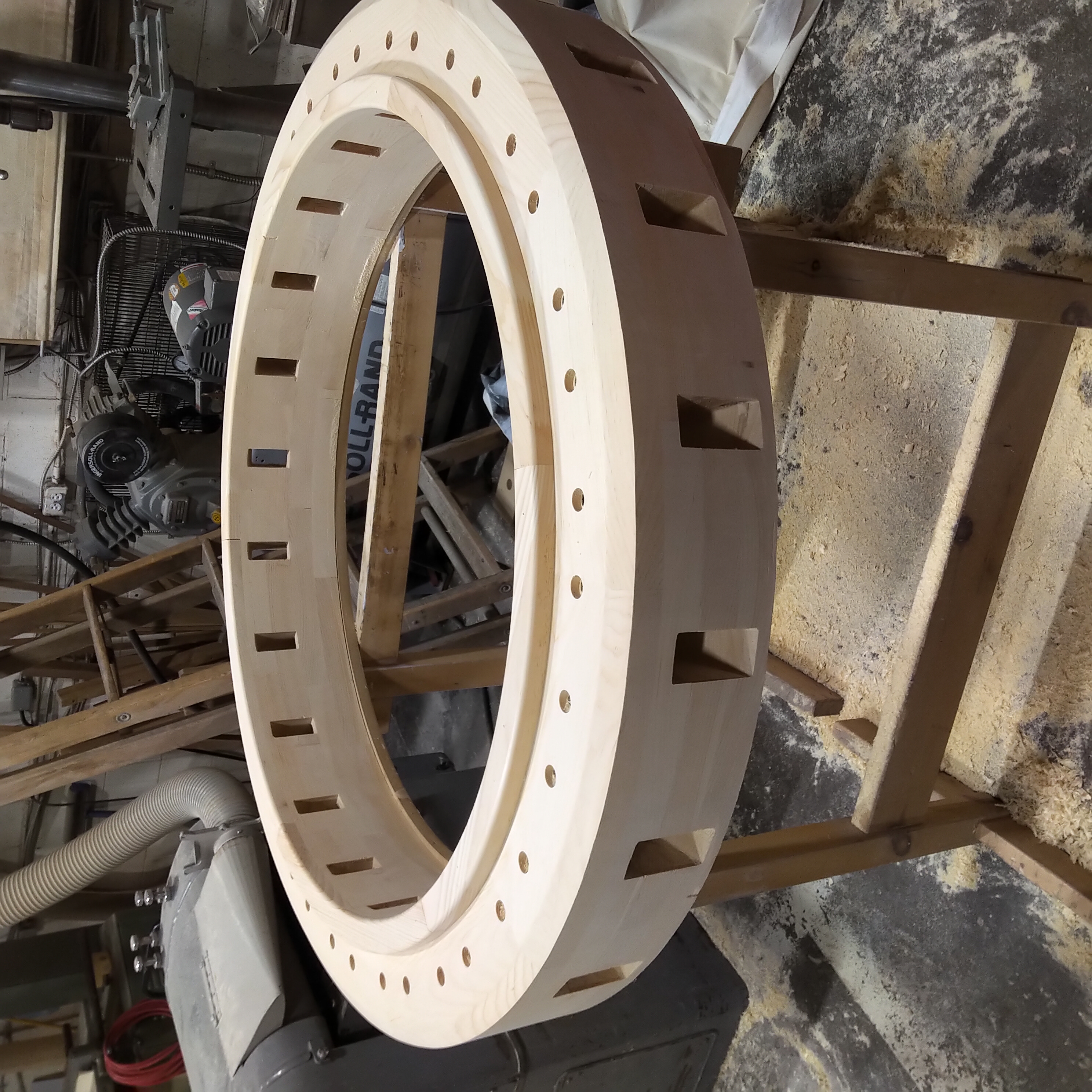

Here are some photos of the process I use for making pine rings approx. 48" dia with a 6" x 6" section. Four layers. These are for yurt roof structures.
What you might find useful for your work is the wavy end-grain joint. Originally I designed it to act only as an alignment aid for when I band clamped the ring layers together. I was originally using Dominoes which were slow and not particularly strong. When I tested this joint, I was blown away with how strong it was. The wavy joint only deviates from the centre line by less than 1/8" yet I was unable to break the sample with repeated blows with a 5 lb sledge hammer. I have made at least 200 of these rings and haven't had a single joint failure.
I think the joint's strength comes from the wood/glue bond working in shear and tension and adding long grain adhesion zones.
I haven't played around with other applications for the joint yet.

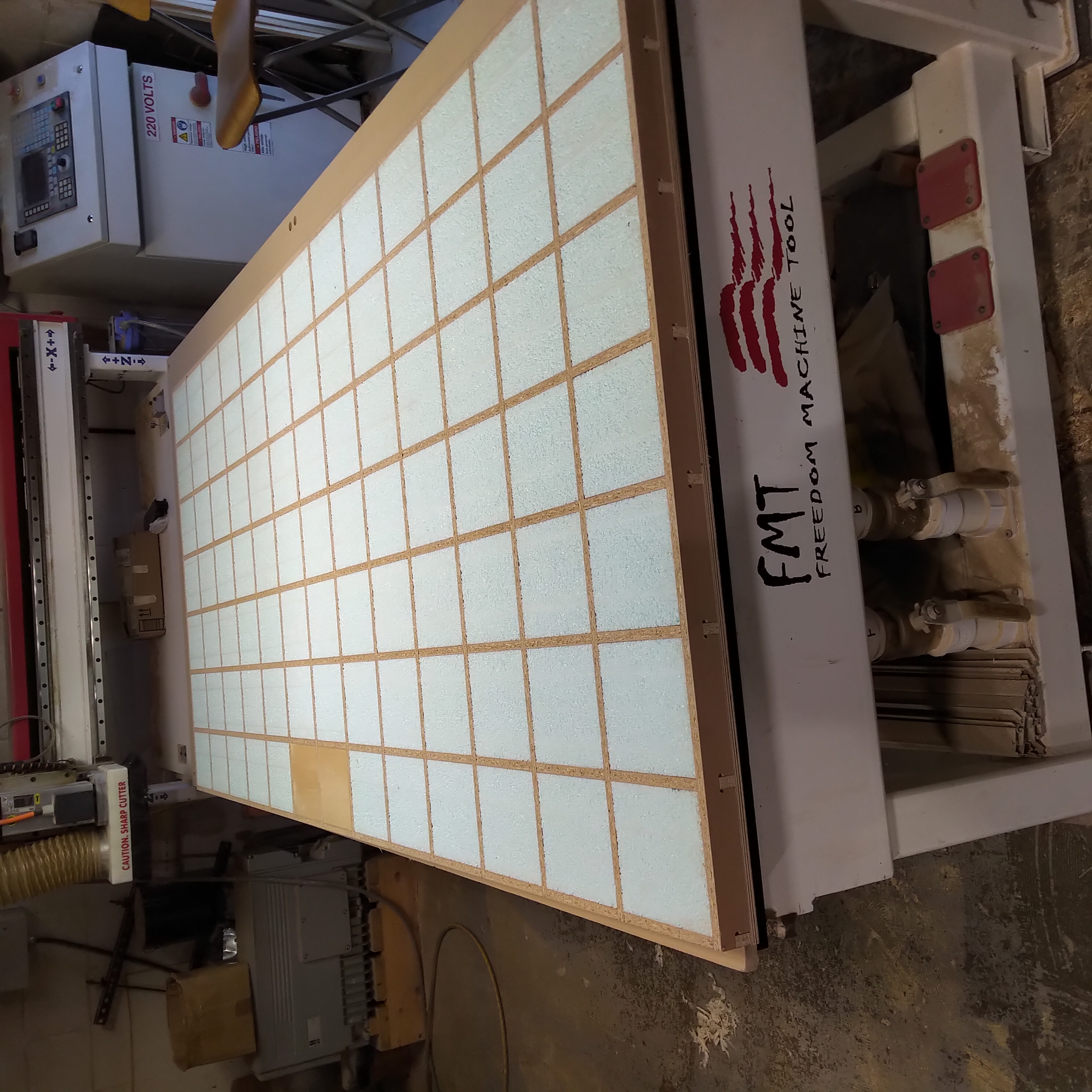

Looks good. How do you machine the joint?
1/16/25       #3: Strong end-grain joint ...
The first pic is the layout of my cnc. I have made a melamine table with gasketed sections for holding the blanks. Vacuum holds them well.
I cut these in three passes with a 3/8" spiral bit with a .015" final pass climb cut.
