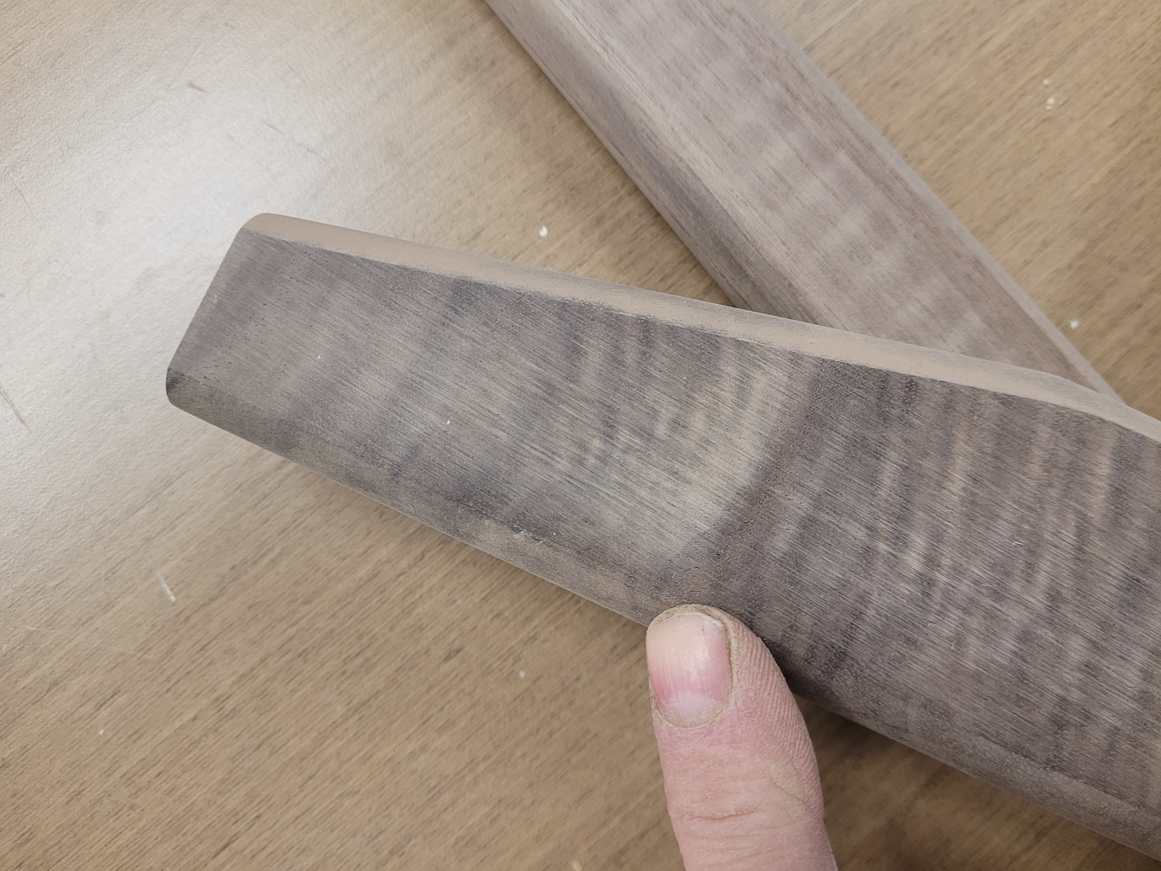

I cannot for the life of me figure out why i am getting snipe like this on the trailing end of the wood.
120 grit o. 24" combo head widebelt. No platen.

I'd guess that when your rear hold down roller clears the work piece it jumps up. Why? Maybe it's set too hard. The front roller is pushing it down. Every sander is different so It's only a guess.

How long are your is your stock and how much out feed conveyor do you have left after the sanding head?
We often had a similar snipe on man doors if staff was not supporting a tall door on the outfeed end.

Thanks guys. Fred it happens on any length of stock from 12" up. I don't think it is because of weight hanging off the table. I'm going to fuss with the hold down rollers. Maybe that's the answer.

Measure from the center of the snipe to the end of the panel. Then, find out on the machine where there are rolling components that are the exact same distance apart.

I agree that your problem is probably improperly set rollers. Same thing will happen on a planer. If you've dealt with planer end snipe before just keep the same rules in mind.
