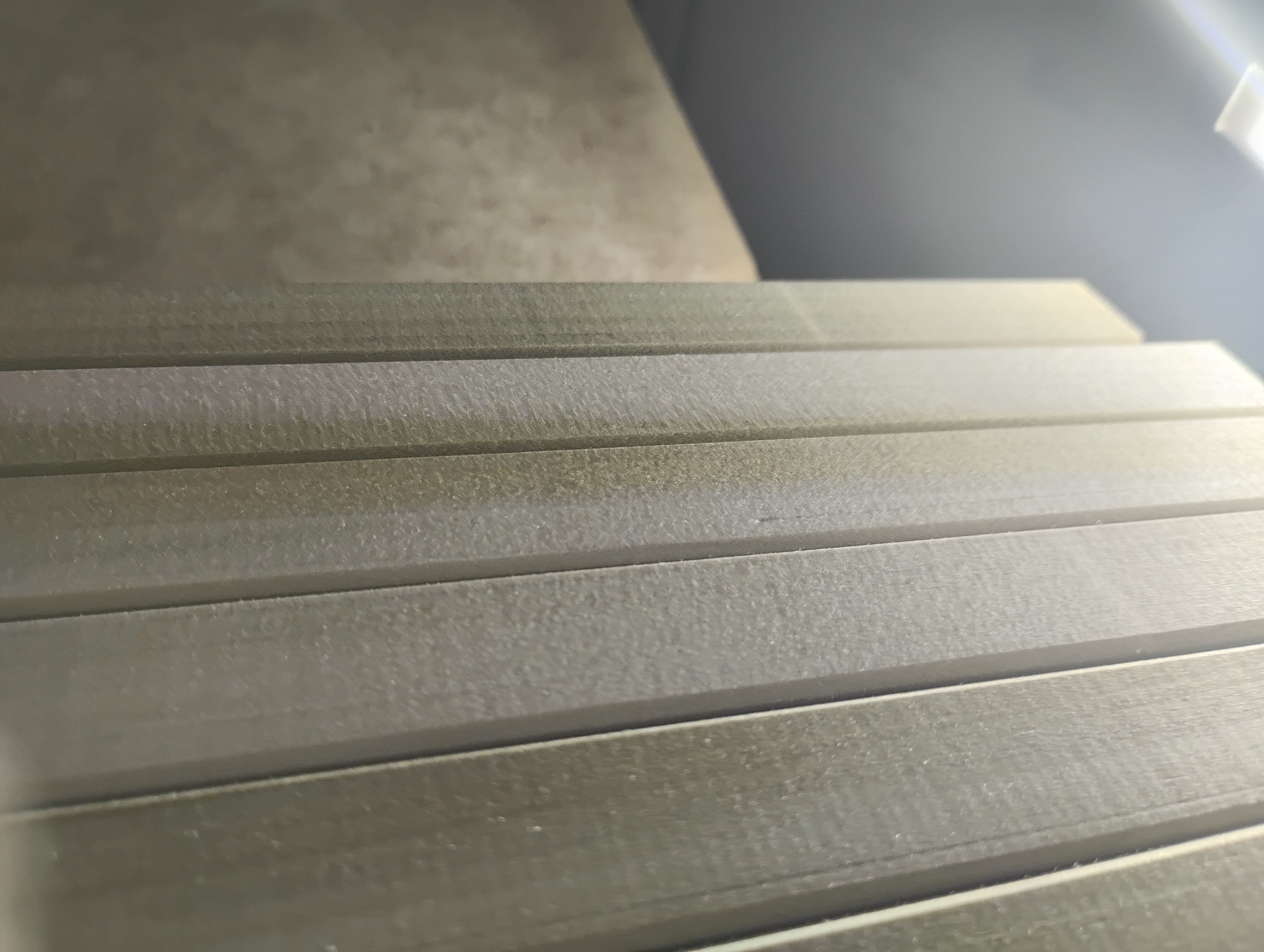

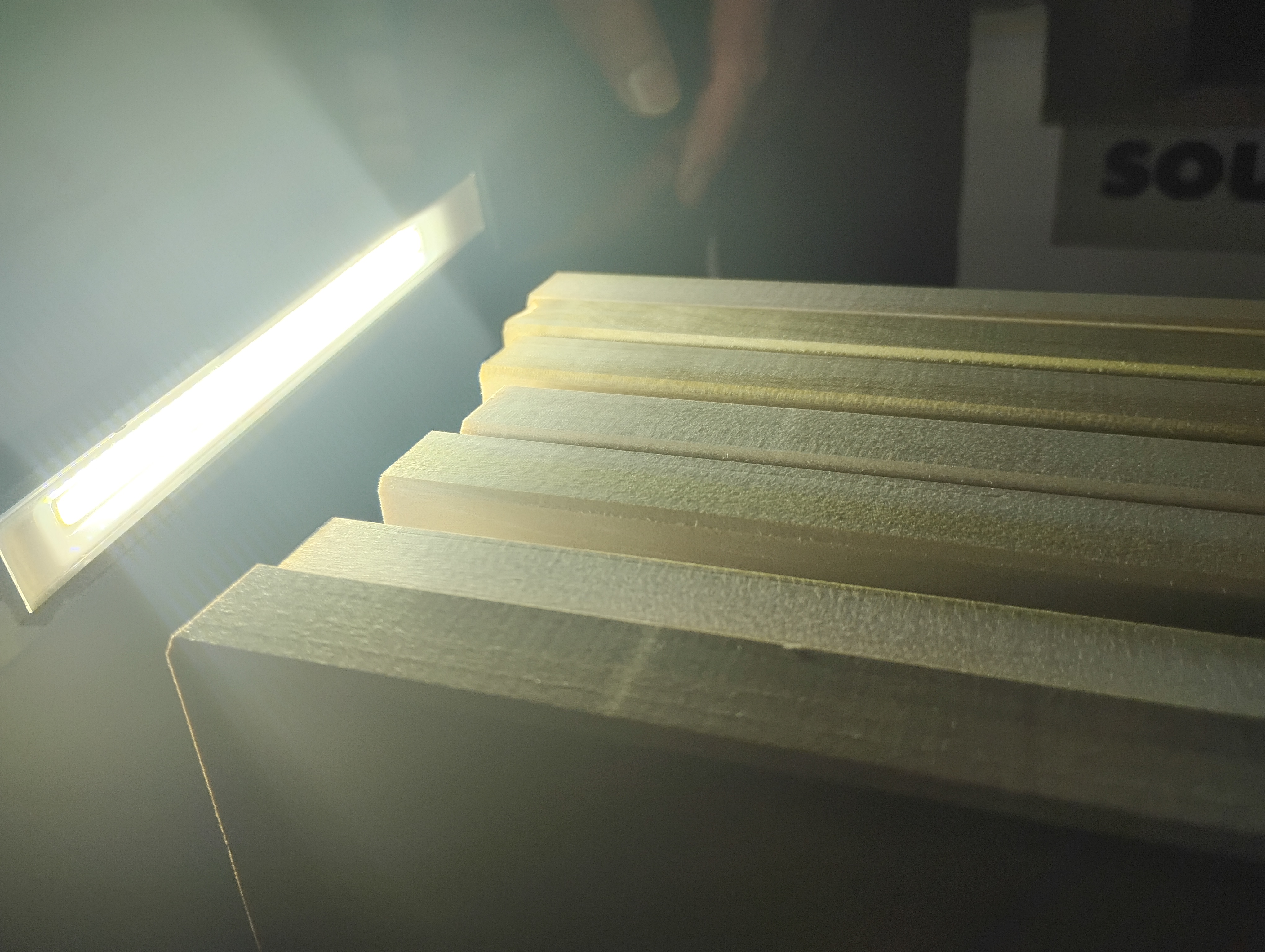

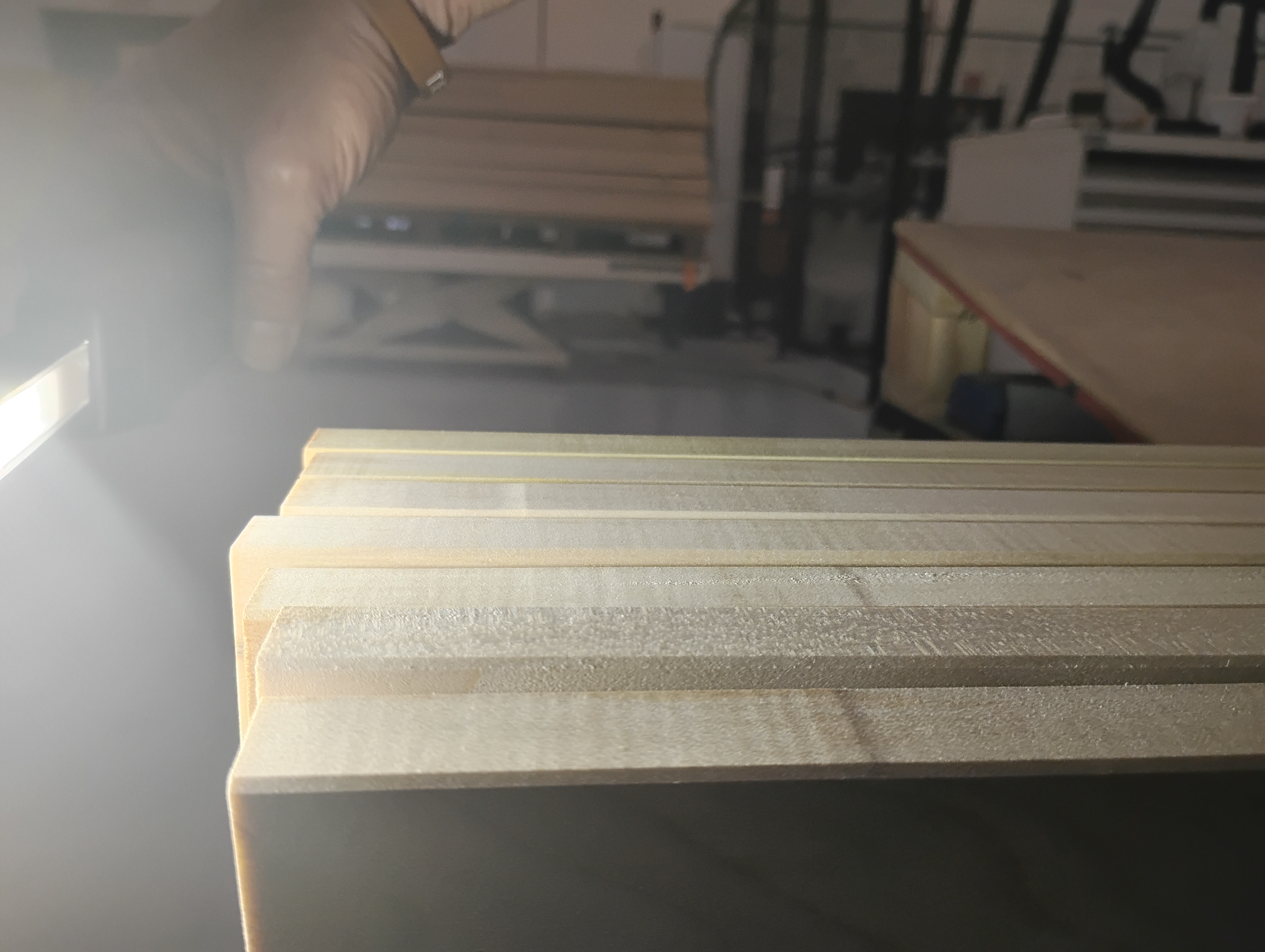

Ok So I lied I thought we had it. Now we are having this problem.
View higher quality, full size image (4080 X 3072)

What am I looking at? Your photos are worthless without an explanation. Please be careful in your explanation or you are just wasting all our time. And please answer every question, or the conversation cannot continue.
Again, last chance: what are the dimensions -width and thickness of the desired part? Inches, please.
What are the dimensions of the snipe area of the part?
How far from the leading edge does the snipe end?
Does the radius of the snipe match the cutter head diameter?
Does the defect even fit the definition of snipe?
Was this covered when you were trained?

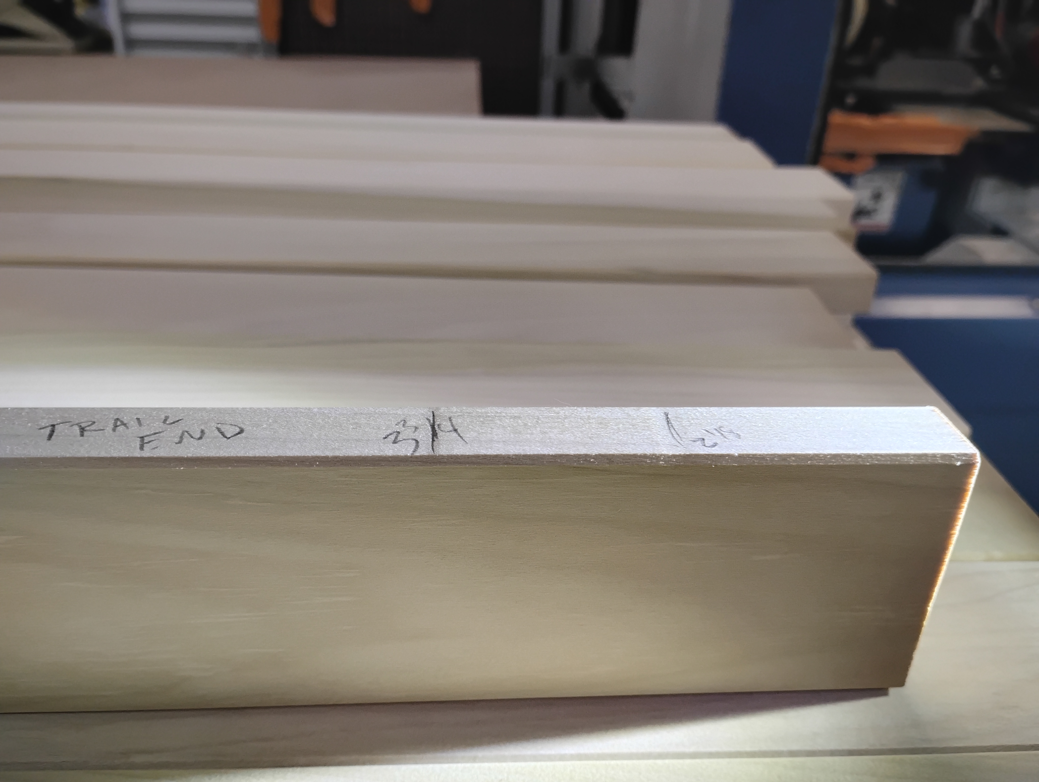

The radius doesn't match. By definition it's not a snipe. I have never seen this on anything I have run in 20 years.
The part is Poplar 8' long 3/4 x 2 1/4. As you can see in the photo I marked the lines with a pencil to show the distance from the end of the piece. Please let me know if you can't make out the sizes I wrote on the board. Thank you again for trying to help me.

Without real answers to each of my questions above, I cannot move forward.
Good luck, I hope you get it figured out.

A little bit more information. They pushed a head into the fence. We realigned the Infeed fence which was off some. I made sure the Fence did not get bent from the impact. We also had a pressure roller bearing seize up and we also had an issue with the cylinder on the first 2 feed wheels. The air cylinders are hanging up. As for the marks we Have one on both ends of the board. It seems to look like a square and its raised above the rest of the machined edge. I am trying to explain as much as I can to see if anyone has an Idea I didn't try yet. My guess it it has something to do with alignment or the pressure elements. Or a combination of the two. I tried my best to answer David R's responses but I wasn't clear enough for him to understand me. I appreciate any help. Thank you

So after looking at your pictures and thinking for a bit. You have multiple problems, looks like you have right cutterhead trailing snipe, correct? That means the cutterhead is too far out beyond the outfeed fence. Your cuts also look horrible, like you have a vibration and material is bouncing around. Fix each problem you mentioned, the seized components are a big concern. The air cylinders, I would just order new ones. Also you mentioned someone pushed a head into a fence? You need to do an alignment check of the entire fence from front to back, including removing any sliding fences near the right head and cleaning it all. Replace any hardware that looks questionable. Check everything with a super accurate straightedge and feeler gauges. Did you take the belt off the right spindle and free spin it to listen for bearing noise? These are a starting point, like I said, fix everything you come across and replace questionable stuff.
