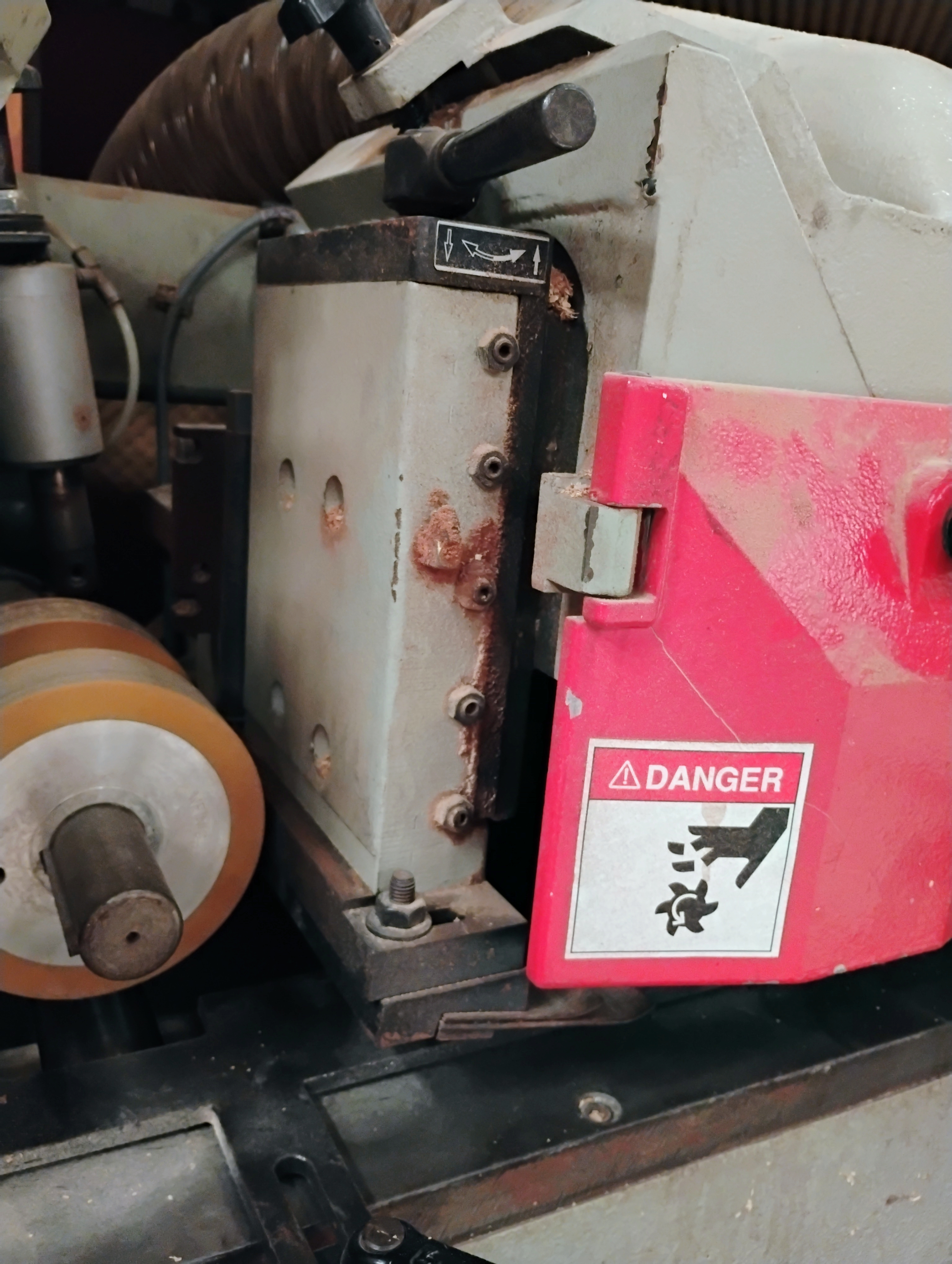

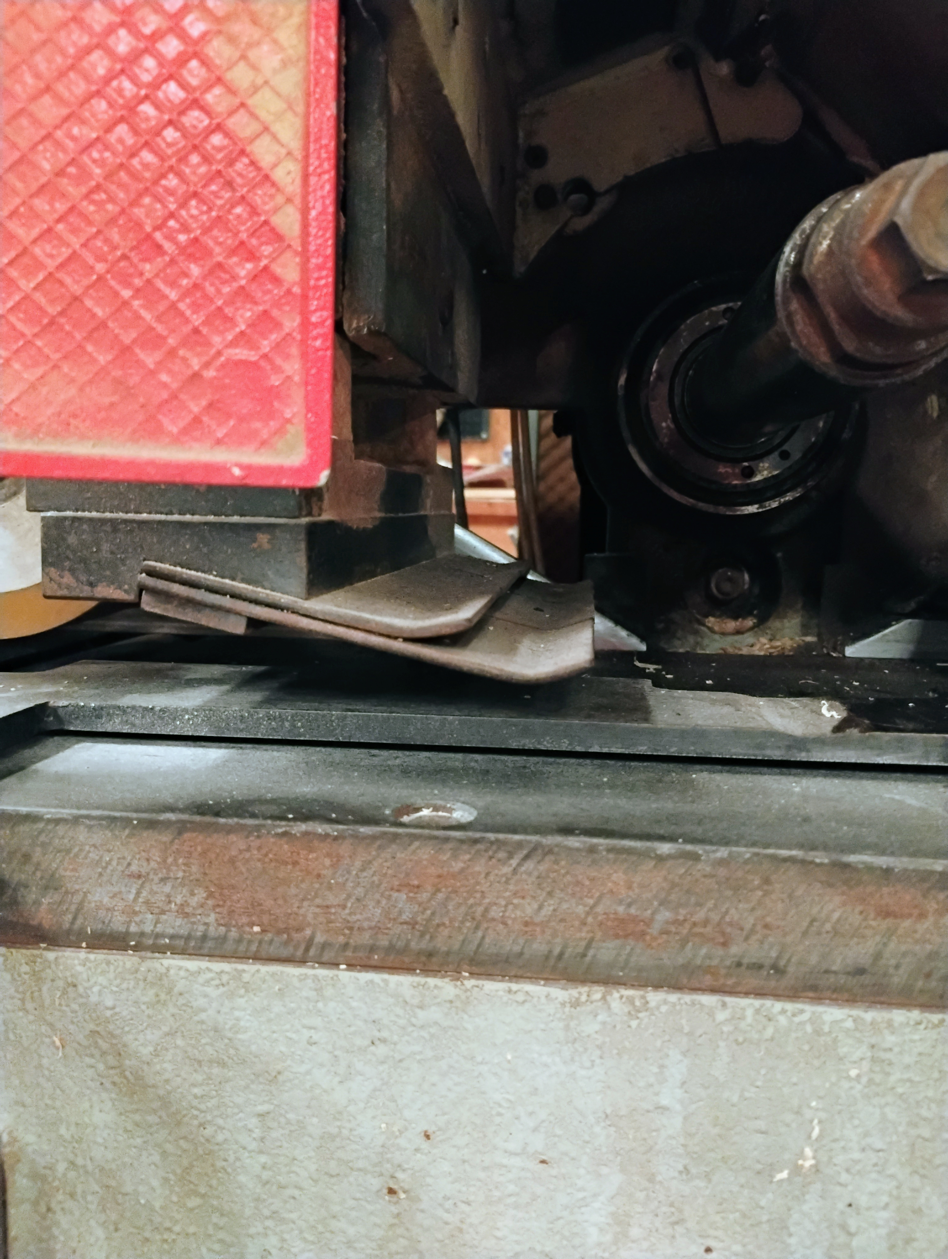

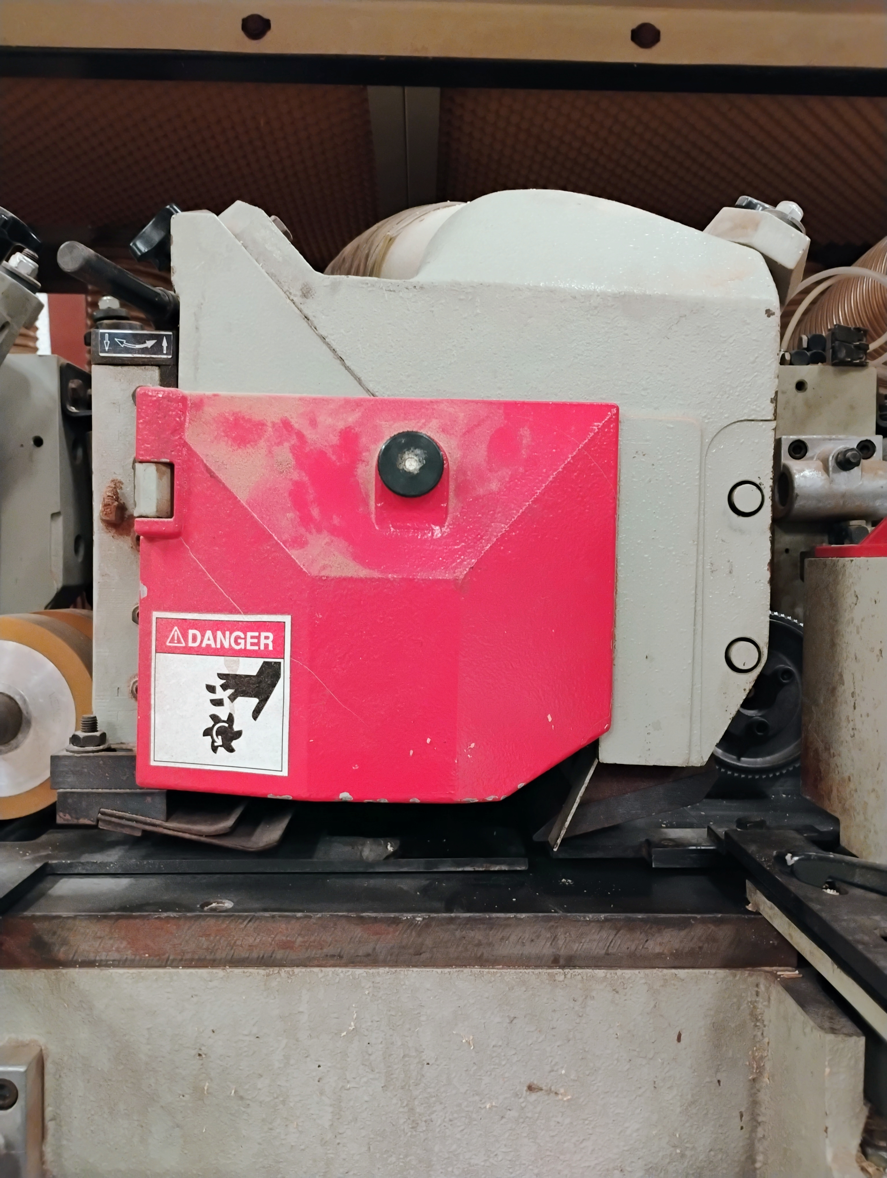

Hi,
I have a 1998 Weinig Unimat 23E six head moulder. It has two top heads on it. The hold downs that I am needing help with are on what I am calling the first top head (the head closest to the infeed side). Let me first talk about the second top head (closest to the out feed side). The second top head has a large flat pressure shoe on the out feed side and a chip breaker on the opposite side. The large flat pressure shoe on the second top head is the only hold down on both top heads that has a counter on it. From what I have learned from the Weinig manual, I need to set the counter on the flat pressure shoe to the same reading as the tool radial dimension on that same head. I know that I can also put my straight edge on the bottom of the flat pressure shoe and line it up with the tip of the knives in that same head. And, I think I was told to lower the flat pressure shoe about 1/4 turn from that setting with the adjustment knob. From what I have read in the manual, the chip breaker for that same head should be 3mm (app. 1/8") lower that that flat pressure shoe. Now, with all that said, I am needing help with knowing how to set the hold down (I think it's called a spring plate shoe) and the chip breaker on the first top head. What I think is called a spring plate shoe is not at all flat like the large flat pressure shoe on the other head. And, there is no counter on this first top head. So, with it not being flat like the other shoe, I can't put a straight edge on it accurately. So, how do I set the spring plate shoe on the first top head in relation to the knives in that head? And, how do I set the chip breaker for that same head? Another question is if I'm not planning to use the first top head and just use the second top head for machining, do I just raise the first top head, the spring plate shoe, and the chip breaker for that head up out of the way so that neither the spring plate shoe or the chip breaker for that head is touching the lumber as it passes through? I have attached a few pictures showing what I think is called the spring plate shoe and chip breaker for the first top head. If you need more pictures, just let me know. Thank you very much in advance for any help.
