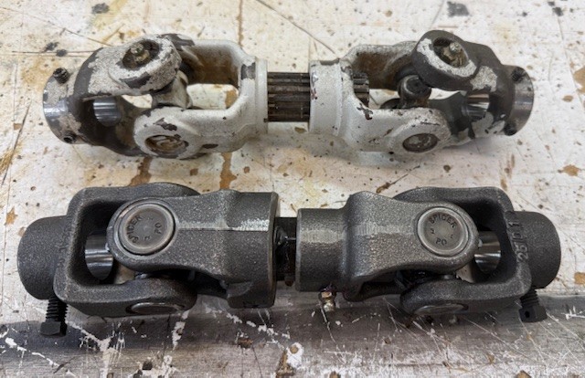

One of my guys ran a 3.75" square piece of white oak into our molder to S4S it to 3.5" square. Problem is, he inadvertently set the height for 2.5". When it ran into the 2nd feed wheel, the U joints on the drive shaft exploded. I was able to get the broken parts off, and the rest of the machine appears to be ok.
My question is, how do I go about sourcing replacement parts?
The machine is a 25 year old Taiwanese 5 head molder that we use to do S4S work on furniture & cabinet parts. This is the first time I've had replace anything on it, except for a drive belt 15 years ago. The company is no longer in business, so I can't go to them for support. The parts themselves don't appear to be anything exotic, but I've looked online and can't seem to find what I need. Any ideas on what my next steps should be?

The yokes all look okay. Is that the case? If so measure the U-joints and see if you can find anything compatible.
Machinery companies keep costs down by designing their equipment around off the shelf parts as much as possible. I'd think if you take measurements from the destroyed U-joints and go online to some U-joint manufacturer website you would probably find something compatible.
If not then look to the complete yoke/u-joint assembly. While the center section looks more complex with what looks like some sort of slip shaft here too you should be able to find something.

The 2 yokes with the splined shaft are ok. But the other 2 are bent and I doubt are fixable. I've looked online, called a few molder service and repair companies (including Ackhust) with no luck, and gone to a local auto parts store. The auto part clerk thought the U joints were Spicer 1350's, which were inexpensive and readily available so I ordered a couple.
The 2 bent yokes are a different story. No luck so far finding anything like it.
Any ideas on where to look would be very much appreciated.

Finally got this sorted out. After 3 weeks of phone calls, emails & text messages to every sort of part suppliers, molder repair shops, machine shops, ect. ect. I finally got what I needed from a transmission & drive shaft shop. Using mostly stock parts and a little lathe work to match the diameters of the yokes to the shafts on the gear box and feed roller, they put together a whole new drive shaft assembly. Cost about $600, including freight. A couple hours of wrenching and we finally got it installed. Tested it out and it seems to work fine. Yay! Many thanks for all the responses.
