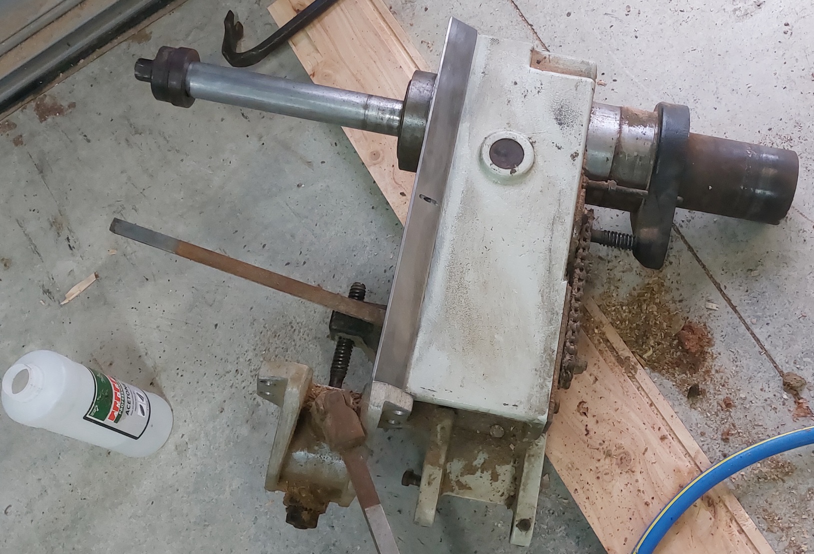

I am running a profimat 23 with 6 heads, the last head is a standard bottom and I have noted it is cutting .3mm higher on the outboard side than the inboard side, i.e. the spindle is higher at the nose (a 200x25 board will be 25.3mm on outter edge)
It has always been like this, customers have never noticed but every time I setup a profile it drives me nuts so I finally dived into it last week, tore the head right out and cleaned the gibs down with a wire wheel and acetone and reassembled cleanly, thinking I'd have it nailed but only to discover the same problem.
I've checked the .3mm error against the outfeed and infeed table to ensure they are level with eachother and they are.
Is there any other way to adjust a p23 head on dovetail gibs short of trying to stuff shim stock under the ground faces of the gibs..?
Thanks in advance,
Josh

Maybe put the shim stock where the entire lift assembly mounts to the main machine housing? That way you aren't messing with shimming in the gibs which can be an issue with moving the spindle.

The gibs are the mounting point unfortunately. I happened to snap this photo while the head was out, one entire cast piece that I needed a rope to sling from machine to get out.
Weinig must be awfully confident in their process to say they would accumulate zero error after grinding the ways into the machine casting, the dovetail into the head component, then the bore for the sliding spindle in the head. Makes me think I must be missing something - I suppose that is what I'm asking.
