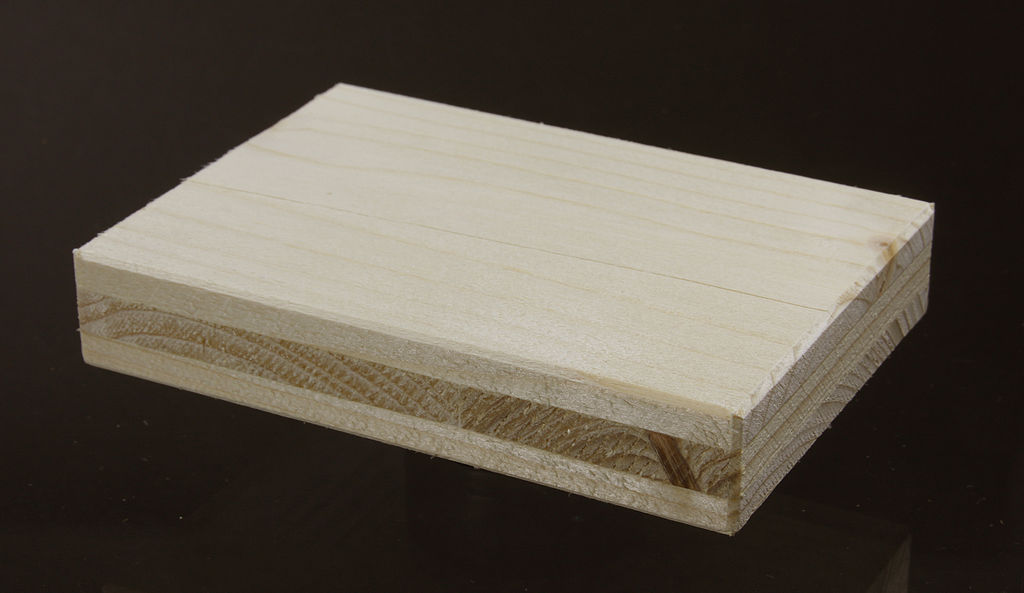

There are rules, then there are rules. So, if 1/4" is to be thought of as solid wood, then what about these wooden building panels?
3 or 5 or 7 ply, with 2x materials, These panels should soon exhibit self-dectruction by all the logic we have amassed here at Woodweb. Multi-storey buildings are being built in some parts of the world with these. Yet they do not self-destruct - Why?
Plywood. The cross grain movement of the wood can be dramatic. Splitting off stone in a quarry, for example. It is hard to deny. Yet some folks do deny those cross grain properties and go right ahead making these panels.
Now I see them everywhere as 3 ply 8" x 10" panels used by utility companies to provide a clean, clear deck so their heavy equipment can work around without churning up mud. The panels arrive in a stack about 6' tall, and the three-ply panels are lifted of by a fork lift and distributed around.
Cross Laminated Timber
9/24/19       #9: RE: Old Wood Veneer ...
A better way to get the image....
View higher quality, full size image (1024 X 593)
