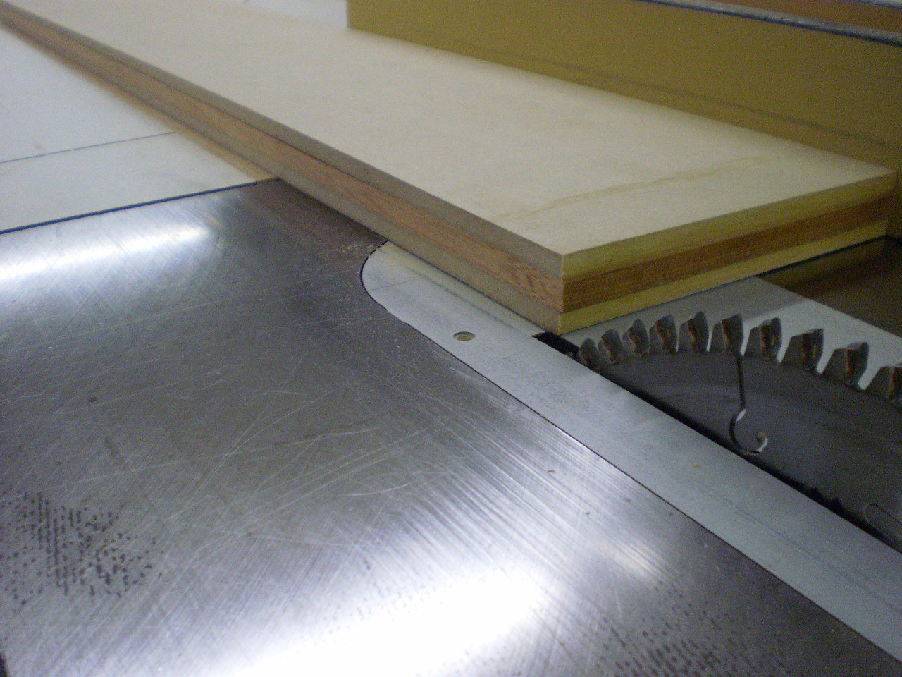

I use a negative hook TCG blade (plastic/melamine) which keeps the teeth more vertical as they go through the stack. I really don't get why someone would use an ATB blade for ripping a veneer stack, I get much better seams using a TCG.
I also sandwich the veneer to cut it. I use 1/4" MDF top and bottom. I (clamp and) glue the face of the stack ends to keep everything aligned and tight at the ends. I walk (hand over hand) the stack through the saw while maintaining downward pressure next to the blade... Wish I had an example of a bigger and more unruly stack.
