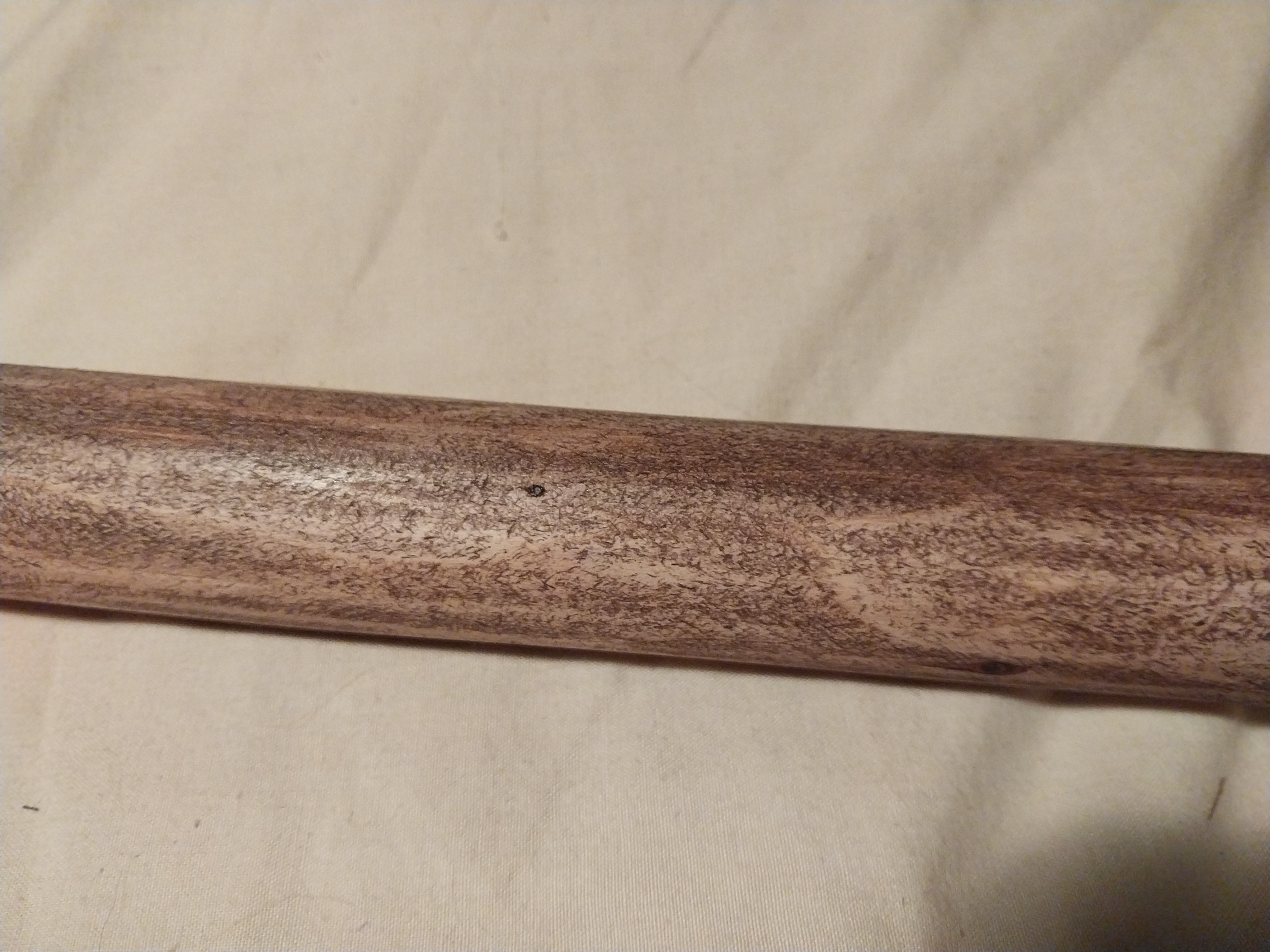

What grit would a person use when sanding cedar stays for staining them? I normally just lacquer them after scraping off the bark, and use 60 grit to 80 to 120 and they look great. But recently started staining them, and I think the grits must be different because I'm seeing tiny little marks/swirls I think from sanding with my orbital maybe? I cant see then till I put the stain on. Some stain just fine, and others not too good which doesnt make sense either.. What am I doing wrong? Thanks in advance..

120 grit is not fine enough for staining a soft wood. Try going all the way to 320 grit. 120, then 220, then 280 and finally 320.

Hi Janet, the reason your seeing swirl marks is due to the orbital sander, you need to get a "random Orbit" sander. Your not seeing these swirls when their not stained, because there is no added color to the wood, therefore, the added stain color brings those swirls out, but does not when no extra coloring is being applied to the bare wood.!
You can see this in almost all woods if an orbital sander is being used. They go in a circular motion, where as the "random orbit sander" (ROS) goes both circular and straight line, which eliminates the swirls.! So if you plan on staining any wood, especially soft ones, you should invest in one.!

When you sand cedar wood, for better results, use the following grit:
1. Preliminary grinding: Use a coarse grit, such as 80-100 purpose sandpaper or emery cloth, to remove the rough part of the surface of the cedar wood and the bark.
2. Intermediate grinding: Use a medium grit, such as 150-220 grit sandpaper or emery cloth, to further smooth the surface and prepare it for painting or dyeing.
3. Detailed grinding: Use finer grit, such as 320-600 purpose sandpaper or emery cloth, to remove the marks left during the grinding process and make the surface more smooth.

320, minimum.

When sanding cedar stakes for staining, it's essential to choose the right grit to achieve a smooth finish without leaving behind swirl marks. For staining, consider starting with a higher grit sandpaper, such as 150 or 180, to minimize visible marks. Additionally, ensure your orbital sander is clean and in good condition to prevent any unwanted patterns. Experiment with different grits to find what works best for your staining process. Happy woodworking!
