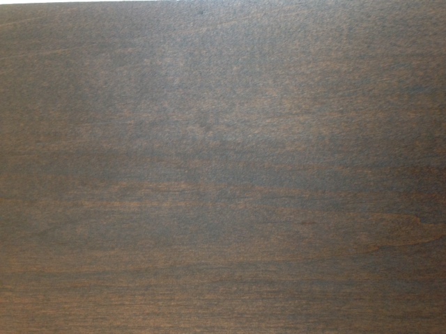

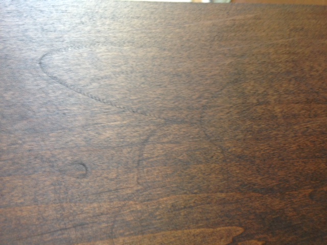

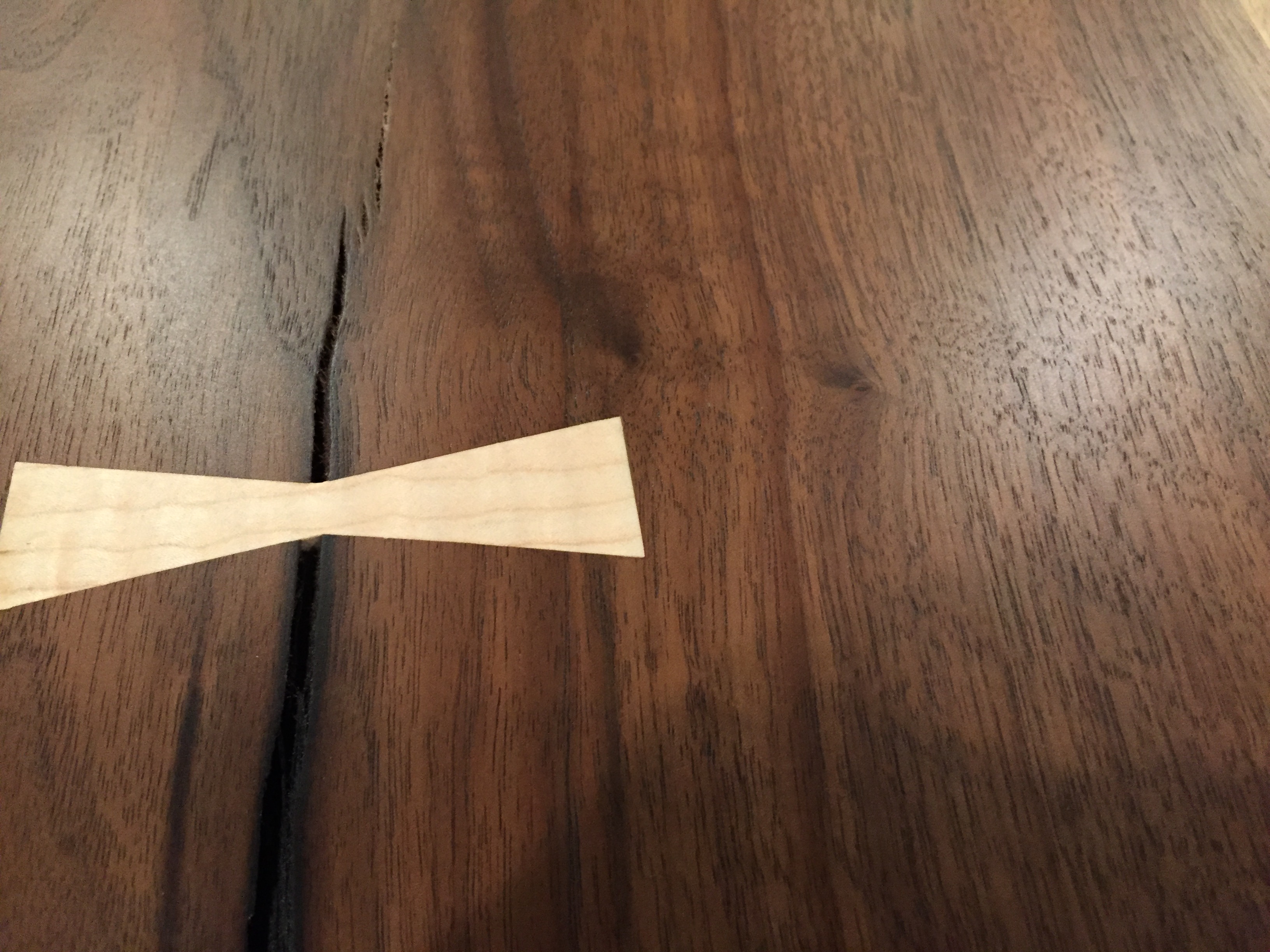

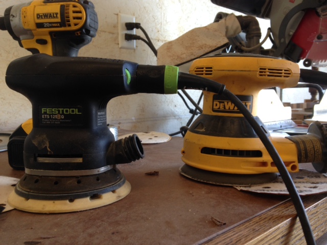

  Just so you guys don't think I'm crazy. Here are some photos of the terrible swirl this festool leaves. 180g festool paper, very little to no pressure, barely moving this is the result.
The last pic is after I cleaned it up with my $60 dewalt ROS. Quite a difference. Any thoughts on why this thing is sanding so bad. It is not operator error, I assure you.

  Looks like you have a woodchip between the backing pad and sandpaper. That mark is not directly sander related.
10/22/16       #22: Sanders at the bench ...
  Nope Peter...this sander does this with any paper, any situation. Sanding pad is clean, unless there is something under the hook and loop pad which I don't see how that could be. It is a mystery to me.
10/22/16       #23: Sanders at the bench ...
  Tell festertool you want your money back.

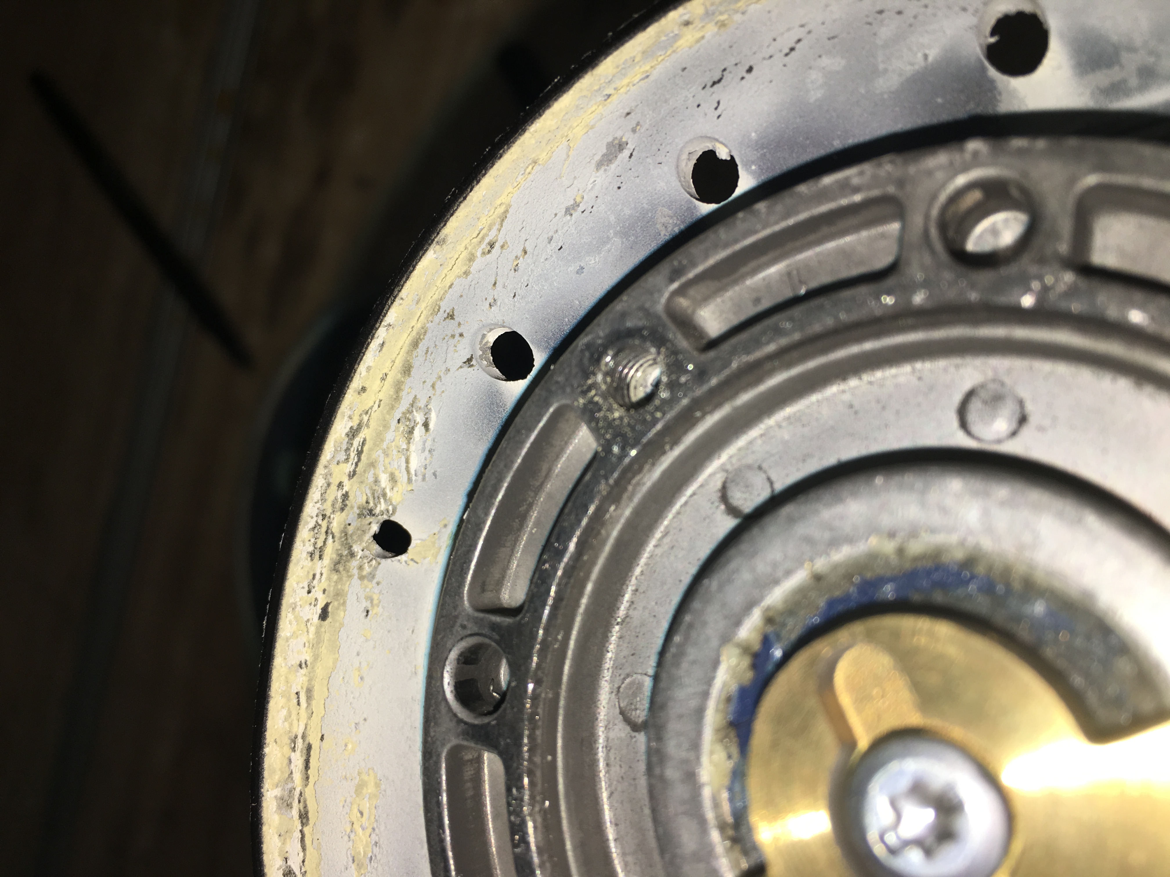

  Side note, I picked up my 125 festool sander today and one of the screws holding the pad fell off. I went to put it back in and tighten the other screws only to find the threads in 3 of the 4 holes are completely stripped. Anyone else had this problem?
