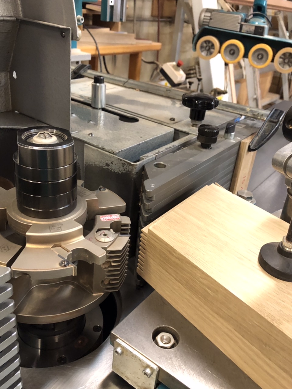

Joe Calhoon Member
I’ve used a Garniga adjustable end grain finger joint cutter for 20 years. Thickness range is from 14 mm to 96mm.
The Zuani one that Rangate sells is similar. The joint strength of these is pretty amazing. On a 68 mm thick segment there is about 5” of two sided long grain glue surface.
Mark, for Stark inserts have you tried AMS in the UK? I have bought other items from them and the service seems good. Also the Felder tooling is made by Stark. I have never had issues getting inserts from them. Specific to the cutters they sell though.

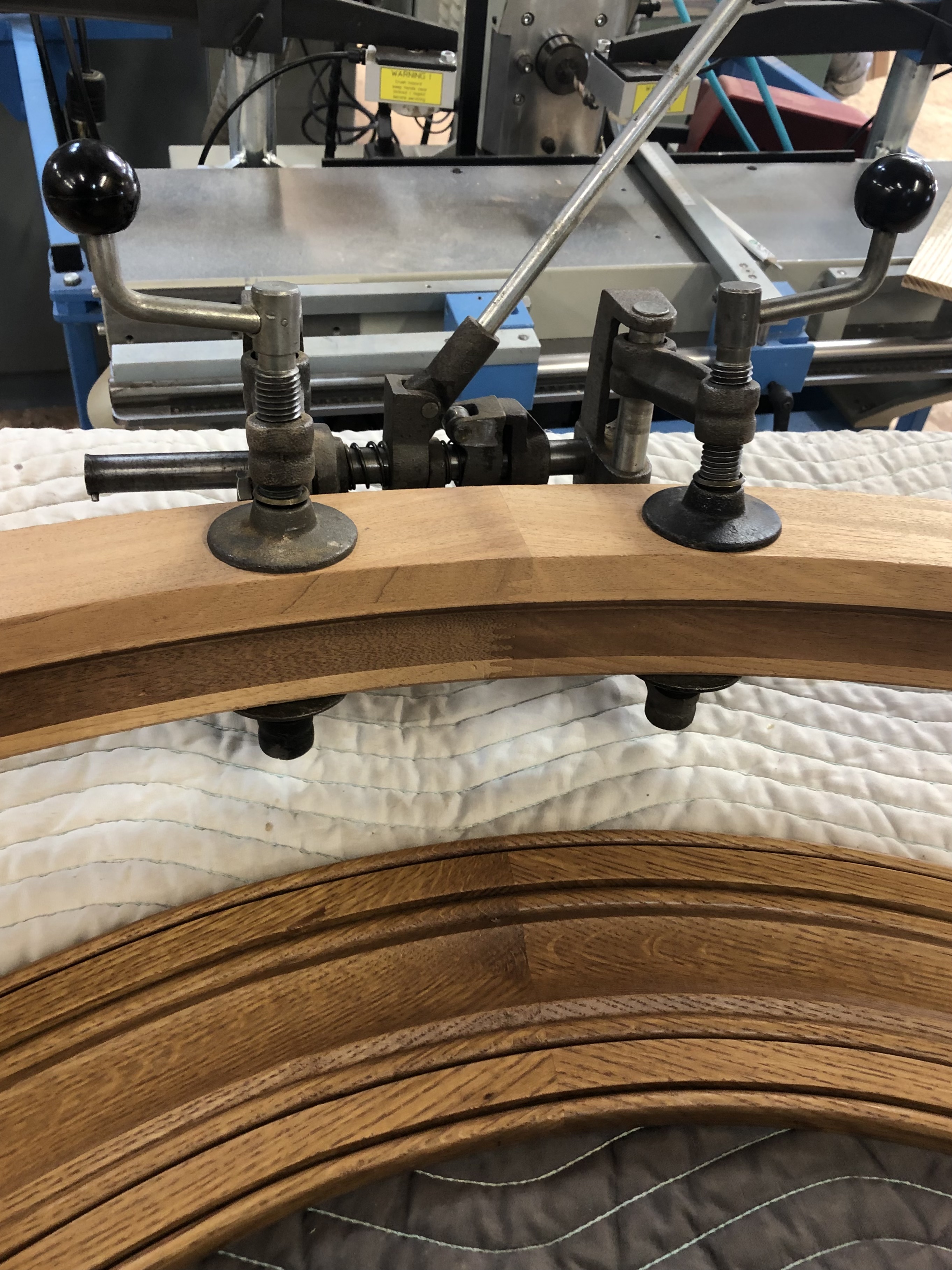

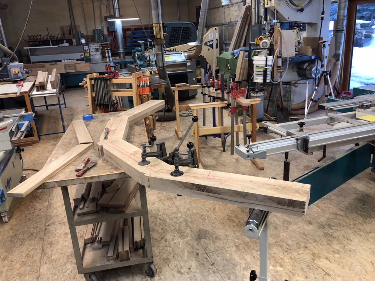

Al
I can’t help you Mark but Joe that is some slick clamp in your last picture. Looks like you tighten the clamps on both sides of pieces than throw the lever to bring them together.

Al,
That’s exactly how this clamp works. I had a pneumatic arch press that I sold a while back in a downsizing move. This one works about as well.
