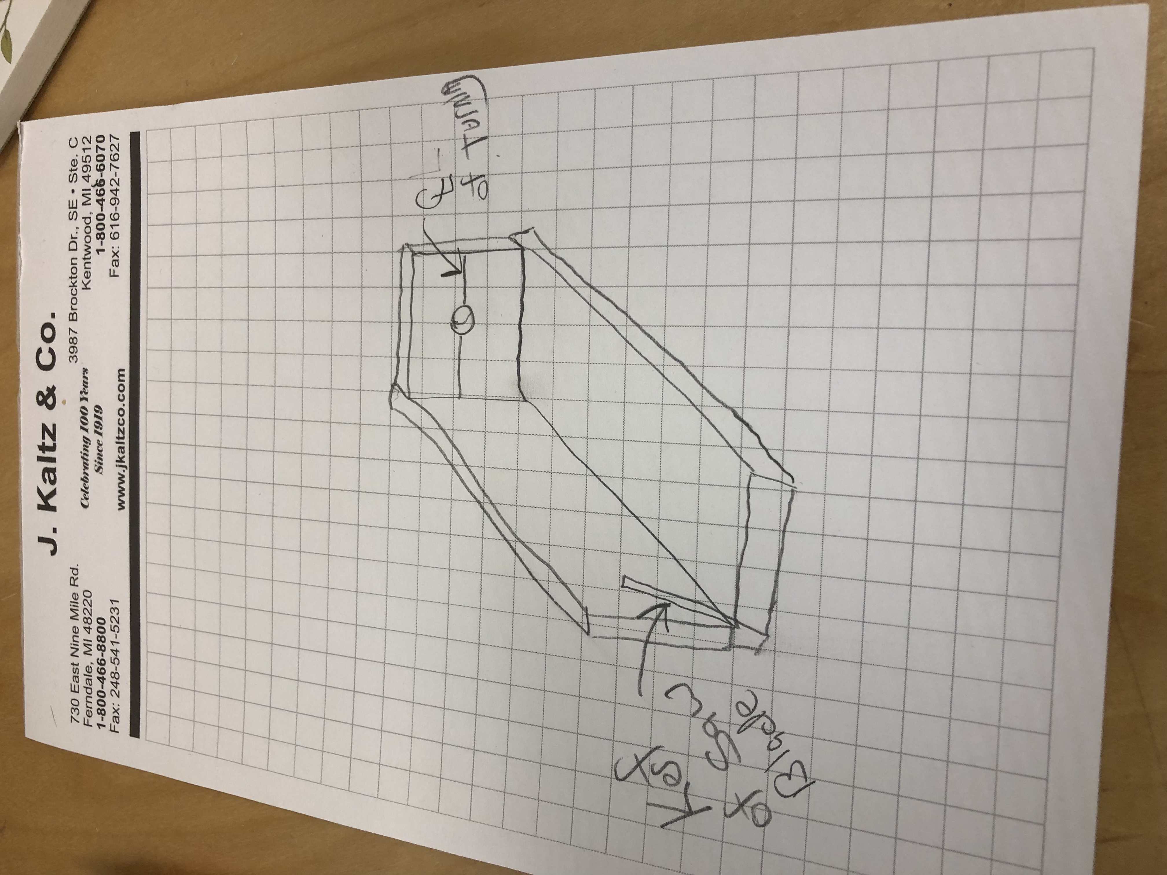

3/20/23       #6: Balusters angle cut ...
Matt Calnen
45 degrees on a 6” turning is going to require a 12” blade.
With the narrow top, you will need to build a jig to hold the baluster level. Maybe something like this drawing. Extend the center line to the outside of the jig. Make a center line on the top of the turning and just line them up. If you’re careful it should be close enough. I assume these are paint grade?

3/20/23       #8: Balusters angle cut ...
Matt Calnen

Matt,
Thanks for the drawing. I believe we can do this. Not sure if the customer will like our price.
