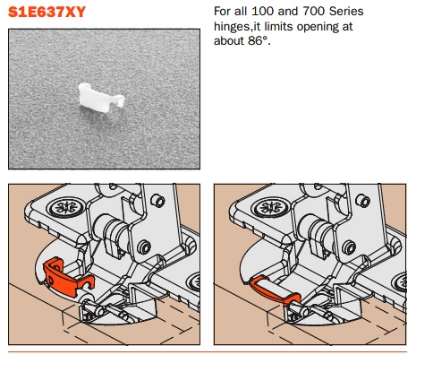

Al
I’ve used these before but Hafele has them listed for 105 degree not 110 degree. Frameless style hinge with soft close. Need item number.
Thanks,
Al
12/14/23       #2: Salice restricter clip for 110 degr ...
Hi Al,
The same clip is used for both the 105 degree and the 110 degree Silentia+ hinges. It limits the angle to 86 degrees.
Item: S1E637XY
Regards,
Dennis bean
Salice America
12/14/23       #3: Salice restricter clip for 110 degr ...
This is the clip.
View higher quality, full size image (484 X 415)
12/14/23       #4: Salice restricter clip for 110 degr ...
Al
Thanks always Dennis.

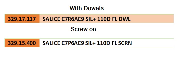

12/14/23       #8: Salice restricter clip for 110 degr ...
Al,
Here are the Hafele item numbers. They have plenty of the doweled version in stock.
Dennis
View higher quality, full size image (644 X 205)

12/14/23       #10: Salice restricter clip for 110 degr ...
They have 20,000 in stock with dowels. Please see my previous reply with the Hafele part numbers
12/14/23       #11: Salice restricter clip for 110 degr ...
Al
That number works. Don’t need 20,000 just 19,750!
Thanks Dennis
