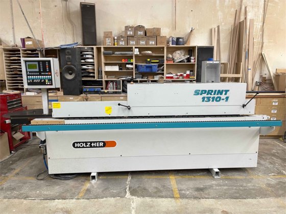

Hi There
This is my first post on this forum. Very grateful to find this industry resource.
I cannot work out why my edge feed is not working anymore on my 2003 Sprint 1310-1. The pressure roller is working but not the electric motor belt feed. The screen does say that it is on.
Any thoughts would be appreciated.

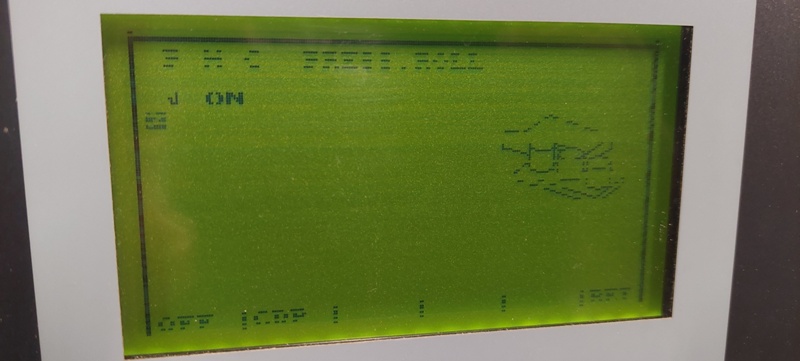

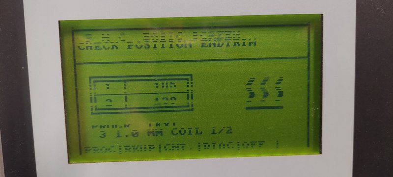

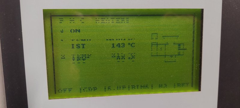

Also I have another problem with the 1310-1.
The control screen has lines missing which makes it hard to read the numbers.
I sent an enquiry to my Holtzher spare parts supplier here in Australia and they said they were told that Holtzher is not repairing or replacing them for this model anymore. He did say that he would pass on my request to them but indicated it probably wouldn’t go any further. I have seen on YouTube people fixing these. Has any one got any other ideas that I may pursue?

12/4/24       #11: Edge feeder not working on Holtzher ...
Jim Herron
When i was looking at purchasing a later model bander, and found one that had the screen like yours, Richard, at Bayside Industrial had one on stock
The price seemed fair enough.
I wound up not buying the newer bander after all, and he help me repair my current HH

12/7/24       #14: Edge feeder not working on Holtzher ...
TP Member
Hi Jim
Richard said he has a new screen to sell me which is fantastic news. Thank you for the lead.
