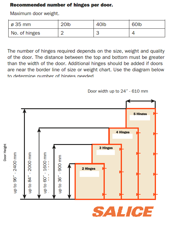

Scott,
Here is a chart for the recommended number of hinges required based on the door size and weight. This is based on doors up to 24" in width. This is from the Salice catalog but other brands would recommend similar. 5 hinges.
Dennis
View higher quality, full size image (588 X 764)
