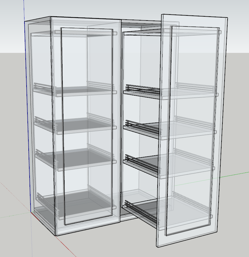

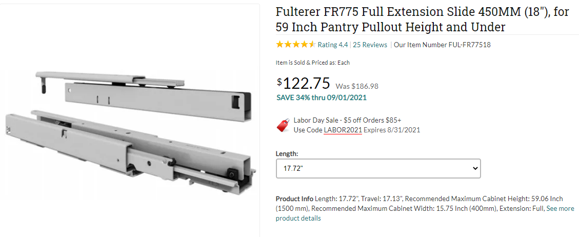

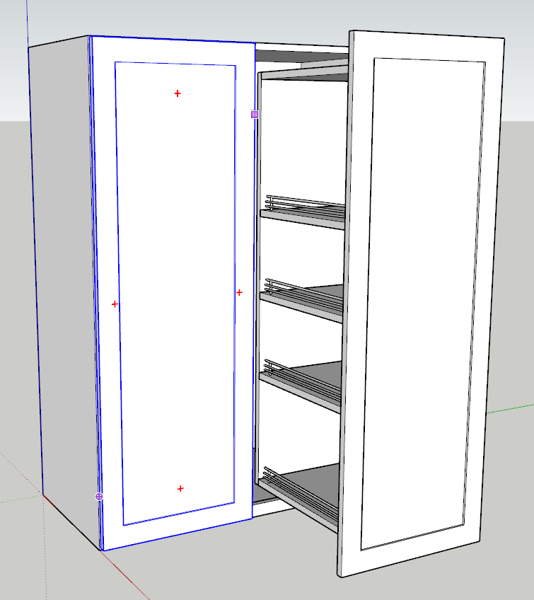

Here are concept images of something we want to do. A 37w x 18.5d x 54h cabinet sits atop the counter, and has twin pullout shelf units.

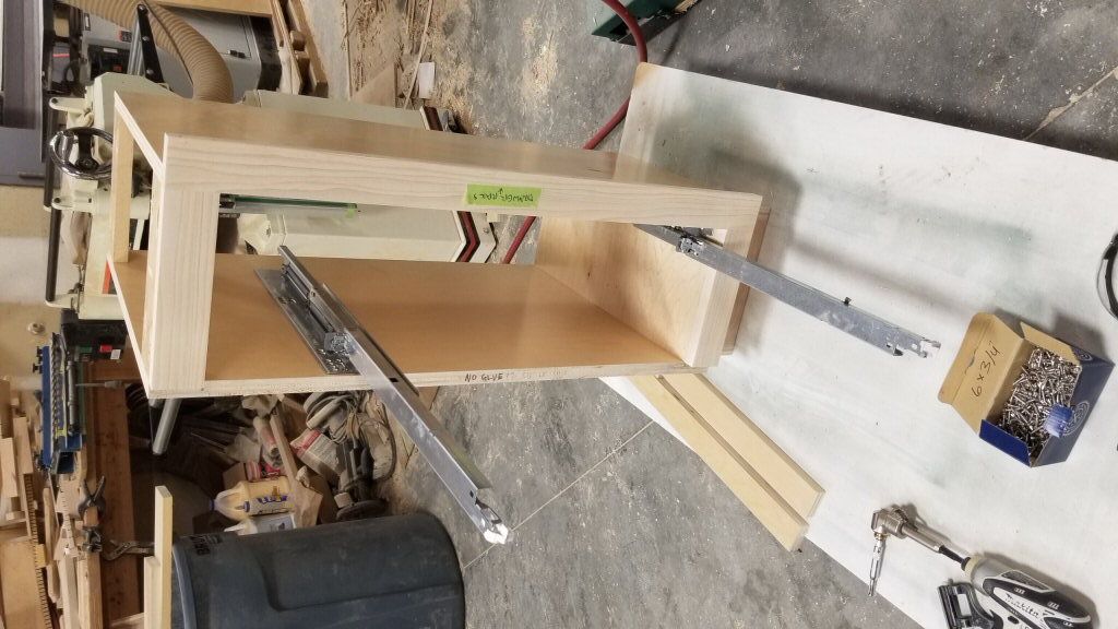

The Fulterer slides are used. Pic attached.

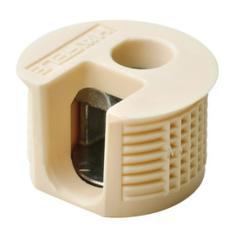

The pullout has a back, top, deck, and three shelves. Joints are lock dado to the back, and to the door, we propose to use Hafele Rafix KD/RTA connectors.
Pullout shelves are all about 16x16. The pullout (not its door front) is about 49" high.
The pullout will rely on the Fulterer slide assembly, bottom full ex slide, and top trolley, to keep it from racking.
If you have experience with something like this, tell us what we can expect with this arrangement, and the Fulterer hardware.

Additional images attached.
We design with Chief Architect, and do the cabs fab using eCabinets, sending the cutting to a CNC shop.

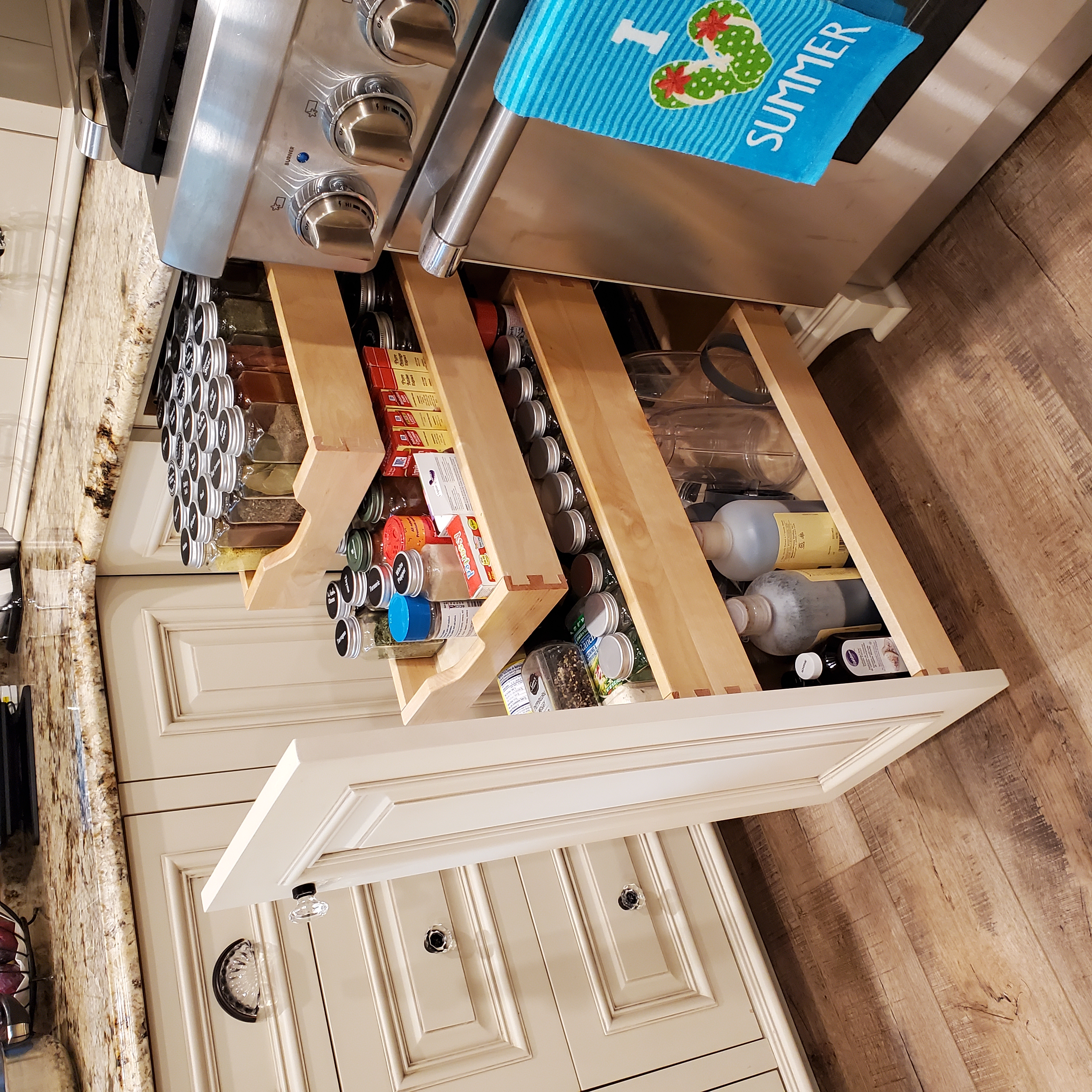

This picture shows how I do my base pull outs . It requires 4 undermount slides but that costs less than the fluterer unit , offers adjustment and the construction is as simple as drawer boxes and roll outs .
Also allows much better access to the items on the shelves and you don't have to pull out such a heavy load every time you open the door.

Those two bottom drawer boxes are attached to the door.

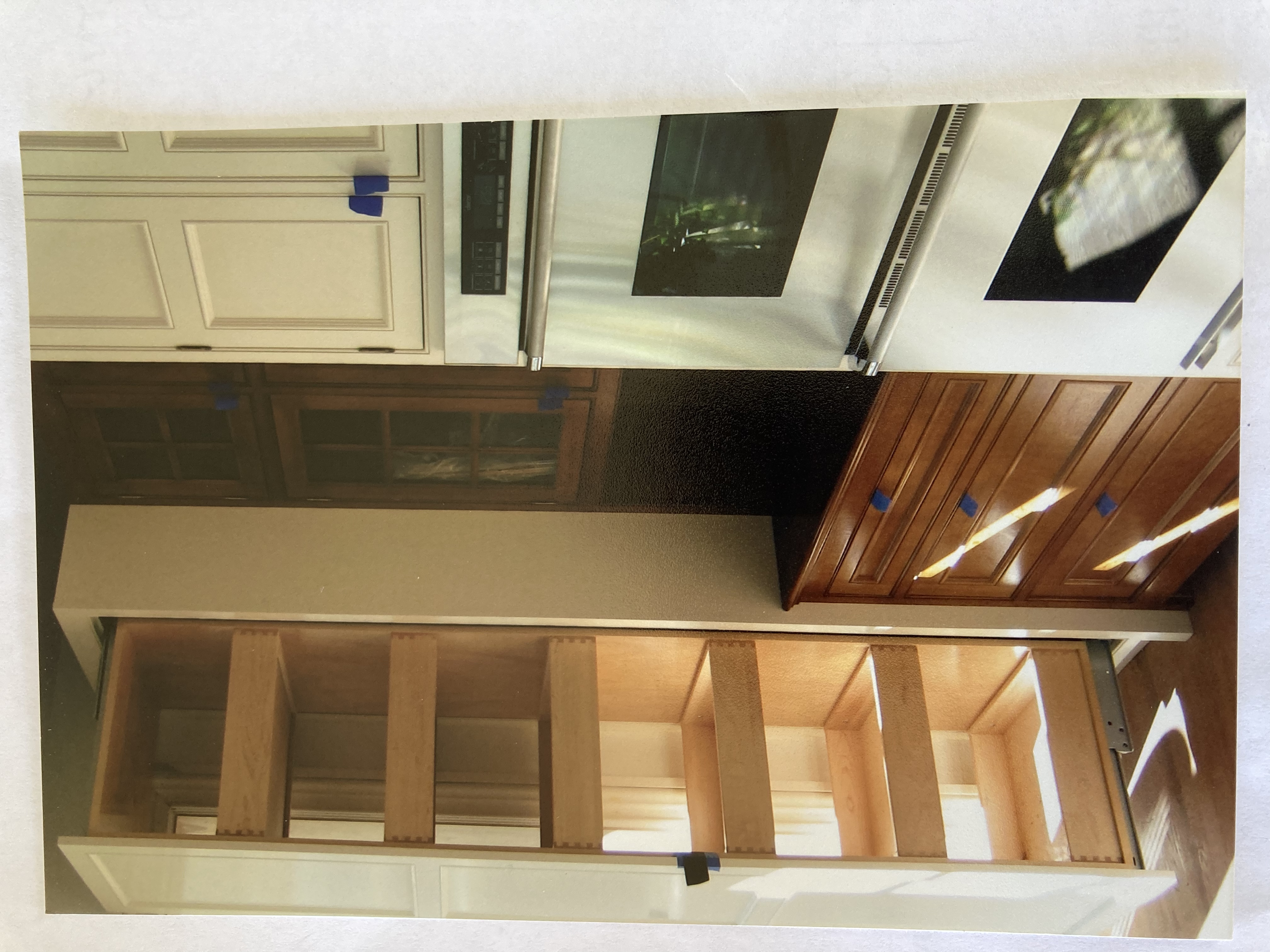

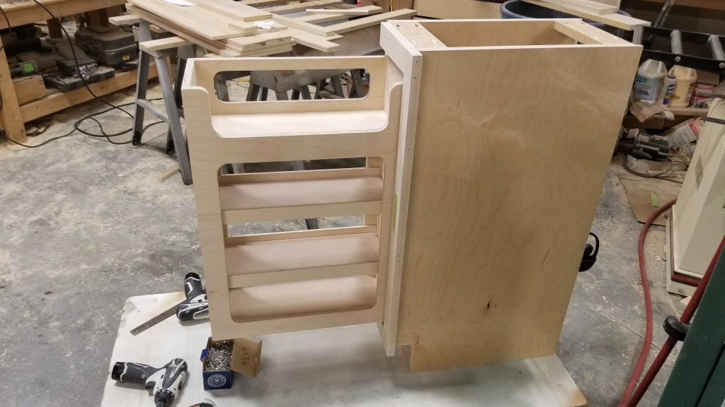

I’ve got the ideal example for you. This pic is from a kitchen I designed & built in 2005. I used the Fulter slide. It was their heavier duty full extension slide. It cost about $200 back then.
That’s a 10’ ceiling the cabs are about 9’. I added the built up crown later. Its 24” wide x oven deep. Those are typical 5/8” dovetail drawers held together with a 3/4” maple ply frame. The whole kitchen is beaded ff & inset doors. I never adjusted it after install. I went back to that house 10 years later and it was still perfect.
I just took a pic of a real photograph, hence the odd border.
Those slides get 2 thumbs up

I was very pleased with how it came out. It was a bit of a gamble. I had never seen someone do it like that. Likewise, I had never used the slides and none of my buddies had either.
I screwed the drawers in with 8 screws per side. You could move one drawer at a time and refasten it. We never bothered. Because its oven deep and tall there is a ton of storage. Make sure the customer keeps the heavy cans on the bottom shelves. I think I spaced the shelves cereal box distance apart.(lol)
I figured worse case scenario if it didn't work, I could mount each drawer with full extensions and hinge the door.
