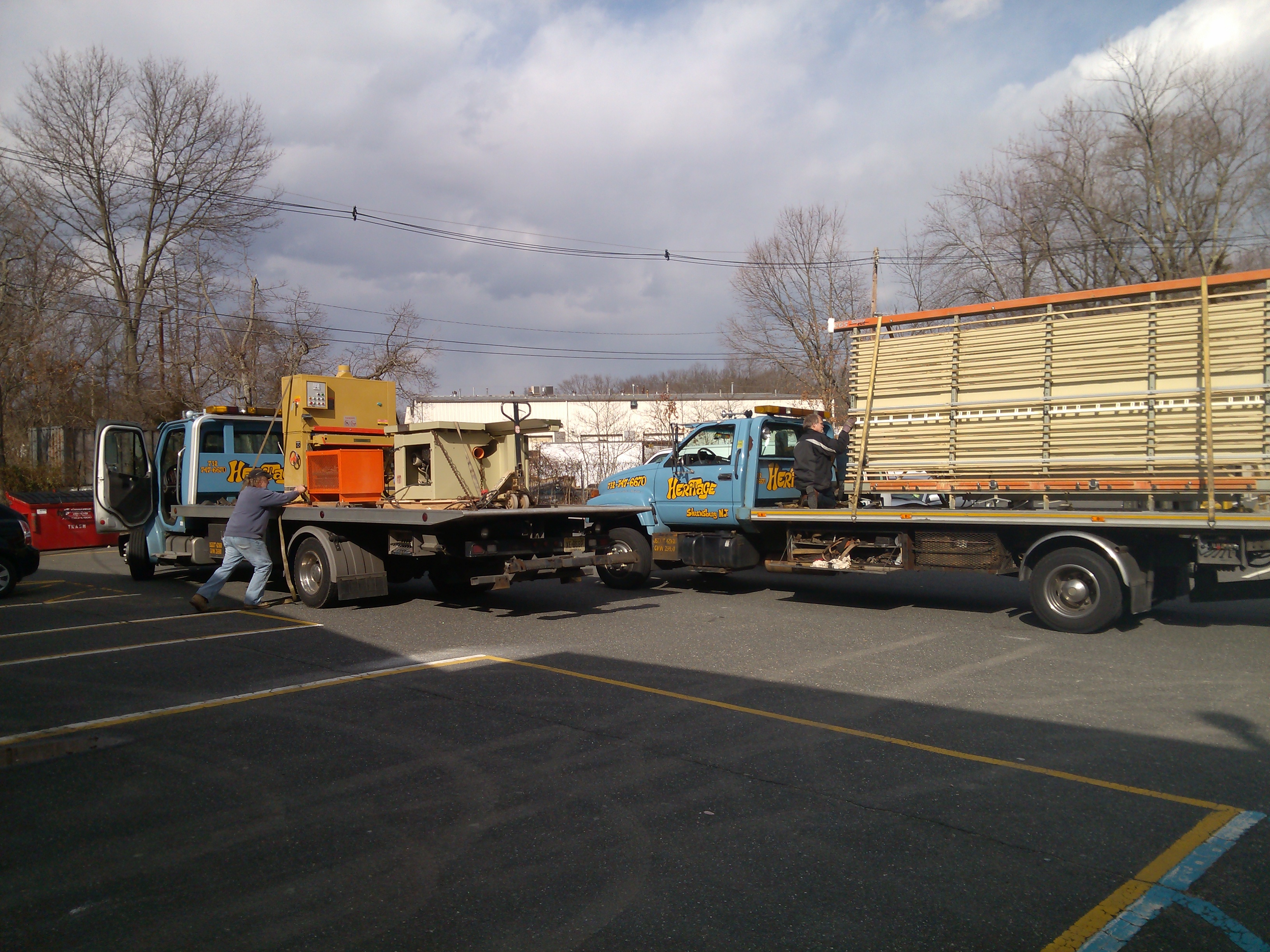

Tom C
Made it's own Custom Skid,Pallet jack , Winched on to flat bed towing truck...
View higher quality, full size image (512 X 384)

Thank you Mark B, Tom C and Bill for the comments and ideas. Tom C, that looks like a big move.

about to move my own slider (if all goes well with the negotiations) and wanted to thank you for asking the question Tom & and to you Tom for giving me the perfect solution with the prefab'ed pallet skid. Will surely beat my existing plan of straps and crossed fingers. Cheers!
