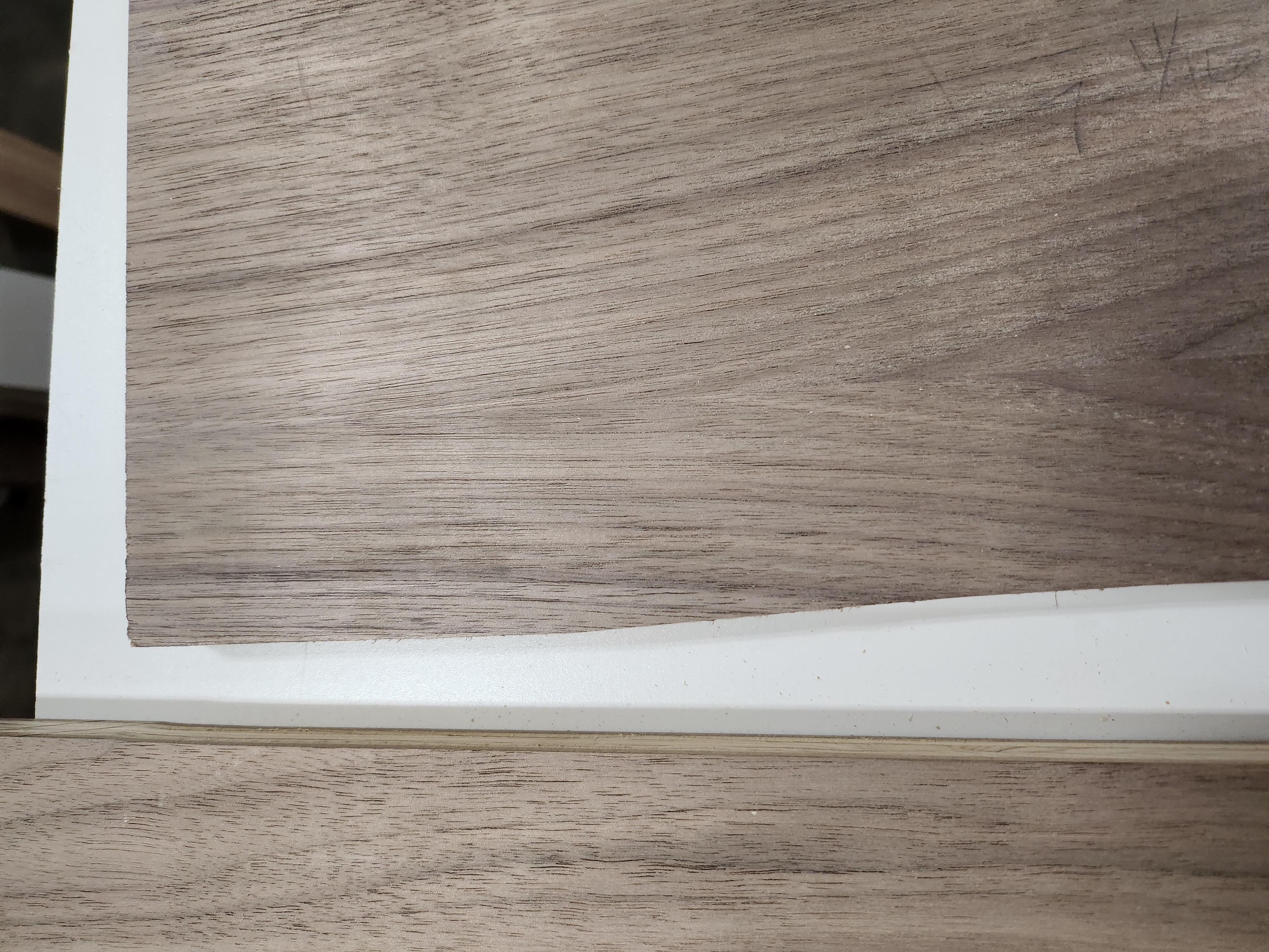

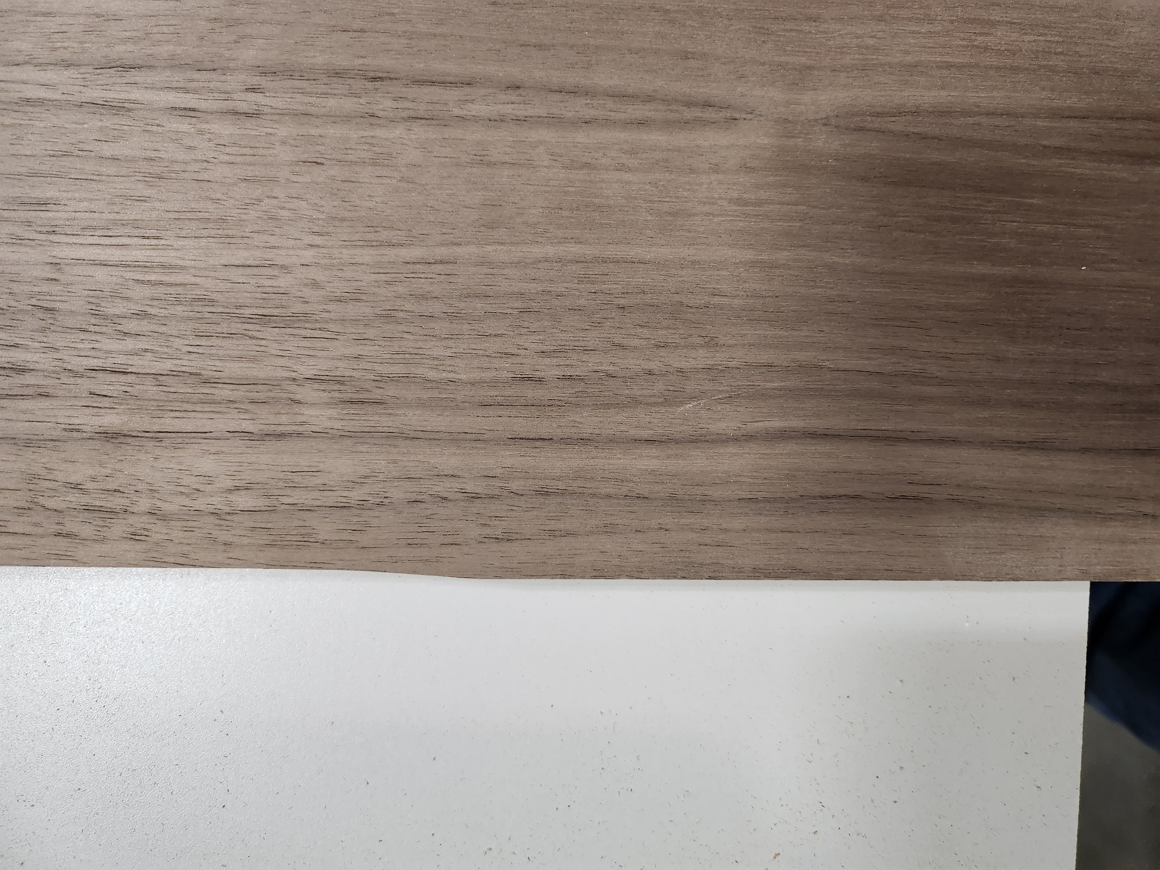

Hello I have been having issues recently with my 1558 Accura edgbander not pre-milling the full board. about the last 1 5/16 is not being milled off and I have adjusted as much as I can. It was originally only pre-milling half the board as the pictures show. when watching the parts go through the machine its as if the pre-mill pulls back the last quarter of the board and that's what it leaves over. has anyone else ran it to this issue with a similar model? the techs cant be here for at least 2 weeks and was hoping for a solution that doesn't require me to stop production for a couple of weeks.

Kind of a shot in the dark but based on what I’ve dealt with on mine it almost seems like your second trimmer isn’t engaging to the panel. One cutter does the full length of the board and then the other one is reversed to do the last 1 1/2” do prevent blow out and it looks like it’s not engaging or out of adjustment.

The first premill moves in and out. The second one is fixed in place. The second one should only be cutting material for last approx 1.5” of the board as the first one should retract at that point. It sounds like your first cutter is doing all the work and when it retracts, it’s leaving the back 1.5” uncut. The solution would be to adjust your second head to be out as far as the first head in it’s “out” position. OR (if you have exhausted the adjustment of the second head) to adjust the first head to only come out as far as the second head is.
