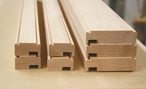

Have you considered using the method used by many of the largest cabinet manufacturers and start with stiles and rails made from molding with a groove for your side panels, bottoms and fixed shelves? Most of these companies make the face frame first and fit the box components to it, rather than the other way around.
View higher quality, full size image (500 X 306)
Hoffmann USA article on How to Produce Profitable Beaded Face Frames
