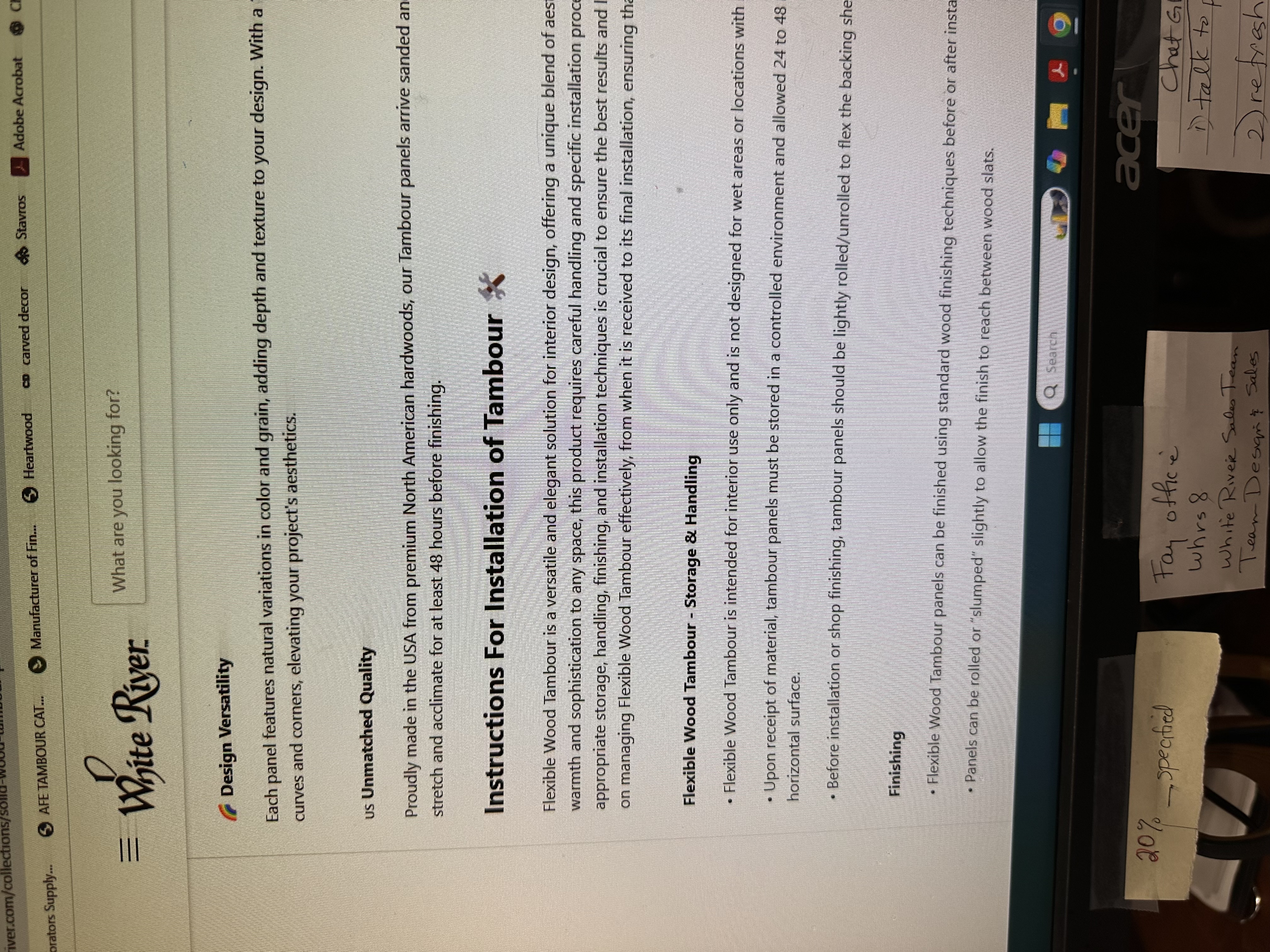

I just spoke with white river yesterday and they have premade 1/4" thick solid 24x46" reeded and other profiles. See pics.
I'm suspicious though. Personally, I don't understand how you can glue a panel to one side of a substrate and expect it to not warp, or the solid reeded to not crack when it tries to expand.
We've glued tambour to parts that aren't doors, but that's it. I get Instagram pics of this from designers and ask myself if it looks good on a pic and then self implodes a week later or ??? Milling reeds in HDF for paint grade could work, but then, wouldn't the panel be unbalanced again as well?? I'm curious how people achieve this with doors.
