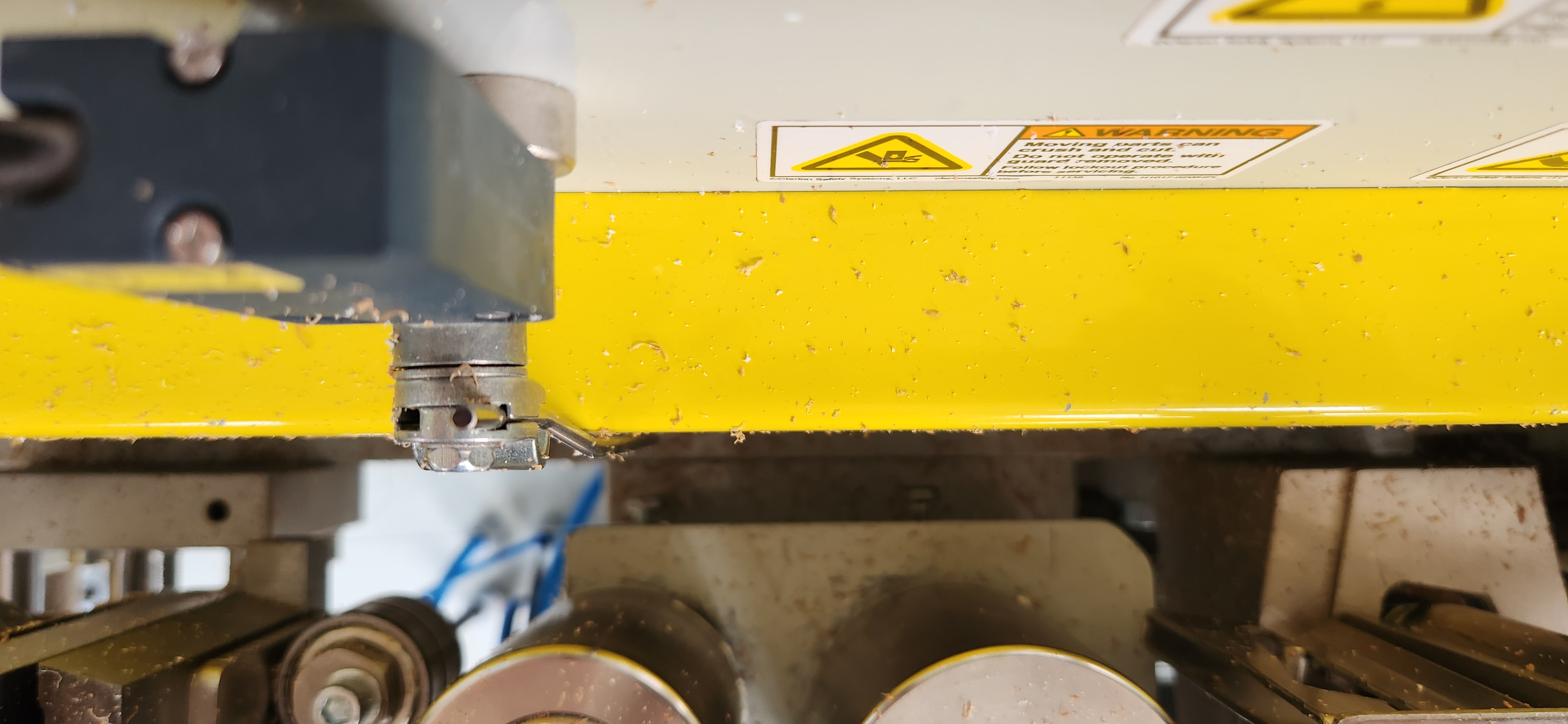

I have loaded .5mm pvc edge tape in my mikro+. The tape seems solid but the face has waves or a wavey texture on it.

Do you have premill?
What does the glue application look like if you peel the tape?
7/22/26       #4: Edgebanding wave ...
Something Member
No premill on this machine.

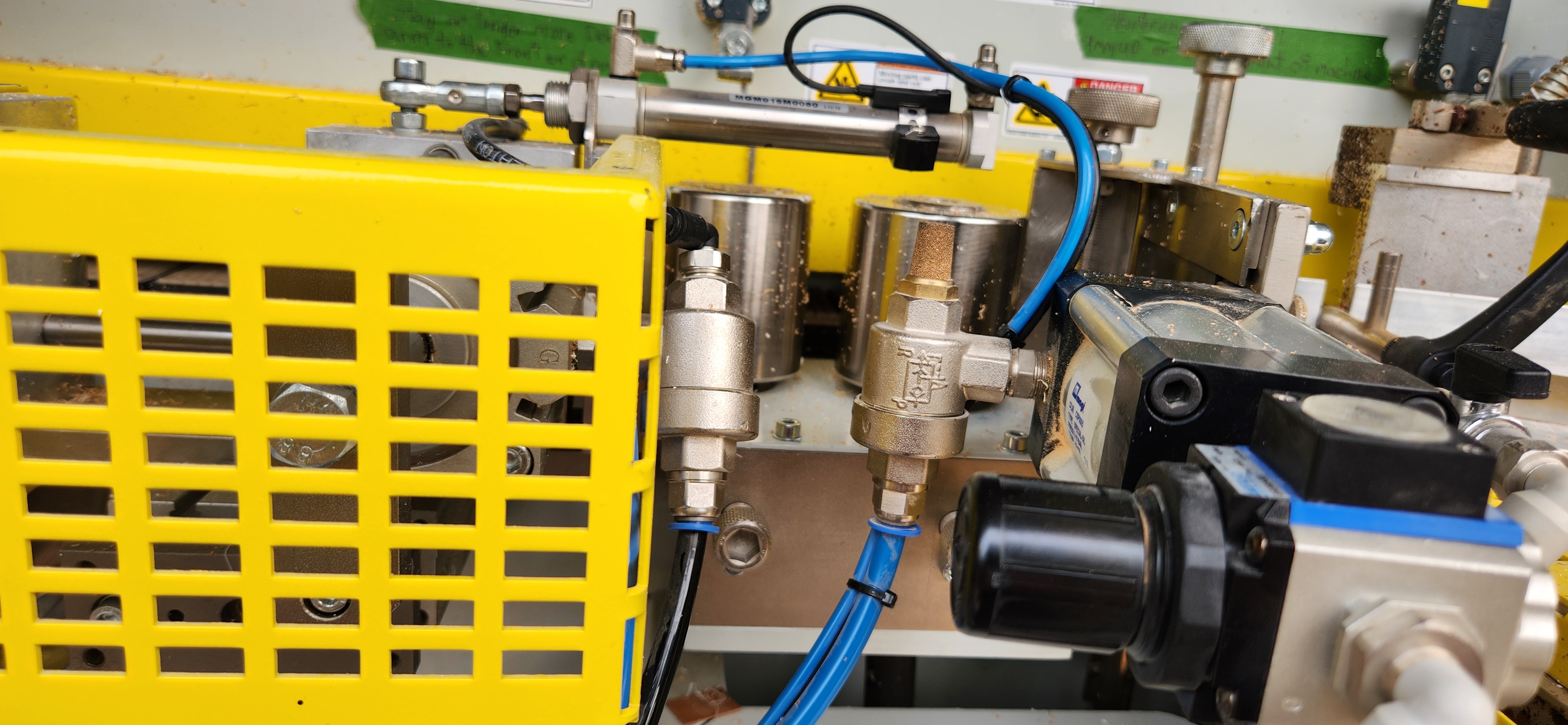

Here are the pressure wheels. The drive seems to be set to 0mm clearance without edgetape as in with .5mm edge tape it wound push back .5mm and with 1mm it wound push back 1mm. The second wheel is 1mm proud before edge tape.
View higher quality, full size image (4000 X 1848)
7/23/26       #7: Edgebanding wave ...
Spin the driven pressure wheel and the idler to feel if the bearings are still good.
It looks like this is an SCM K201 or similar. There is a preload handwheel beneath the guilotine for the pressure wheels. Mine has about 5/8" of thread showing.

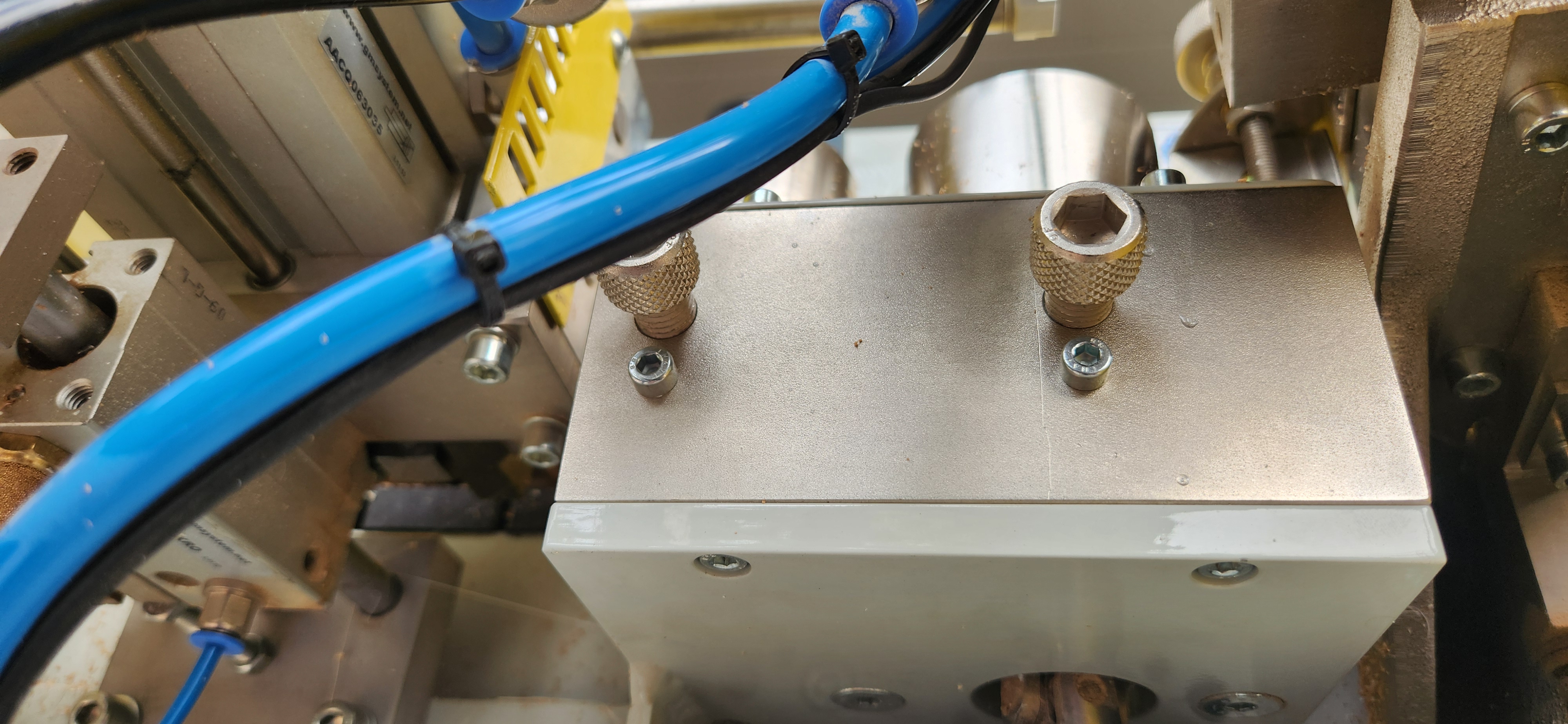

Mine doesn't have a handwheel it has to bolts on the outside that apply pressure through a spring and the adjustment for in and out are a bolt and lock nut on the inside. I have increased the pressure on the drive wheel to keep the wheel parallel to the edge. There is now about 1mm it pushes back on both wheels.

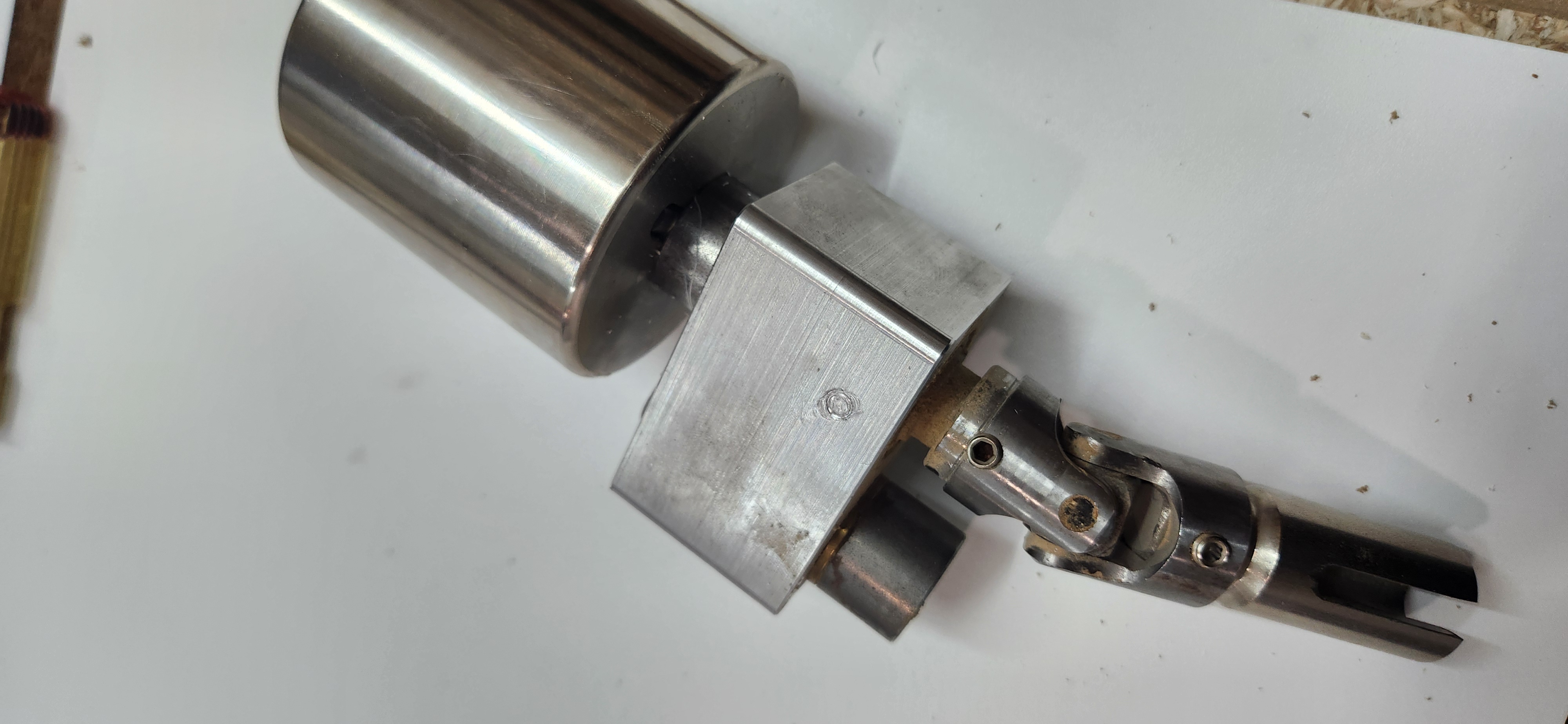

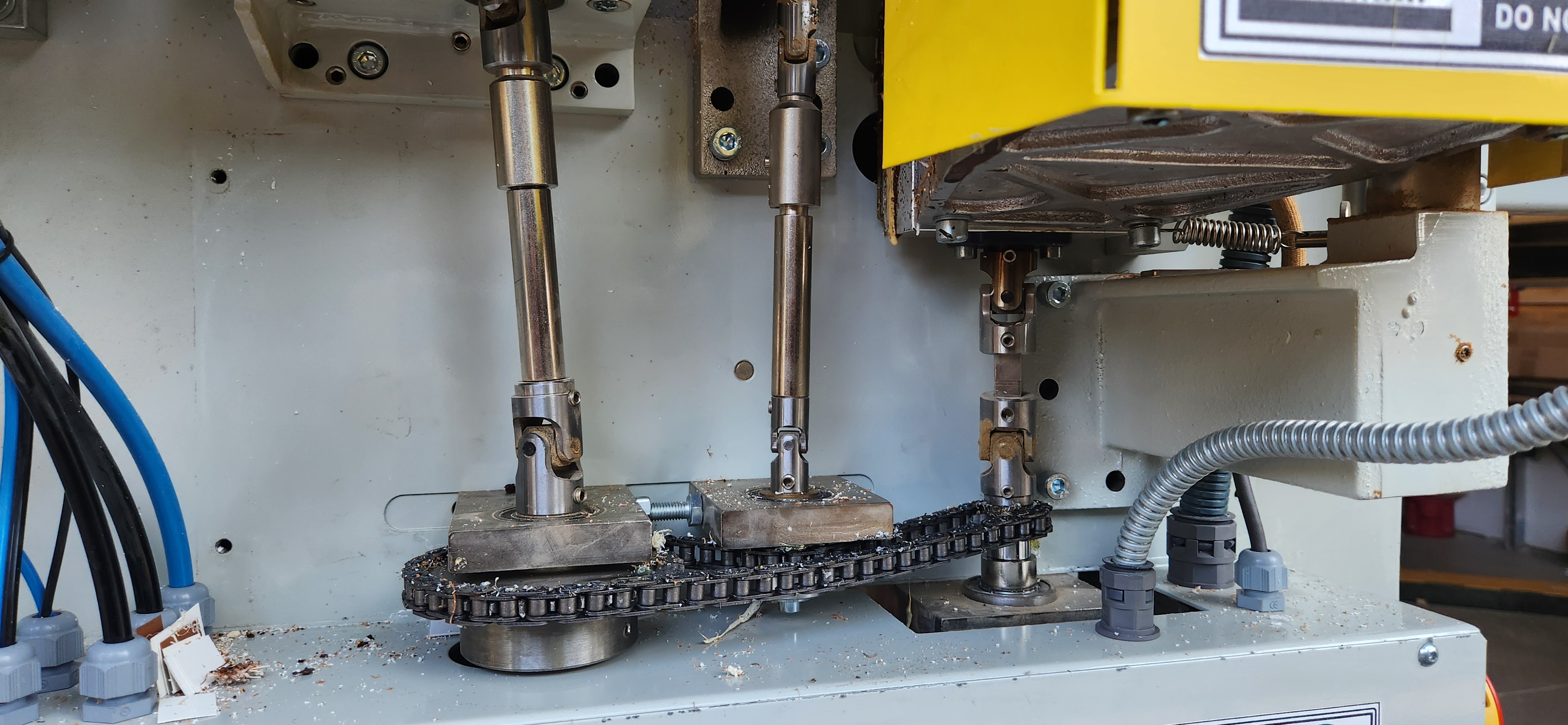

I dug down into the drive shafts behind the cover. I found one set screw that is missing on the glue spindle shaft. And the bearing connecting to the chain drive is loose
8/2/26       #11: Edgebanding wave ...
I wouldn't be too concerned with the chain slack. Better slack than too tight. The universal joints should get more grease. Run the machine and see if any of the universal joints are binding when rotating.

I think I see your problem! The central U joint is assembled wrong. The top U joint should be rotated 90° with respect to the lower joint. They are on the left and right assemblies. Universal joints are not constant velocity joints so when assembled wrong will cause jerky motion
8/5/26       #13: Edgebanding wave ...
Something Member
Thanks, I will change that tomorrow when I replace the chains and hopefully see an improvement.

I just had a closer look at the photos from before and I missed that all the U joint assemblies are wrong. The missing grub screw is a clue that this has been apart before. The yokes of the U joints should be oriented 90° to each other on the shaft. Otherwise the rotation speeds up and slows down twice every rotation. If you measure the distance between the waves on the tape I bet you will come up with half the circumference of the glue applicator.
