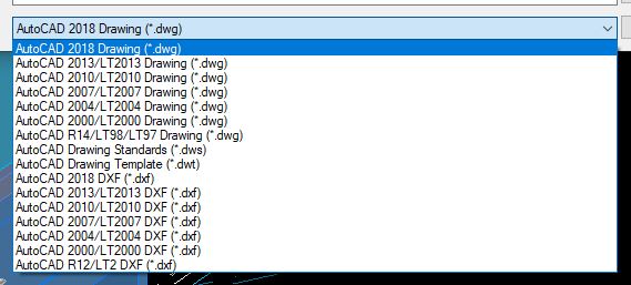

You should be able to use any version of AutoCAD. Would just need to save the DWG or DXF file back to an older version. (See attached JPG)

Rick Member
The problem we're having is we were using Autolink to communicate with the old Busellato and the Autocad 2008 had a "tool palette" tab for setting tool parameters, both of which are gone in 2025.
