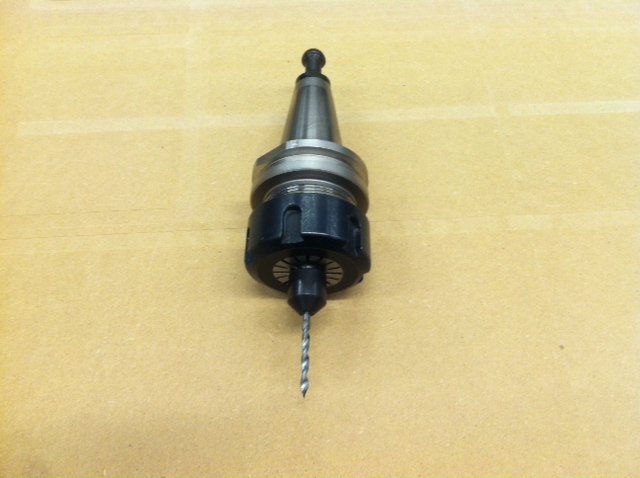

For pilot holes I use a 3mm solid carbide bit. Spindle speed is 9000 rpm. Entry speed is 150 ipm. I do not peck drill. It is a waste of time on wood. I get me bits and bit holders from True 32.com I hope this helps.

Am I reading you right, 9000 rpm?
Are you using a tool holder and your spindle?
5/22/15       #5: 1/8 drill ...
Chris Harmon
Website: http://azurecabinets.com
Yes, 9000 RPM is correct. Yes, using tool holder and spindle.
You do not have to use the tool holder if you have the right size collet.
View higher quality, full size image (640 X 478)
