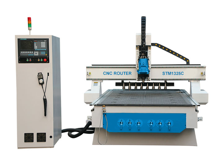

Nick Member
Website: https://www.stylecnc.com/cnc-wood-router/
May i know what model of CNC machine do you use?
For upgrading machine, we have the ATC system CNC machine, the linear auto bits changer follow with spindle, it can catch 8pcs different CNC bits for different work, no need to change bits by hand,
View higher quality, full size image (720 X 540)
Affordable Linear ATC CNC Router with Au
