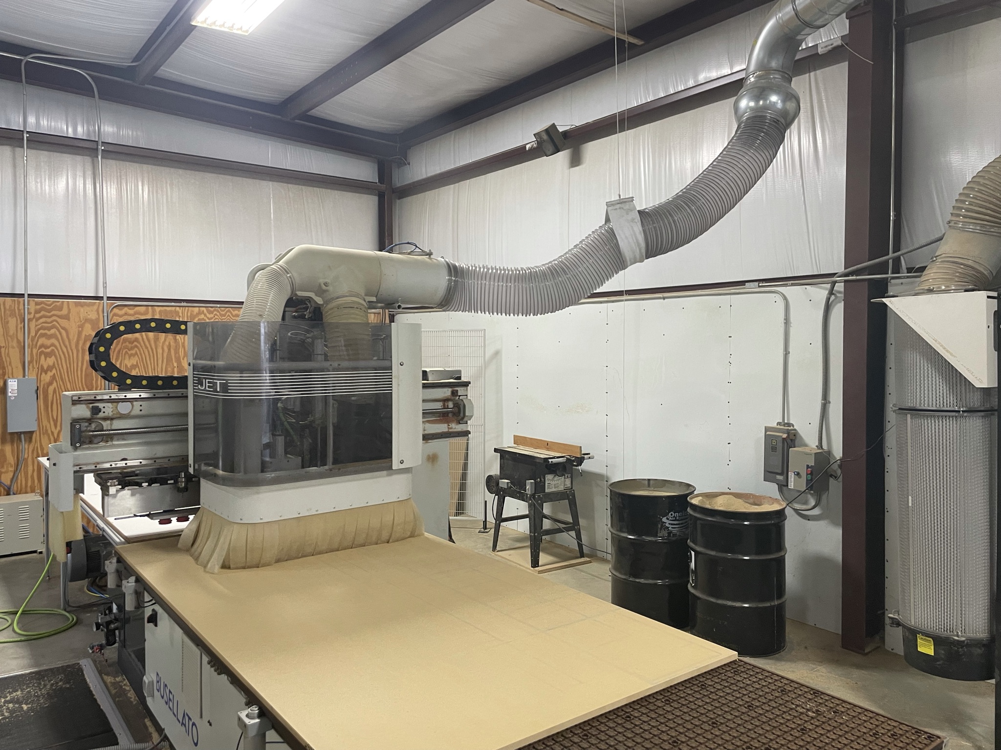

The past few years I've noticed that flexible dust hoses hardly last anymore. On both my edgebander and CNC I'm getting maybe 2 years before they start splitting.....even on hoses that are connected to nonmoving ports.
Our CNC is hardly 2 years old and there's a lot of splits.
We route mostly plywood and melamine, and I know the melamine can be abrasive, but this seems to be getting ridiculous.
These are the expensive copper-coiled static dissipative hoses, I'm pretty sure the CNC came with Urethane hoses.
For longevity, what should I be buying?

I amusing neoprene coated nylon fabric hoses now. So far, so good. I attached a link. The link I attached is for 12", but I think other sizes are available. Some hoses last, others are junk.

One of our CNC hoses is 10 years old. It is the quality of hose you are using.
We get ours from American Blower in Michigan. I explain the function and they recommend the hose. We have had good luck.
I do have one spot where our main collector connects to the dust dumpster that seem to eat hoses. That is our only hose issue.

We get hose from Wynn Environmental. 30 Mil clear urethane. Holds up well on router/saws/planer etc.

Do you have a ball joint at the top? Is the center of the hose supported?

Flexhaust FlexThan LD is best, we provide with every CNC machine we install.
This flex hose collapses on itself but does not flatten. Will not interfere with axis drives.
