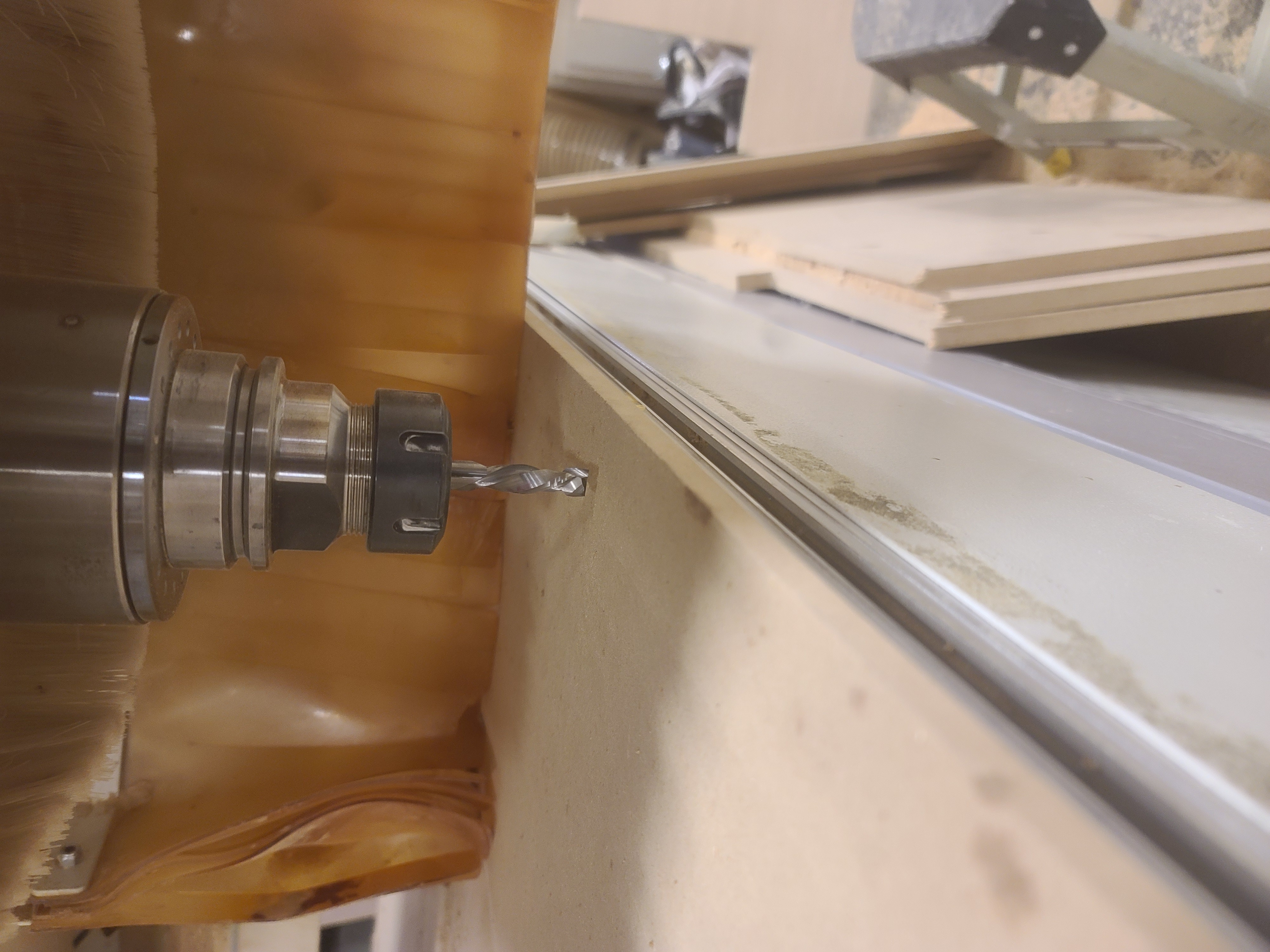

I had thought of a z over travel, but the process required a less than full depth pass and the router is a half inch or so above the table. what is the process to raise the z depth? I have tried to manually turn to raise the height, but it will not budge, and I don't want to damage anything.

A Z depth over travel is the same conclusion we have come to. The weird thing is the Z is actually 5/8 above the table. We have tried to raise it up but because of the braking system we have not been able to find a way to manually raise the spindle up to clear the problem. SCM has not been the best of help in regarding this, so any help would be greatly appreciated!

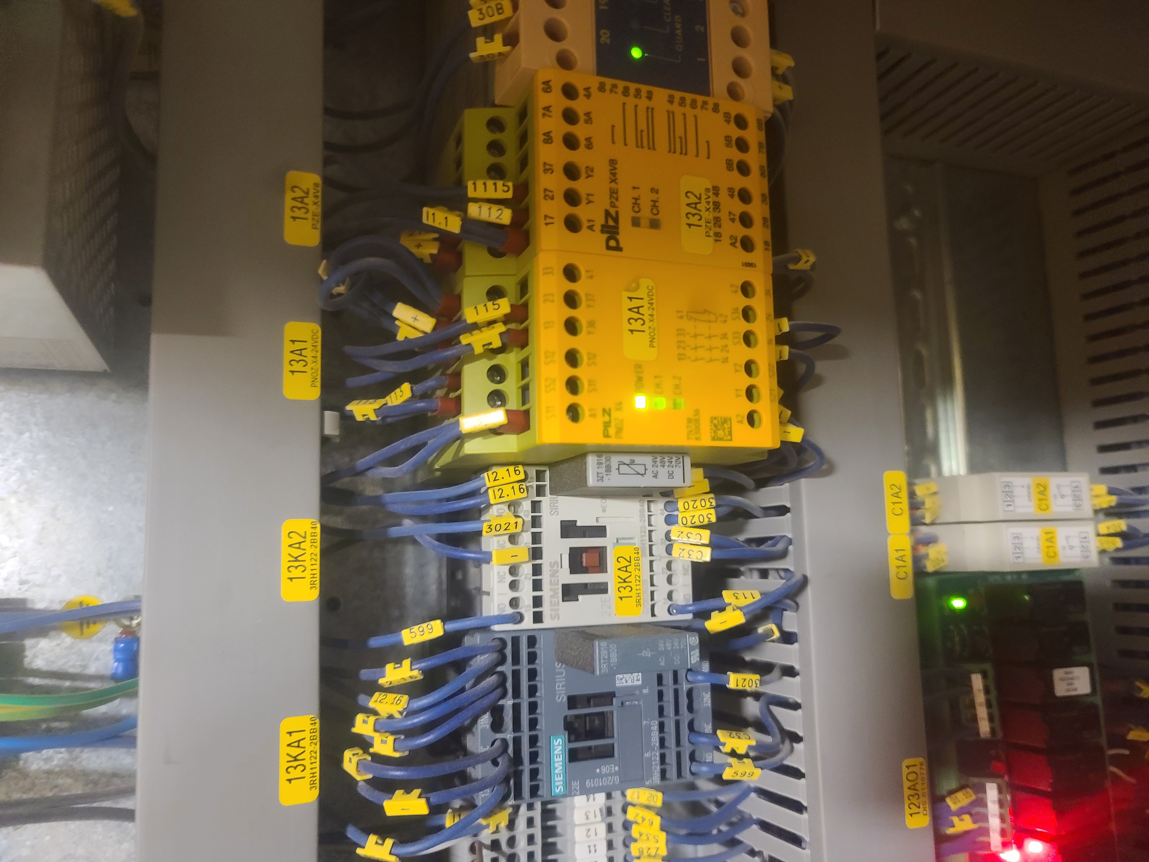

On the back wall of the electrical cabinet you will find 3 LED lights called the XEM. If all 3 are on it is not an over travel switch. If that is the case check the 13A1 PILZ unit, it controls the safety circuit. You must have continuity between wires 111 and 112. If you don't you will have to trace the circuit between those two wires. You will find the circuit on page 10/11 of the electrical diagram.
11/2/23       #18: missing air fault. ...
Shawnn Mcmow
Ok so all three lights are off. just to verify the module is about knee height, 3 LED . some of the wires going in are labeled X04, Y04, and I2.4.

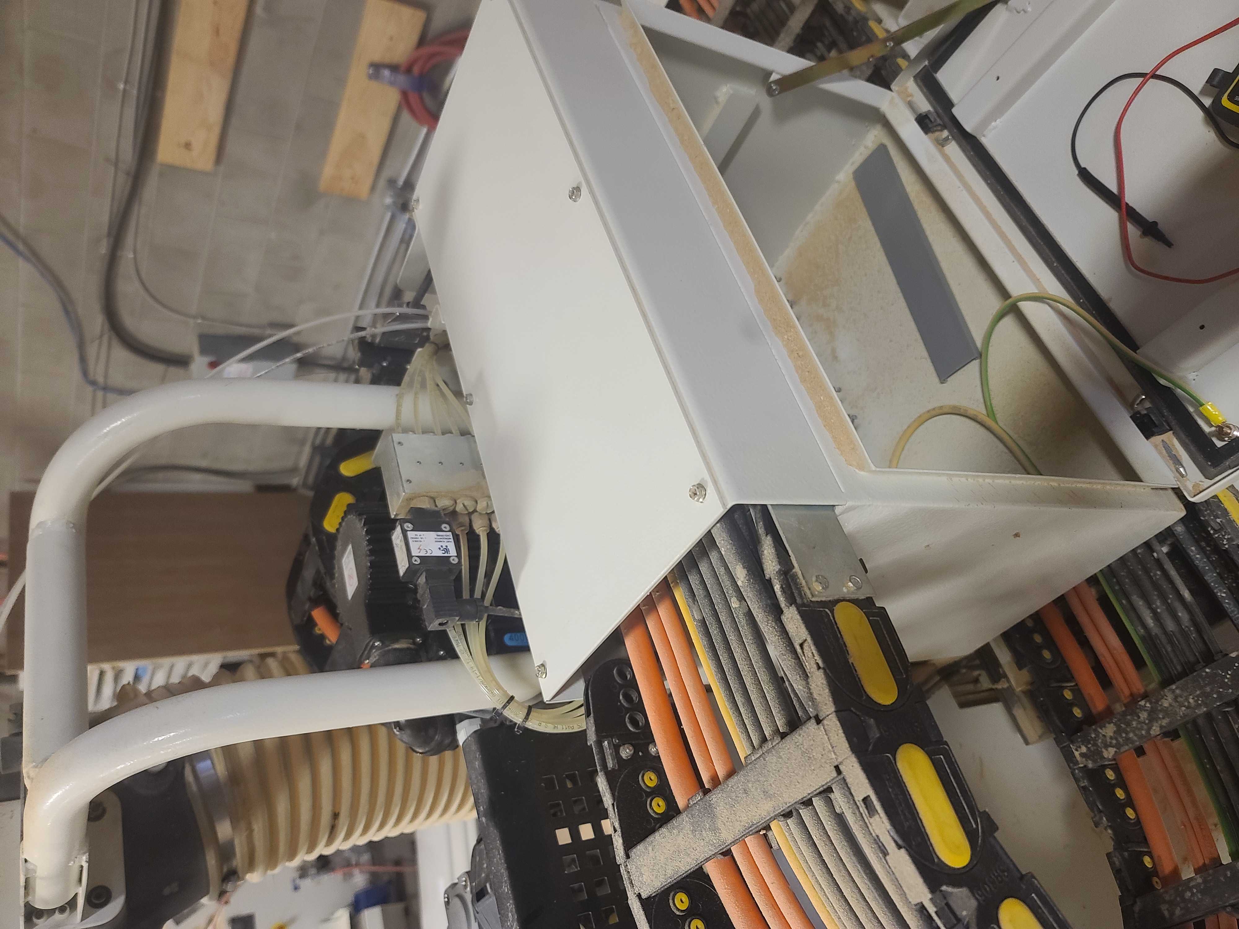

The rake is mounted to the X/Y gantry, so if you push the Y axis head to the front or back you will have room to get to the box. if you do not have power on 304 to ground, the problem is likely the light curtain, if you have it on 304 to ground but not 305 to ground the problem is either the C1A1 or the spindle fans speed sensor.

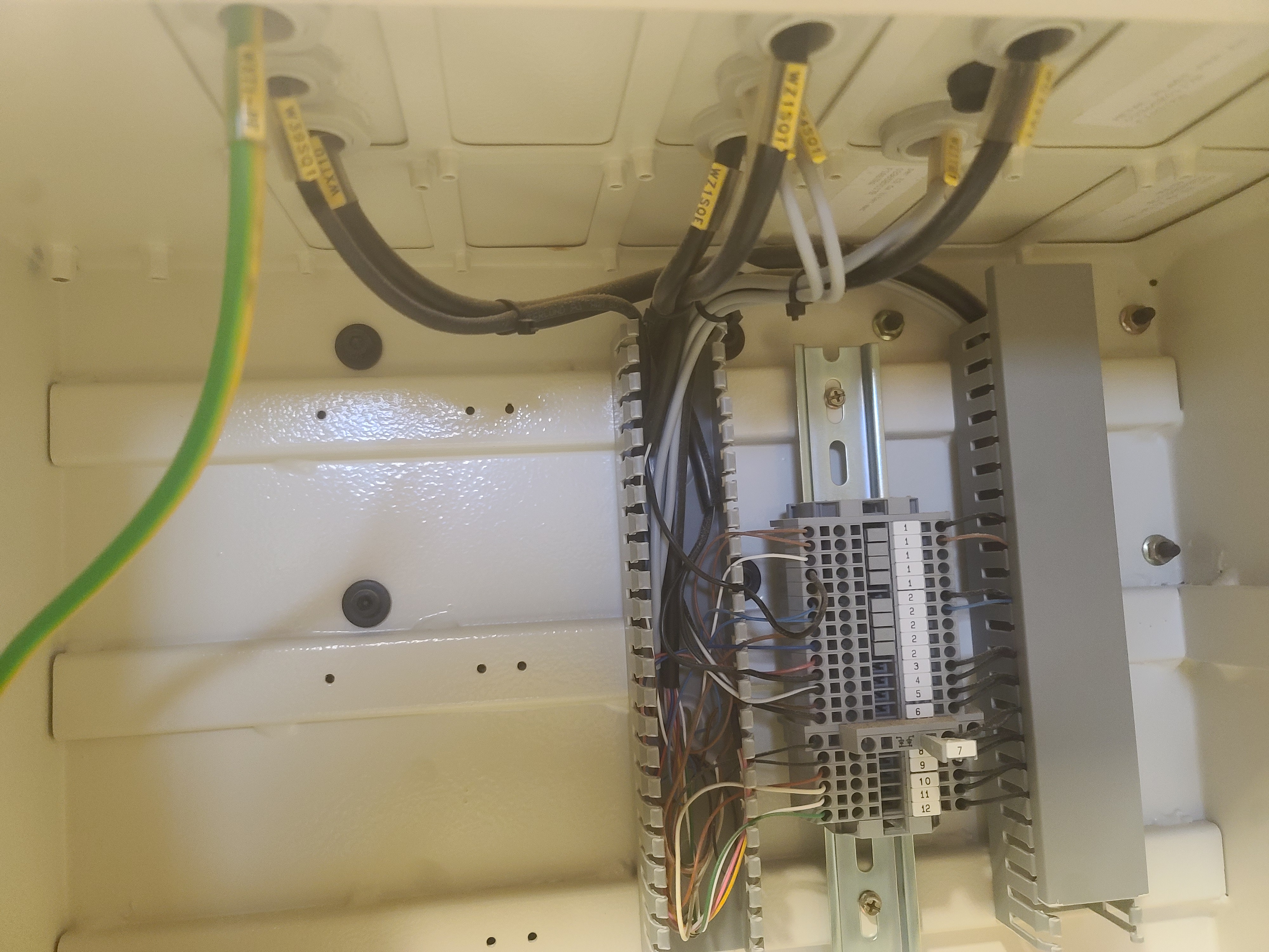

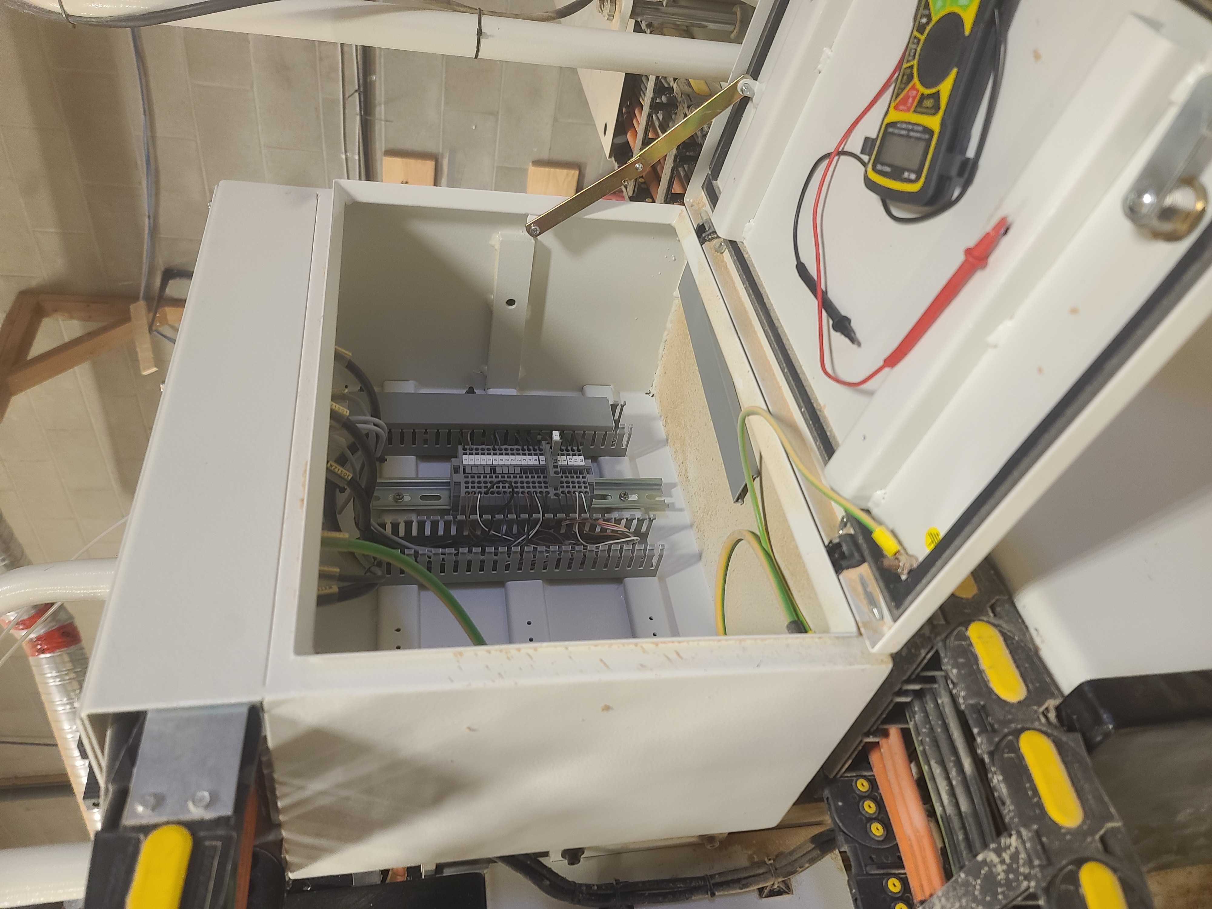

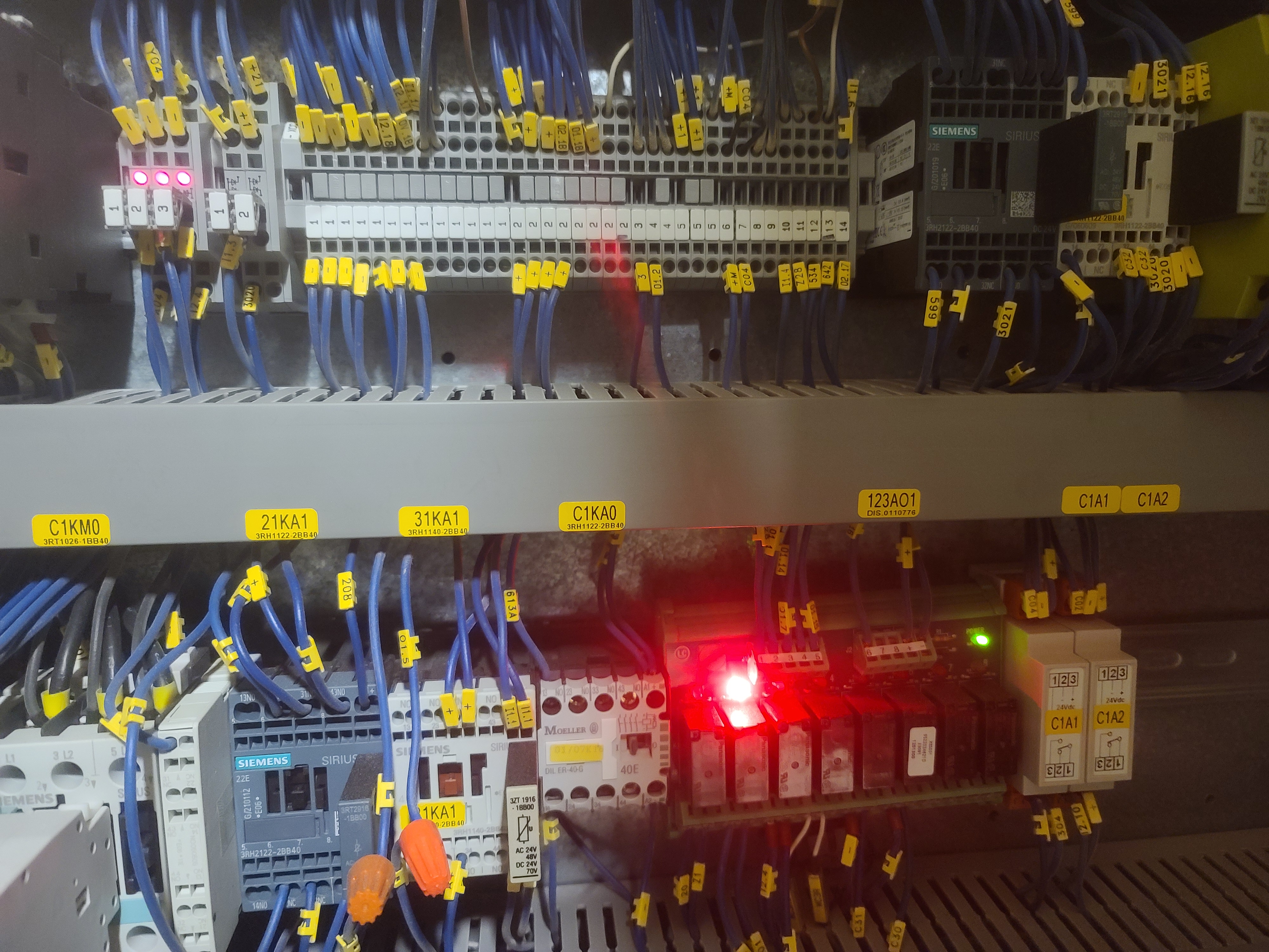

Shawnn Mcmow
So this is what my electric box looks like, I don't see anything labled 304, or 305.
Unless I am in the wrong spot.
11/2/23       #23: missing air fault. ...
Shawnn Mcmow
So after moving the rake over to access the electrical box, and activating the light curtain, I noticed that the 3 led on XEM are now on.

C1A1 must be in the main electrical cabinet. But you don't need to check that because it is working or those LED won light at all. If all 3 are on then you should be able to get power. If you can't get power make sure that both 13KA1 and 13KA2 are turned on and that you have 24vdc to ground on wire 113 of 13KA2

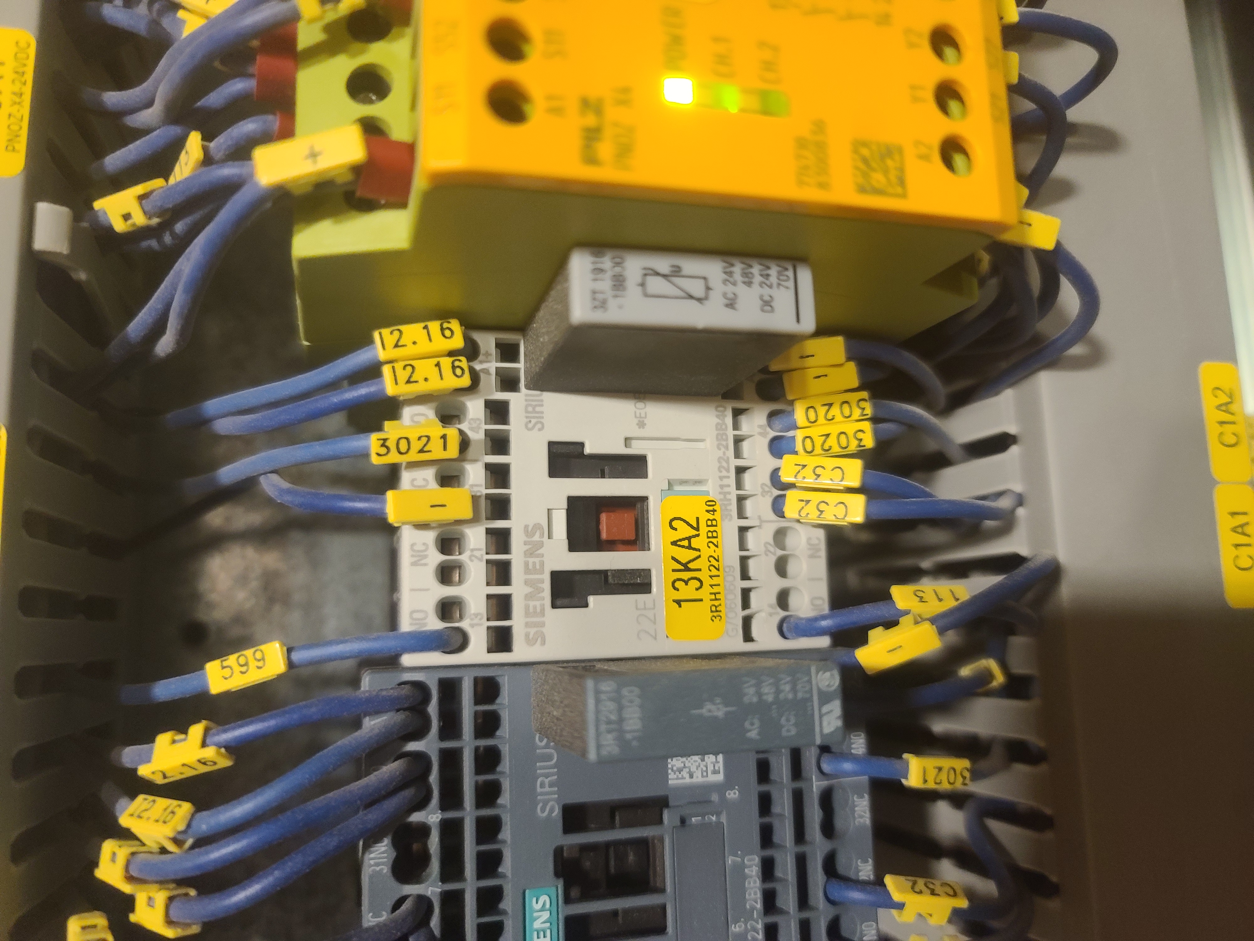

11/3/23       #29: missing air fault. ...
Shawnn Mcmow
Ok I dont have 24vdc on wire 113 to ground on 13KA2
11/3/23       #30: missing air fault. ...
Rob Pierce
Ok, check to see that you have 24vdc to ground on 13KA1 on wire I2.16 which is going to the coil A1 on the relay.
11/3/23       #31: missing air fault. ...
Shawnn Mcmow
So there is 2 wires labeled I2.16 does it matter which one I test?
11/3/23       #32: missing air fault. ...
Rob Pierce
either one will work.
