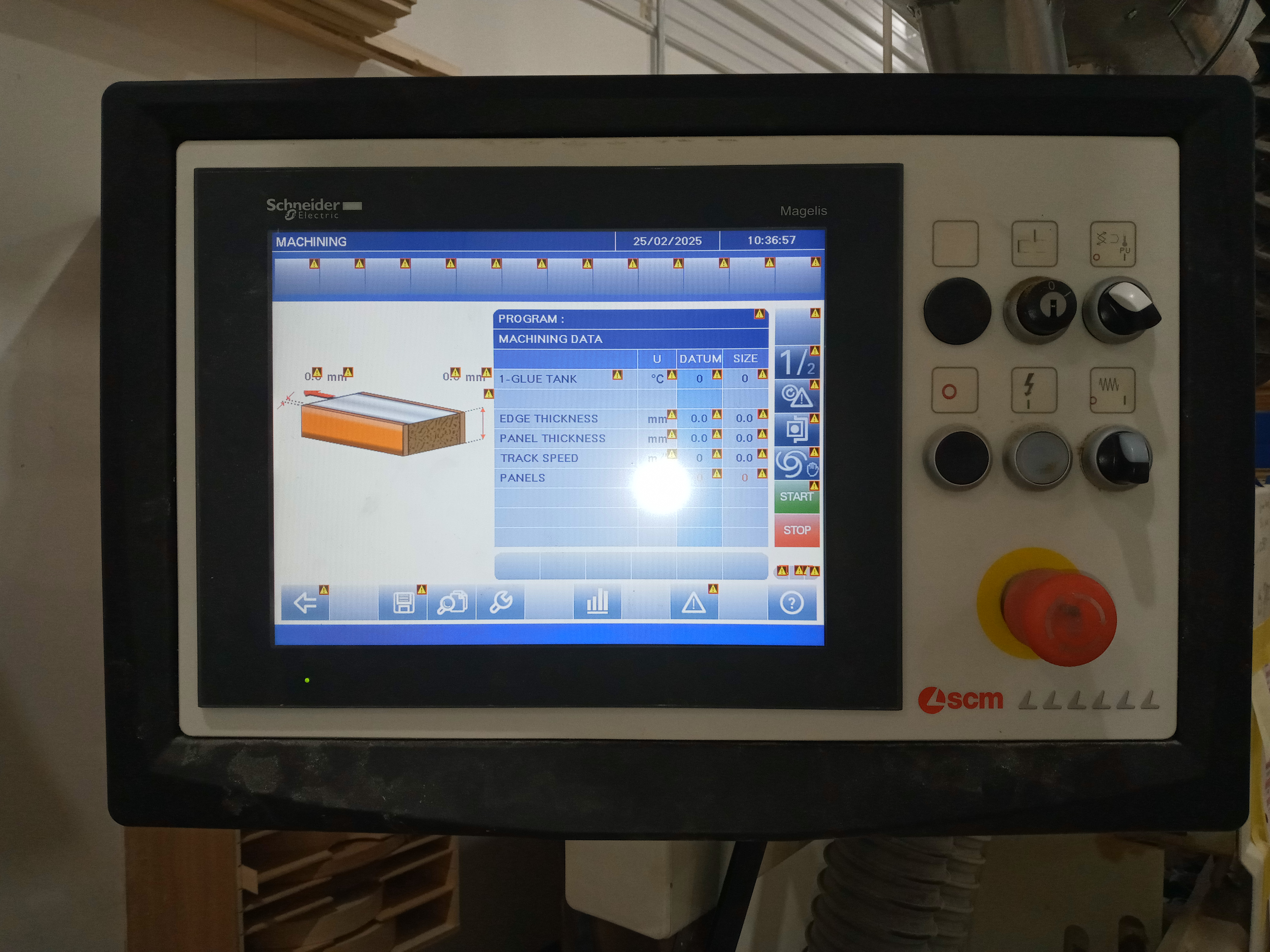

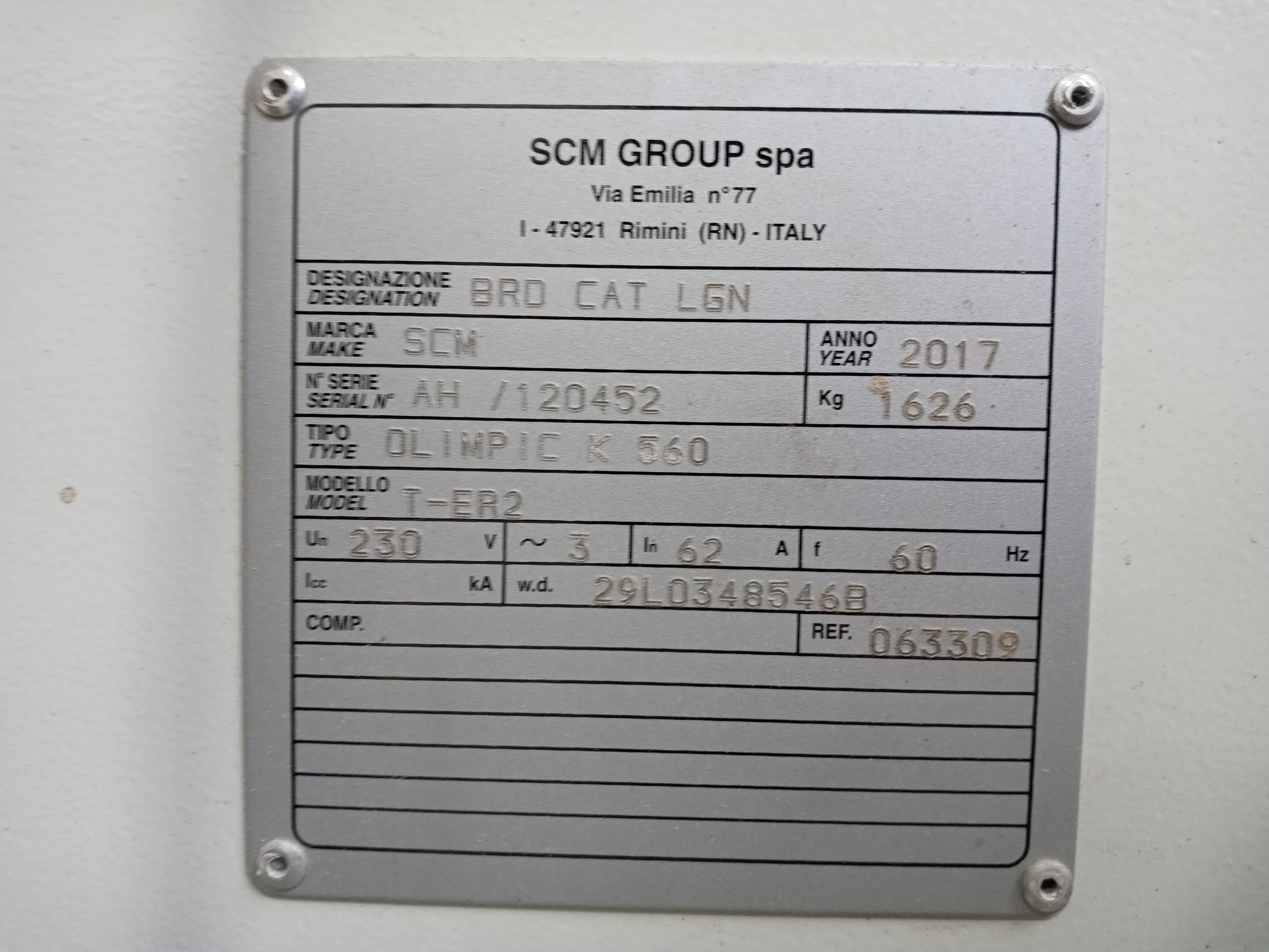

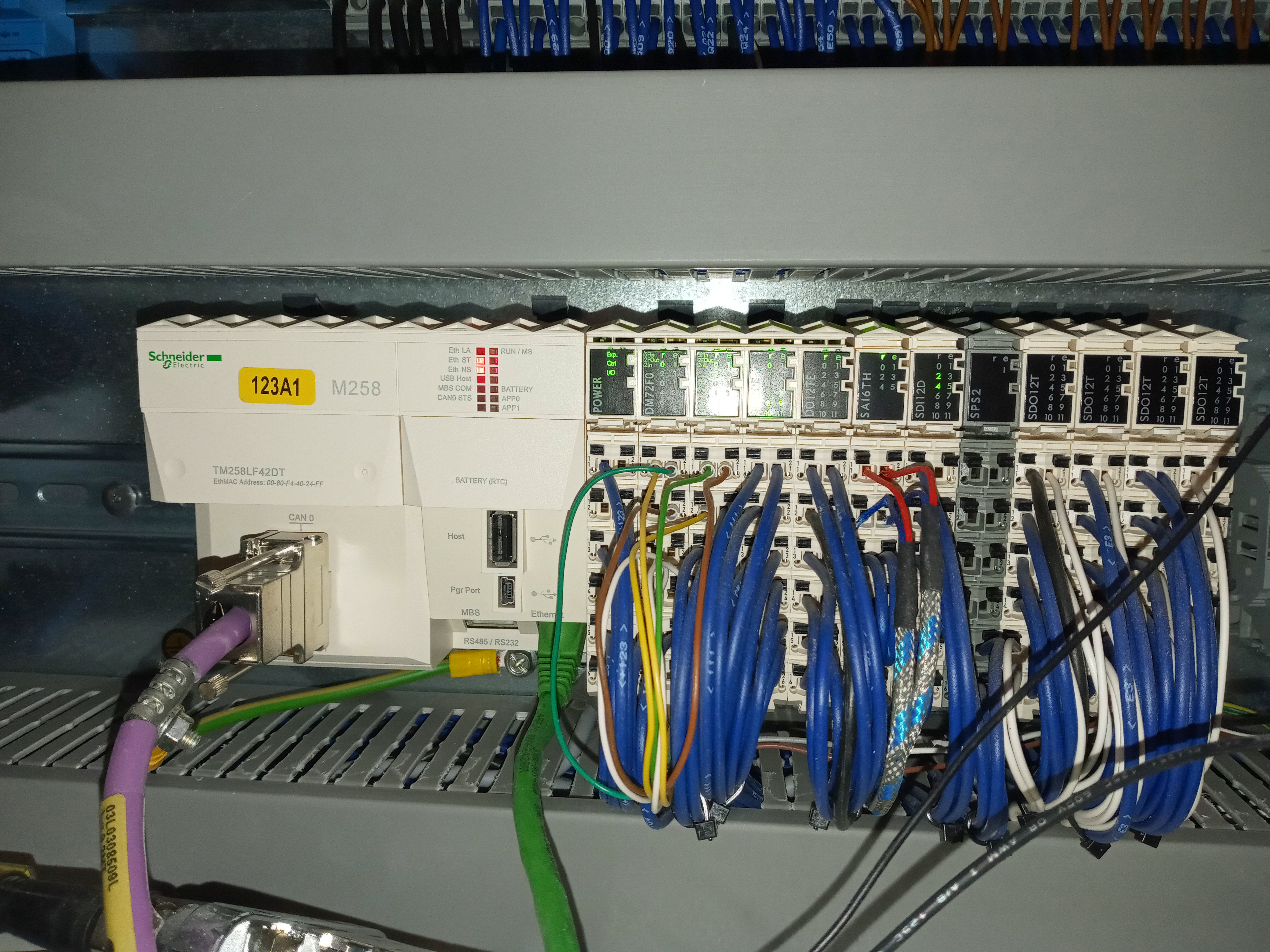

An ideas on how to reprogram a plc on a SCM Olimpic K 560 edgebander,
The error message is saying no connection between PLC and Controller, I checked the connection(ethernet cable) and that is good, the run light does not come on on the PLC
