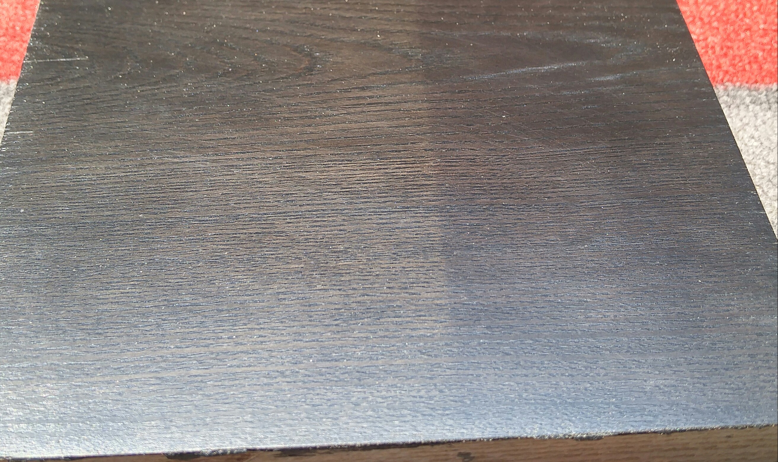

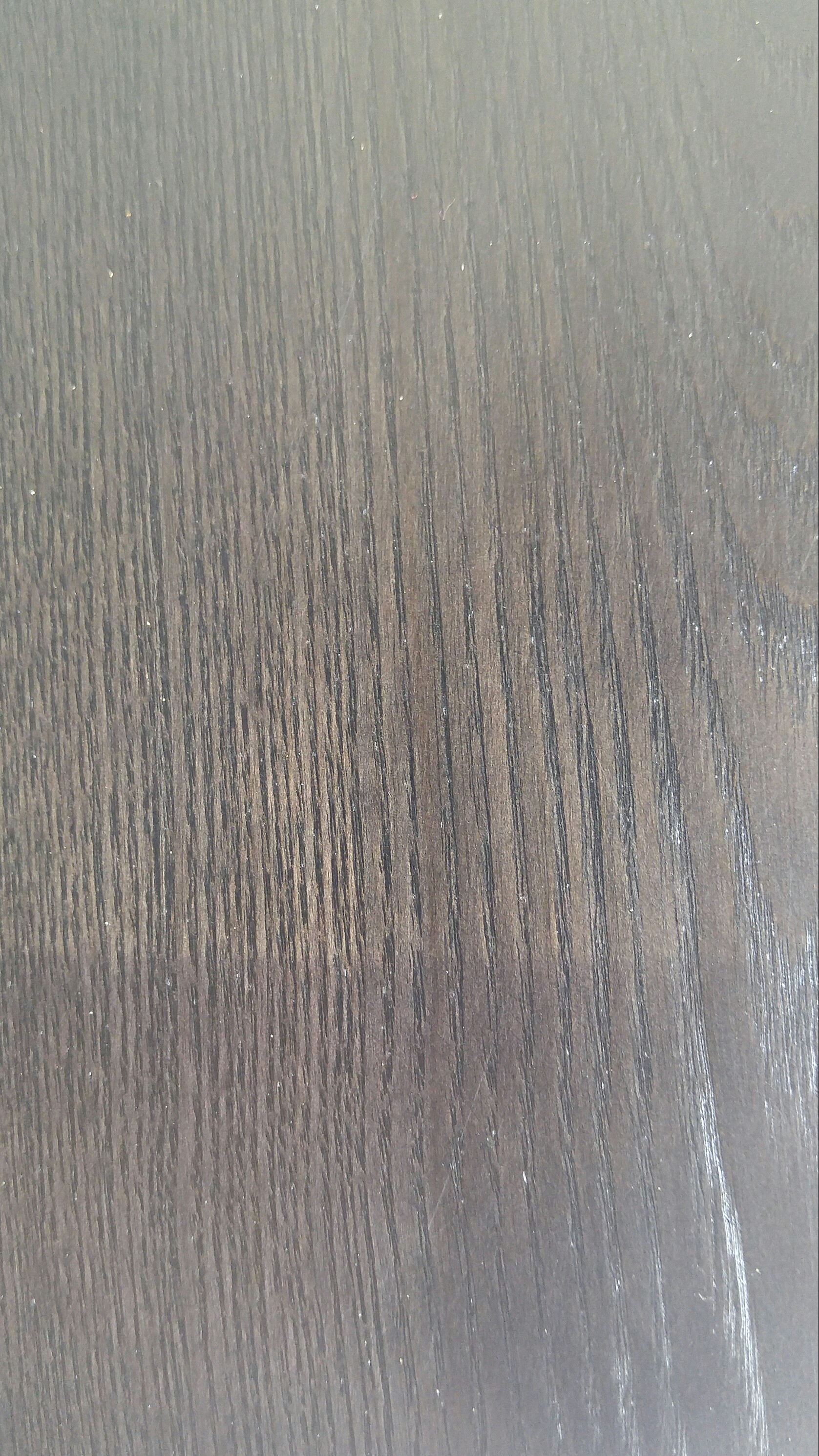

for a refrence I have added a pic of a test piece I made. I have tried different light but cell phone pics arent the best.
Anyways the dark side was died with a VERY light jet black dye.
Then the wood is wiped with a damp cloth to even the dye and open the pore for the wiping stain.
black pigment stain is applied.
the first cv coat has black pigment added
the last 2 have the same jet black dye added to them.
applying the dye darker make the wood more black and less of its natural color wich is a good thing but it also darken the wood to the point where the grain isnt showing anymore. especially after applying the wiping stain.
This has led me to thinks about using light dye colors such as yellow, light brown etc. as mentionned previously. in order to give me a uniform light base color. Do you guy have experience is thia kind of combination?
It seems like I have no problem staining colors that are brown tones but black always seems to give me problem except maybe on white and yellow birch.

Stop wiping it with a wet cloth would be my first suggestion. Flood the surface with dye, then very lightly wipe with a dry cloth. Wiping with a wet cloth will absolutely change the color.
6/20/20       #7: Dye Color Before black ...
Also try lightly wiping down the first coat of dye with a cloth, and then spray a second coat and don't touch it.
6/20/20       #8: Dye Color Before black ...
pascal stgelais
i know the wet cloth make the pigment stain darken but its on purpose since I tried staining with wiping stain after filling with timbermate and sanding to 150 grit and the stain act like if the wood was sealed( it was wiped off completly). Even with fresh sandpaper ash did not take the stain unless it was water based(day night difference).
As for dye I spray them what you would call dry. I am willing to try you spraying method wich is flooding the surface but wont I go back to square one (the dye making my wood almost black opaque)?

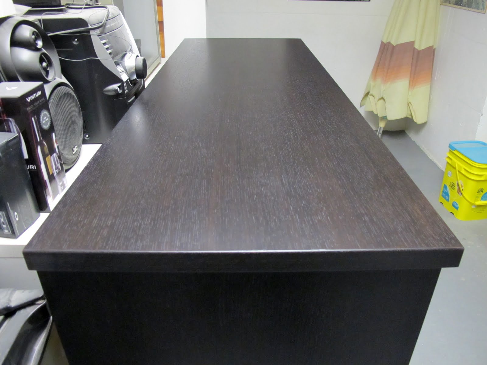

I did this white oak with Sherwin Williams BAC Wiping Stain, one of their stock colors that we then tinted several times to get the color I wanted. If this is close to what you are after its a pretty easy process. BAC Wiping Stain has both dyes and pigment in it. It's often used over a base dye, as you suggested, but it can be applied directly to raw wood, too, as I did.

6/21/20       #10: Dye Color Before black ...
John Member
OK, let's try the picture again

6/21/20       #12: Dye Color Before black ...
Pascal
Now john this is a great job.
on the dye base when you do a black job like this does your dye is necessarily black also or do you often use a lighter color before going for the black stain?
6/21/20       #13: Dye Color Before black ...
John Member
Not sure I understand your question, Pascal.
The BAC Wiping Stain I used was a mix of Midnight Black plus a custom blend, to which I added some dark walnut and red dye. It was really dark, but not black. I can look up the exact recipe from my project notes if you want.
The panels were sanded to about 150 grit, vacuumed off, and then I brushed the dust out of the grain with a brass brush, and then vacuumed again. I found this to be really important to preserve the rift sawn grain definition.
I applied the stain with a foam brush and wiped it off as soon as I had the panel coated.
John .

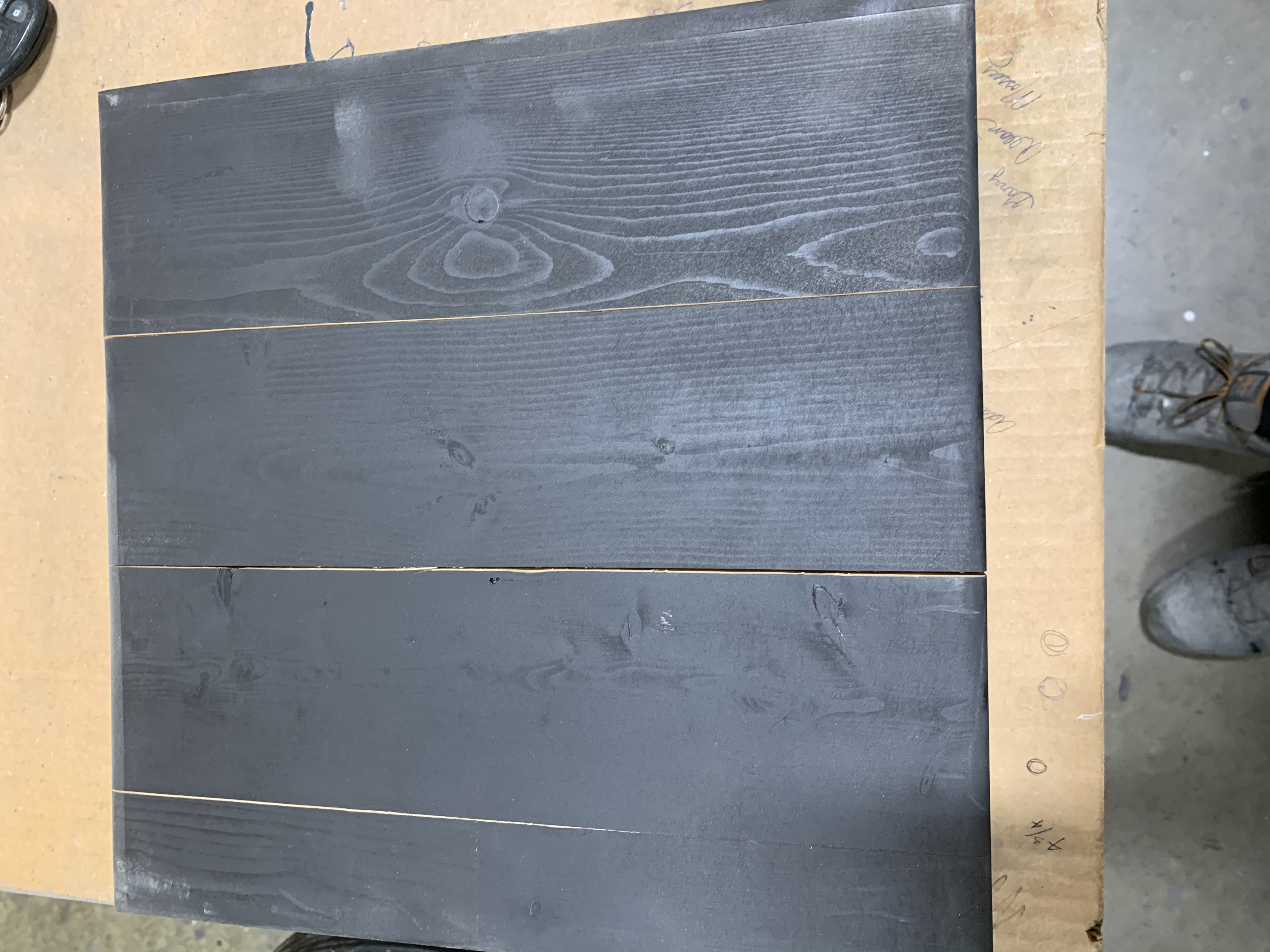

8/26/20       #16: Dye Color Before black ...
Gary Member
Are you looking for something like this?
8/27/20       #17: Dye Color Before black ...
Pascal
well this is certainly a nice black that would satisfy me
