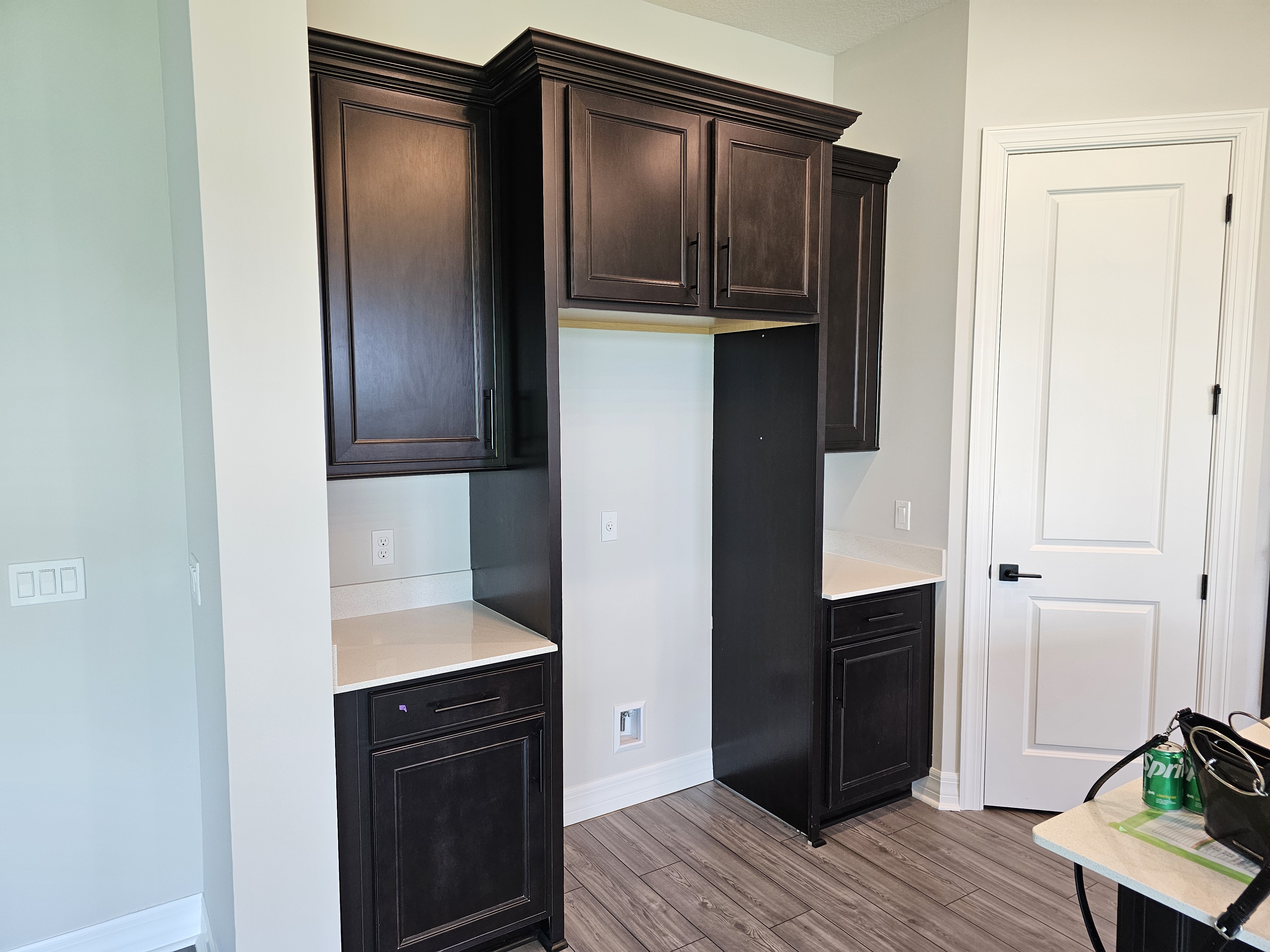

We currently have Aristokraft Sarsaparilla cabinets (dark brown) and are hoping to get new cabinet doors while resurfacing/painting the boxes to achieve a milky, lighter green look (reference photo attached). In our household, being toxin-free is very important, and we came across Chemcraft AQUASET (initially, we considered The Real Milk Paint, but we were told it wouldn’t achieve the look we desire and would not adhere.) However, some have suggested that AQUASET paint yellows over time, chips easily, lacks durability, and may not guarantee a long-lasting finish. Any thoughts or suggestions on other options?
