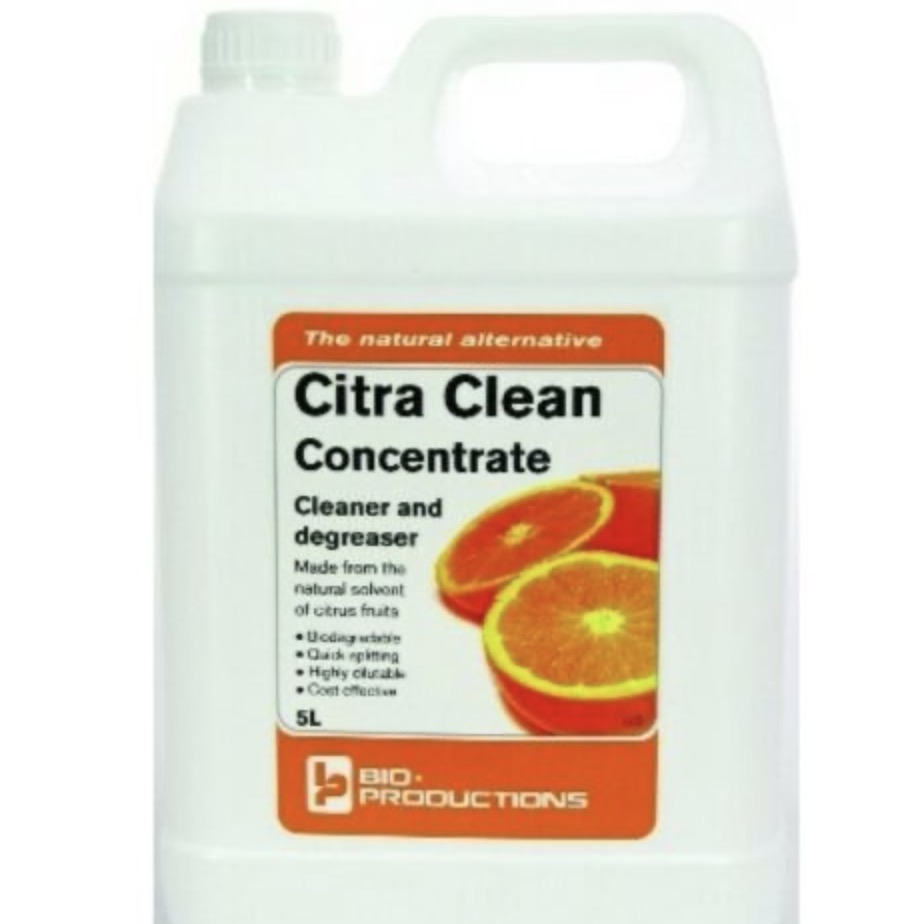

I have been using Citra Clean concentrate degreaser. It comes in 1 gallon containers and priced about $35. We use a 15-1 solution pumped through the pump, hose and gun.
Inspected pump and is super clean. I also use this solution in our Crest ultrasonic cleaner, really makes spray gun cleaning easier
