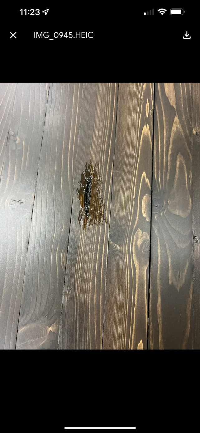

I just finished doing a pine project. and now 2 weeks later sap is coming through to the surface and laying on top of the finish. I use SW Sayerlack as my finish, I have tried a few different cleaners that removed the sap but buffed a shine into the topcoat wiping it up. Is there anything out there that would remove the sap with out changing the sheen?

You can try Naphtha
It shouldn't mess with the finish
As always try a small area first
1/10/22       #3: Sap ...
If the sap was not set in that wood with heat in a kiln, you're going to have to remove it from the pocket and try to get a permanent filler over it. Removal with a solvent will not keep the sap from seeping out when the home gets warm in the future.
